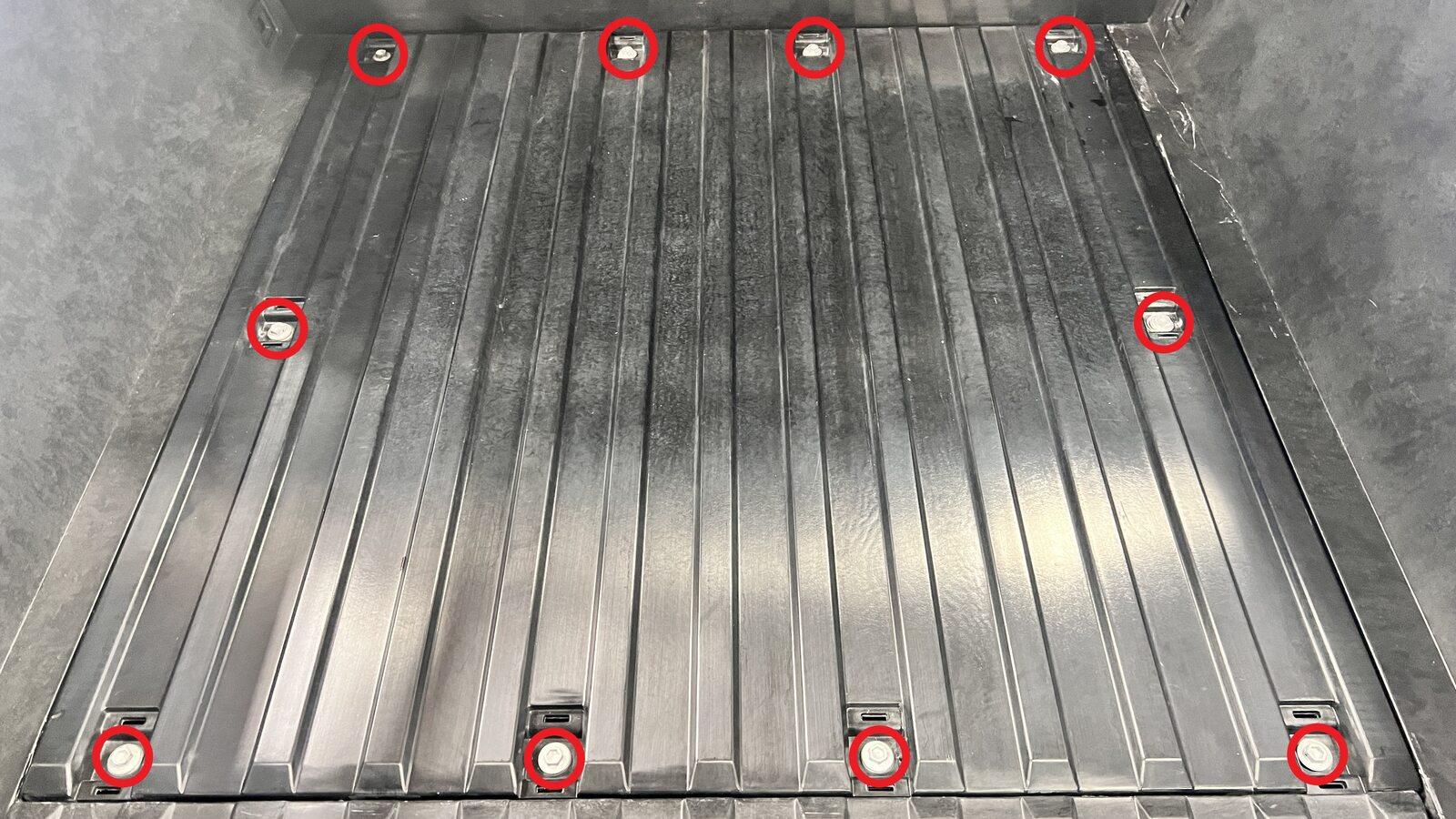

Should be as easy as six bolts to take out the bed floor. Grab the iPad and put the bed floor back in place 10 minutes tops

it's already been done. it is 10 bolts, 6 long, 4 shorter. 4 shorter go in front of bed near tonneau cover well. and the rest middle/back towards tailgate. If you put a long bolt towards well, it will cause tonneau to stop early and not fully open. found out the hard way.

One item of warning. The bolts for bed floor are not equal length. The four bolts towards the front/ cab/“tonneau well” are shorter than the rest. Super important to know. I put a long bolt in front and it actually stopped/interfered with the tonneau cover from fully opening.
The long bolts are about 5.5cm and the shorter ones about 4.5cm.
the bolts have a 15mm head and the thread is 10x1.5 (metric all around).
10 total bolts, 6 long and 4 shorter.

Wow, the bolt-length issue is not even mentioned in the Service Manual procedure!
It's not, and I was not happy about that. these pictures and documentation are pretty old, as from what I can tell, they don't even have the 2x20amp and 1x40amp (240v) plugs shown in any pictures, on the left rear wall.
that's why it's super important to realize the shorter bolts go at the front/top holes and long bolts go in middle and rear (tailgate) side.

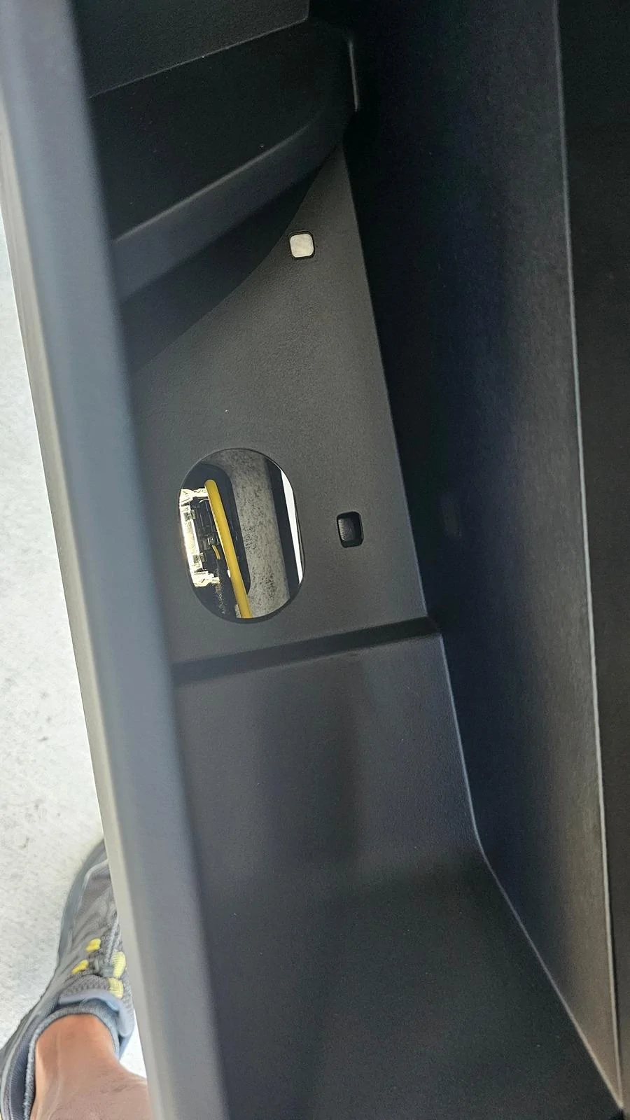

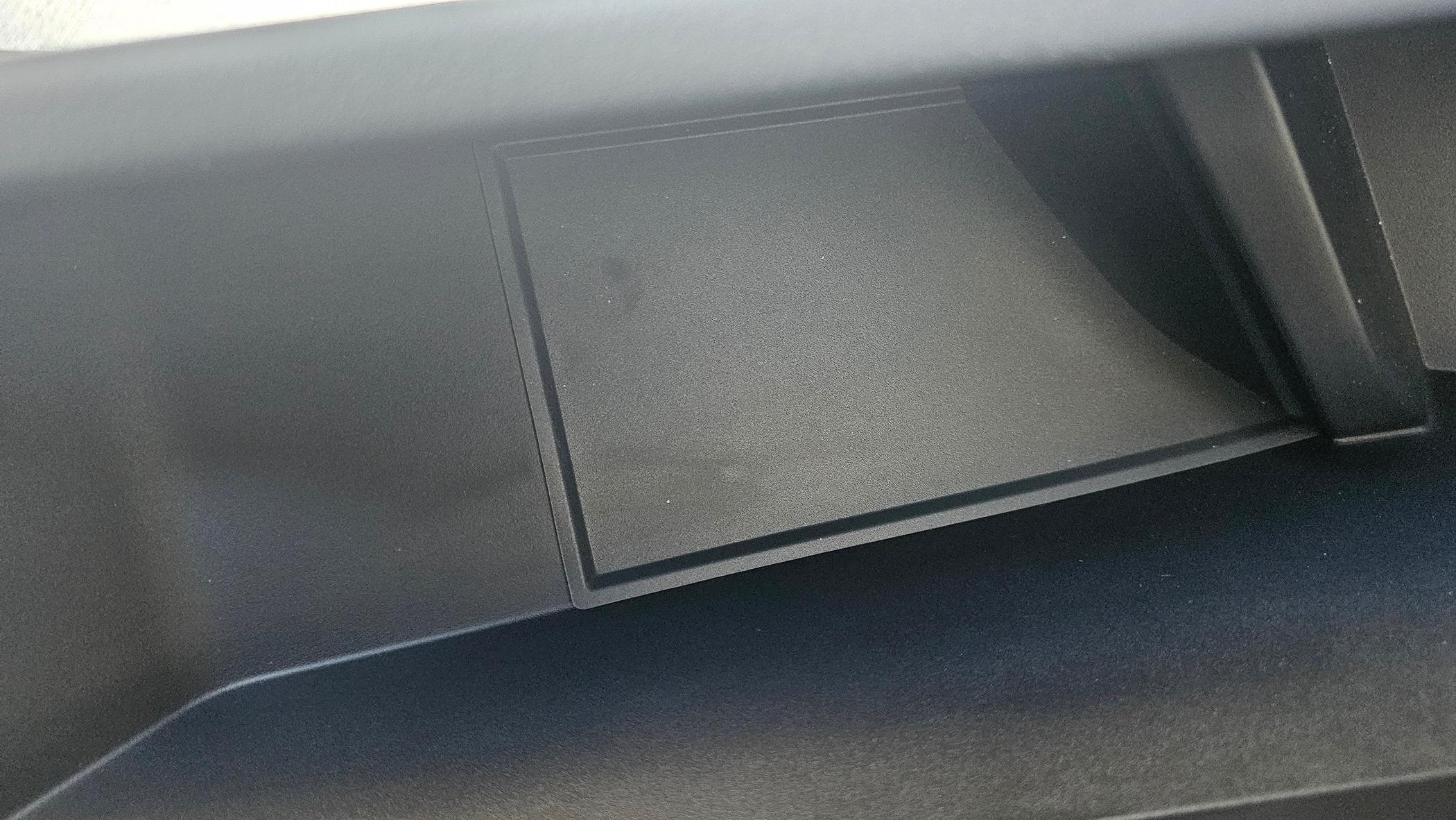

Has anyone discovered this Easter egg yet. On each rear door shelf, there is a piece of rubber liner, remove it and their is an :sneaky:...
Tesla Cybertruck Kid dropped iPad down tonneau cover slit. 20240512_174902
Tesla Cybertruck Kid dropped iPad down tonneau cover slit. 20240512_174850

Long story short, the phone was alive for a day, so drove a car around with no lock. At least PIN to drive is a thing. I bought a breaker bar, torque wrench, followed the instructions to remove the bed cover and my wife (who loves McGyver) proceeds to hop into the back with the tonneau closed, puts one leg on either side and reaches her hand in the little gap and using a pair of forceps plucks out the iPhone. Miraculously unharmed.
