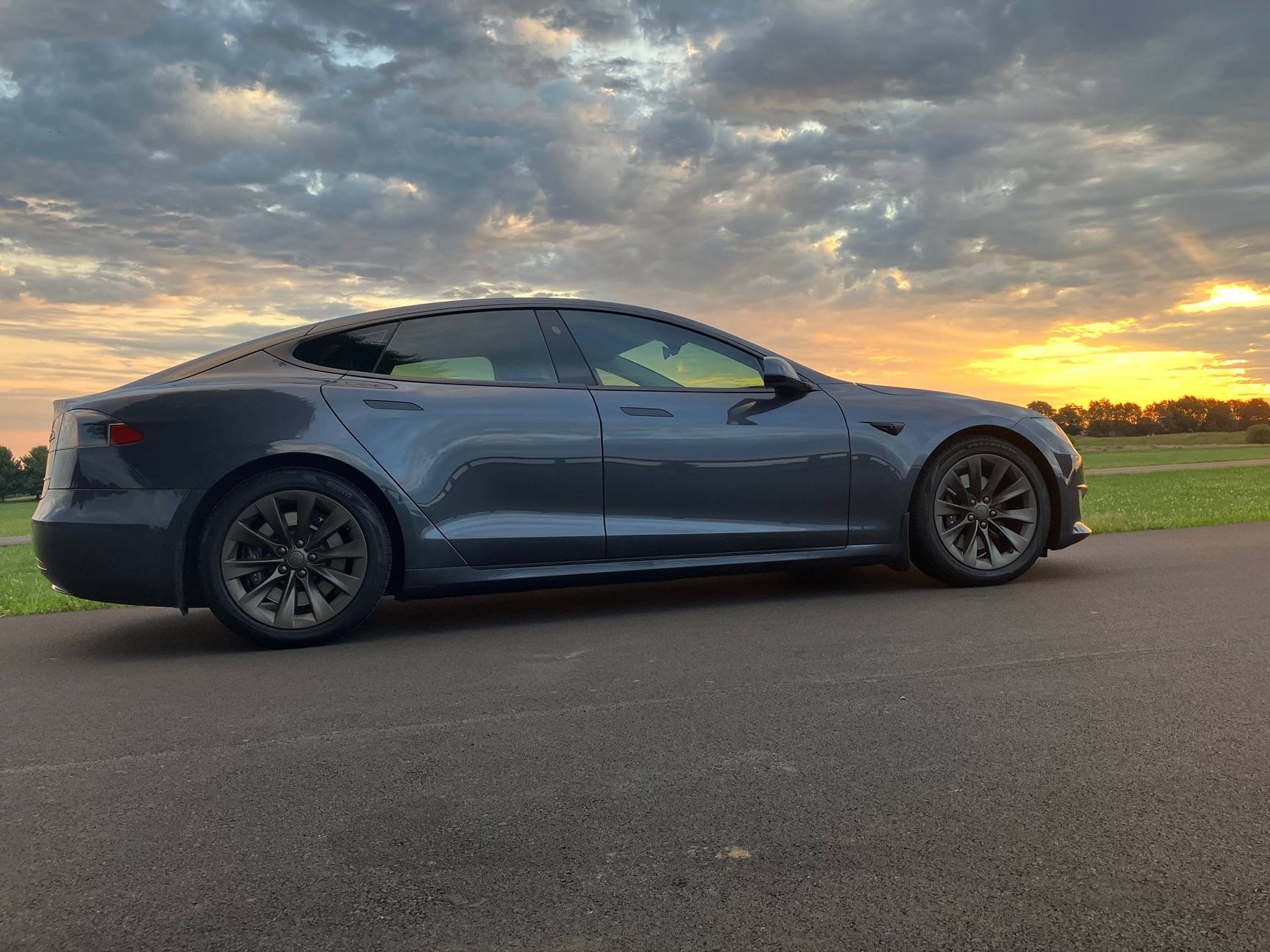

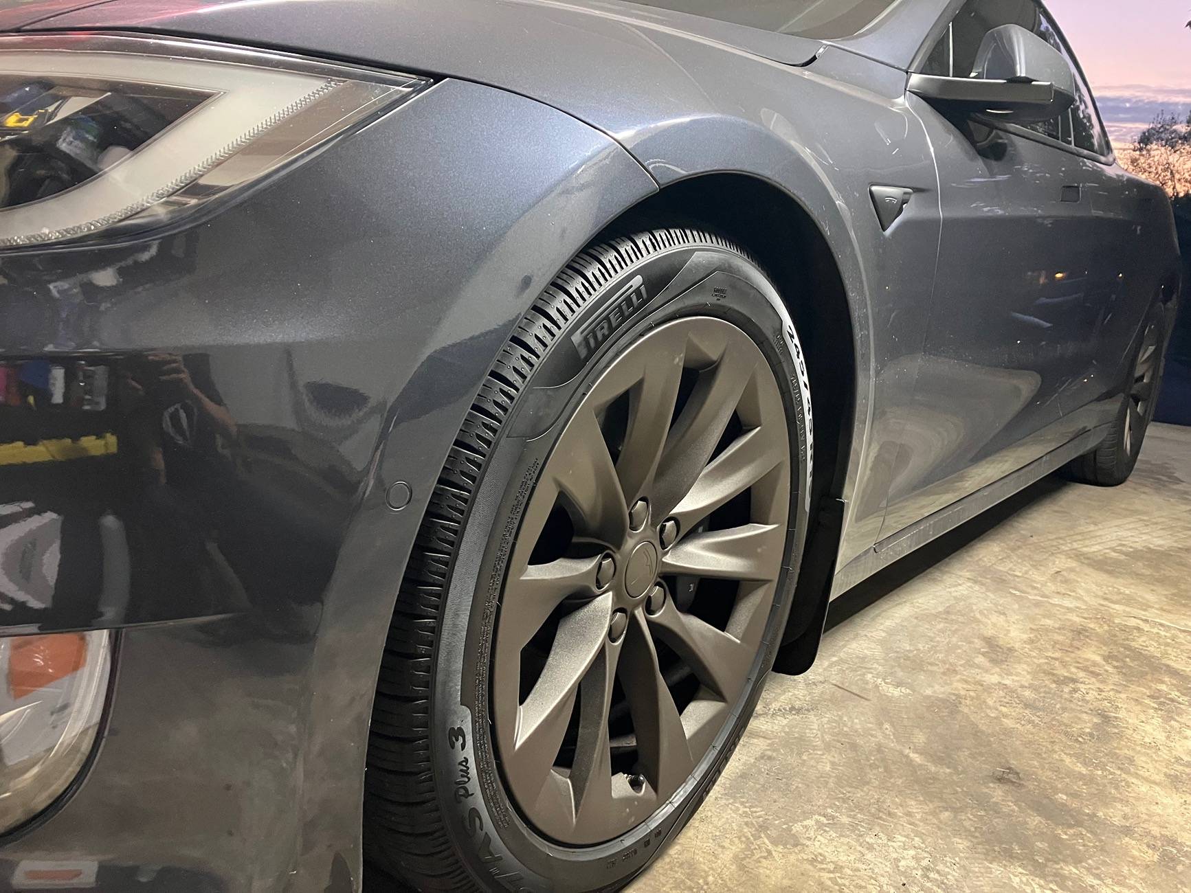

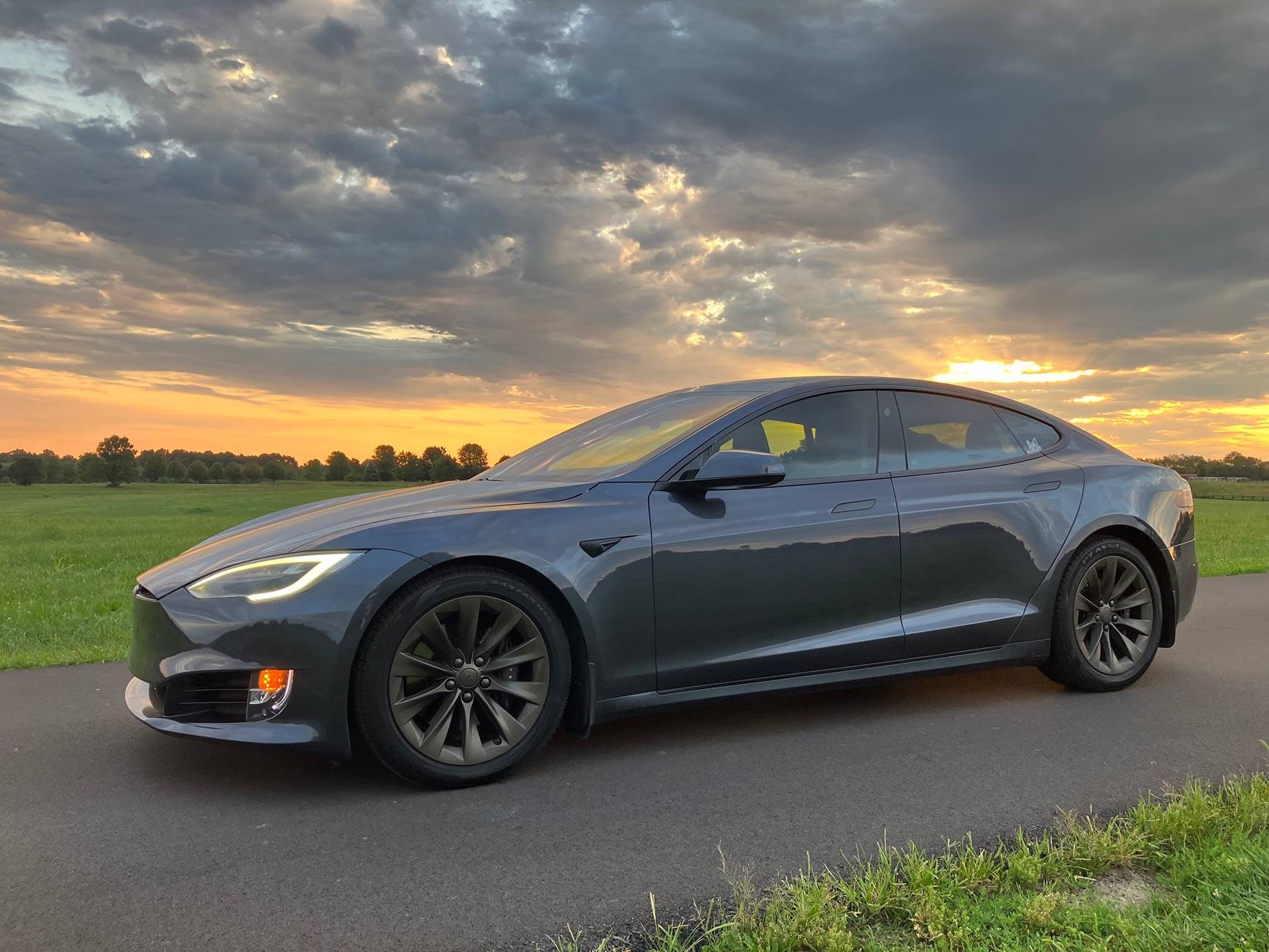

Never used plastidip. How well does it hold up? Is it easy to scuff or put marks in them? I know they’re meant to be non-permanent right?
I’ve plastidipped the wheels on my S and they hold up very well!

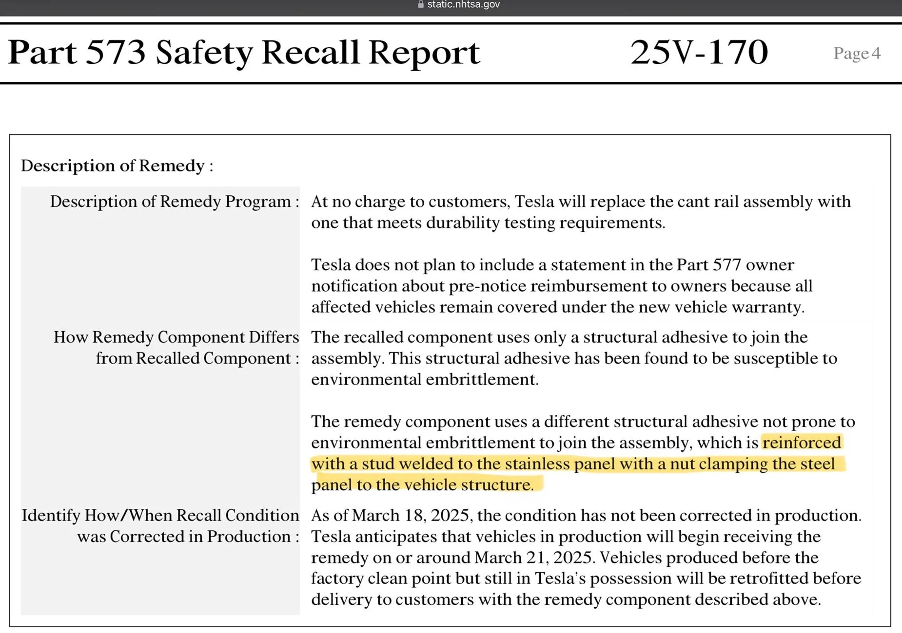

I hadn't considered that, are they regluing them or replacing them?

AFAIK, they are replacing the entire cantrail piece with one that ‘bolts’ into the truck.
So it will be a new piece.
Yeah, per the recall paperwork, the new one has the front stud welded to the stainless instead of the carrier brackets.

That is correct.
