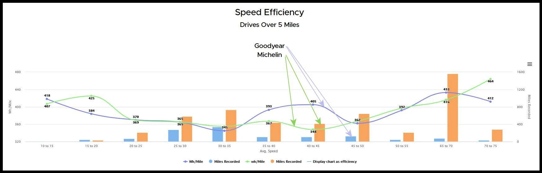

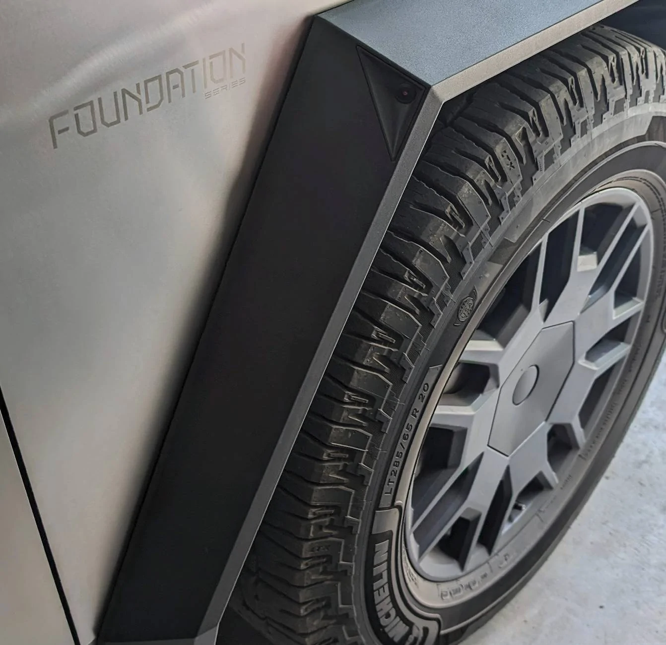

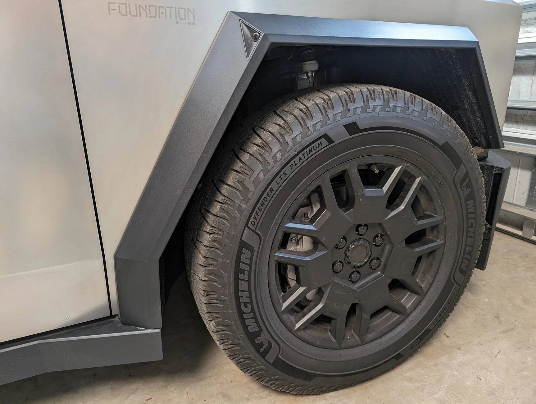

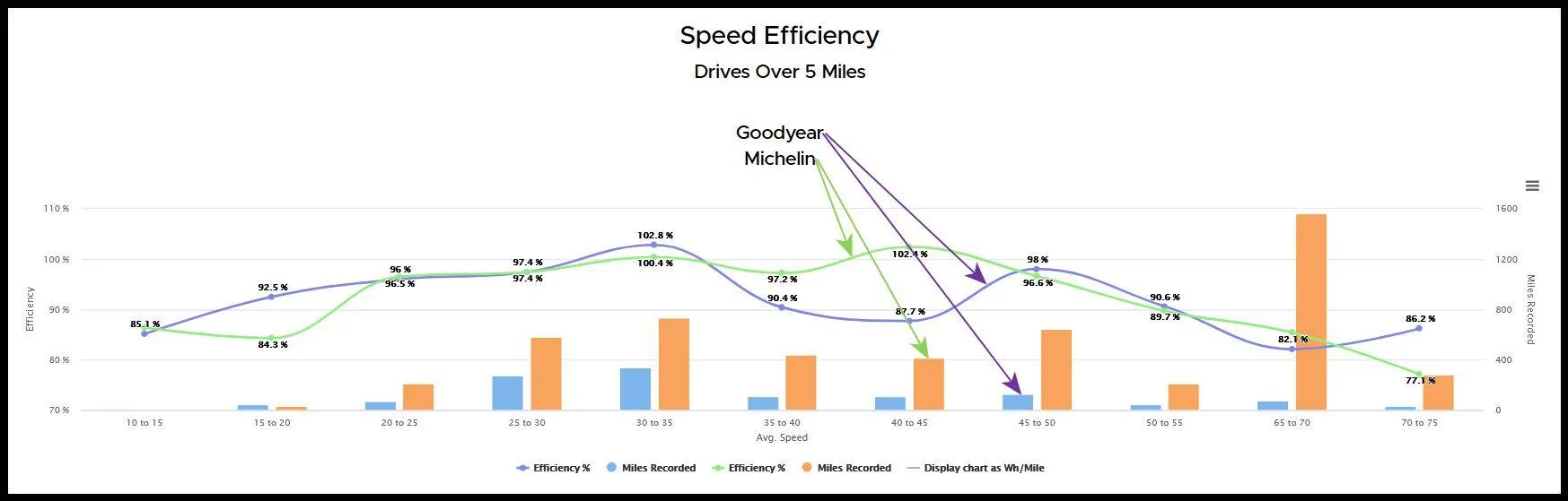

I'm in Florida with the Michelin Defender LTX Platinums with about 6.3k miles including a round trip between FL and VT over the summer. They replaced my OEM Goodyears at about 1.8k.
I don't have official sound meter data to compare but both my wife and I feel that the Defenders are both quieter and smoother than the OEMs.
Based on my observations when new, the height of the tires were the same and the profiles very similar.
When new, the Defenders had about 14/32 tread. They currently average about 12.5/32. Frankly I don't know if that's great or bad.
Oddly, the efficiency seems to be an inconsistent factor of speed. The following charts via TeslaFi represent %efficiency and Wh/mile efficiency.
Would be interested in any new data now that you've had the Michelin Defender LTX Platinum's for a bit. More efficient overall than the AT's? Thanks!
The numbers I posted previously seem to be pretty consistent.
