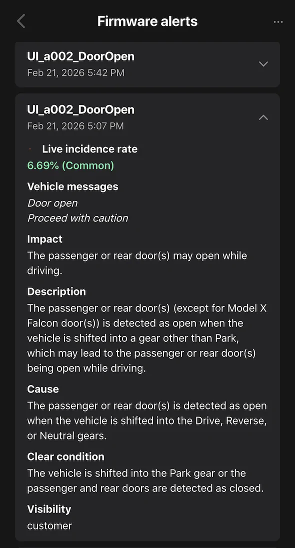

Does anyone know if these failures are reported in the Tessie app? I looked a bit but didn’t find much.

If you tap the bell icon on the upper-right corner, you can view the "Firmware Alerts" (which includes any Service Alerts). Each alert includes a full description, and a "incident rate" based on Tessie user data.

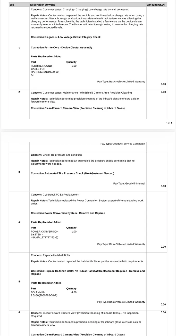

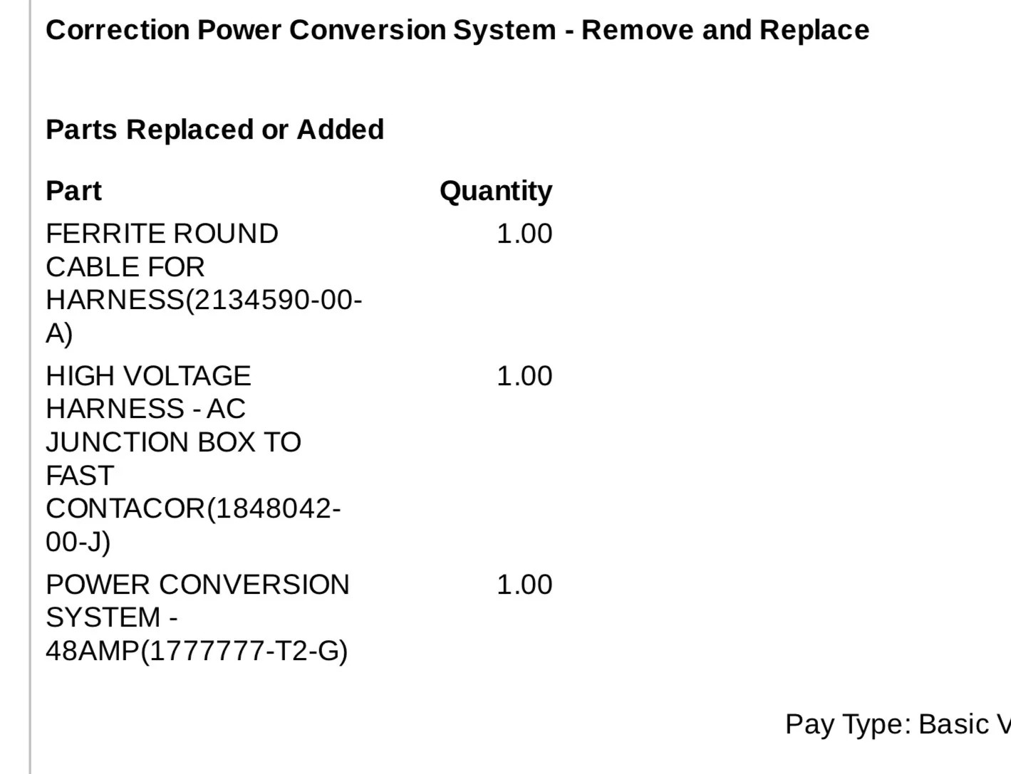

Depends. Mine went to 24/24 and would supercharge. It worked fine for over a week, but did start to give me some ā€˜charging stopped’ alerts. Mine is at the SC today getting replaced.
Some have been at 24/24 for months apparently (they didn’t realize there was a problem with the PCS).

Mine was FS AWD, May 24 delivery, 33k miles.
My SC got it done in one day.
yeah I’ve been there. Nothing showing up.

I saw a report of that in another thread. I think the first time got a -E version and second time a -G.

Truck went in early this morning. Ready to go at lunchtime. Awesome work by Tesla service. šŸ‘šŸ»
