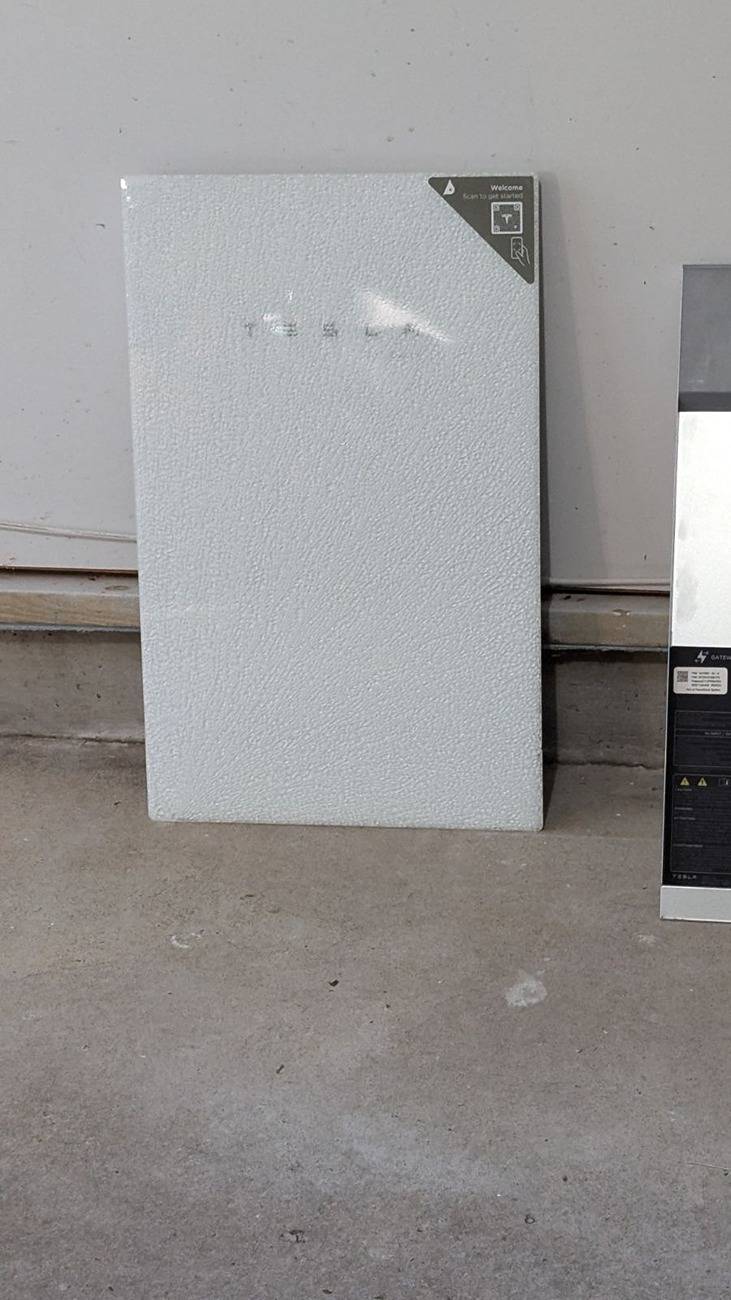

My electrician gave us the new pebbled-look electrical panel door today.
Tesla Cybertruck Powershare update from Tesla (10/16/24): activation wait period, Powerwall, solar, backup switch Powershare Door Shatter
I couldn't make the Spoiler button work... So, scroll down a bit.
He set the door on the ground and it shattered. Luckily, he had a spare in his truck. Sorry, next customer...
