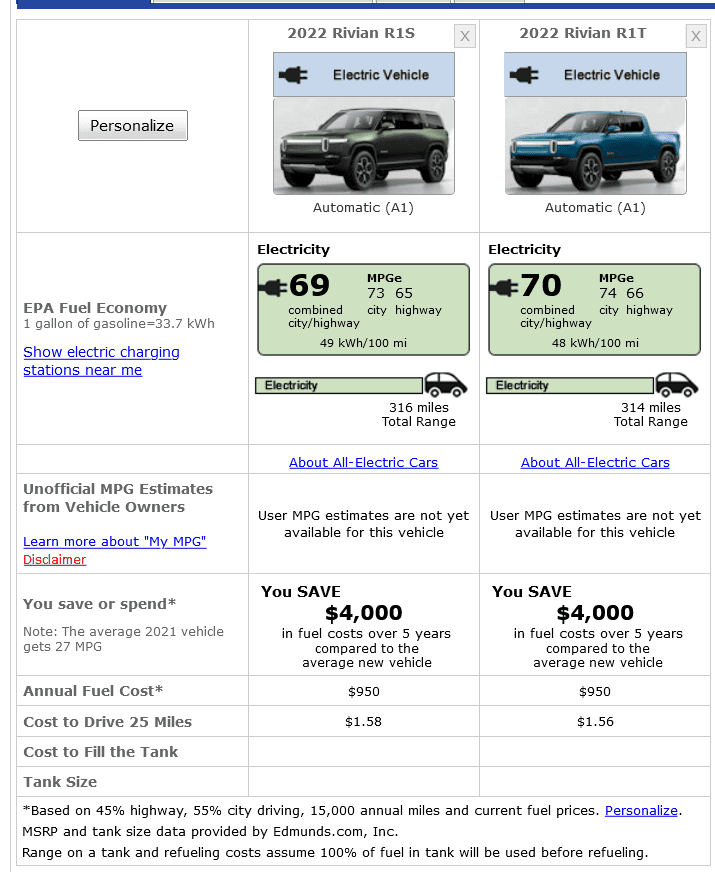

This is a number to beat for CT and with better aerodynamics it should be doable:
Tesla Cybertruck MPGe help & predictions 1630886713434

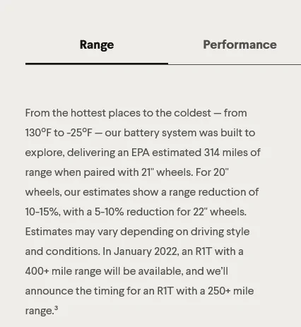

note the impact of wheel and tire choice. 21” has road tires.
Tesla Cybertruck MPGe help & predictions 1630886853532
