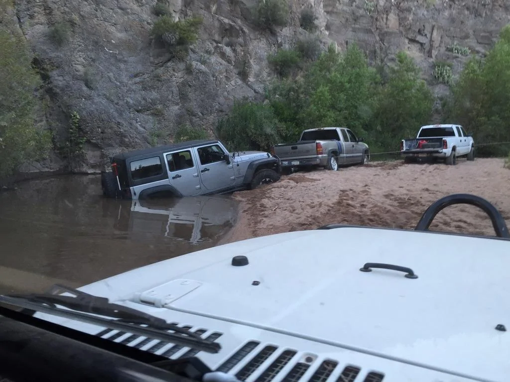

Super light pull, might have done it by hand.
Tesla Cybertruck Winch - What is the priority? 1657227309578

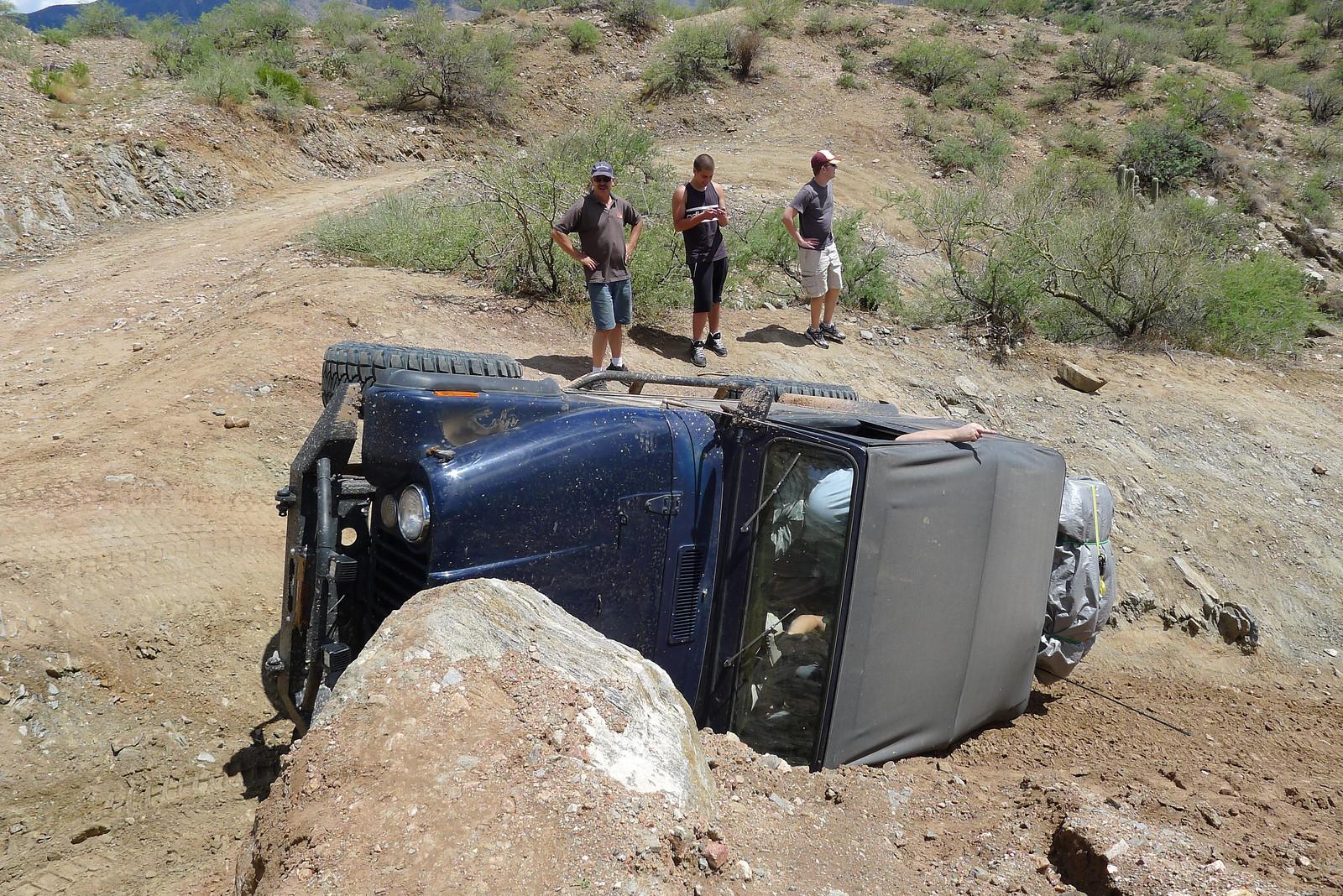

Heavy-ish, but short pull, easier than it looks.
Tesla Cybertruck Winch - What is the priority? 1657227465465

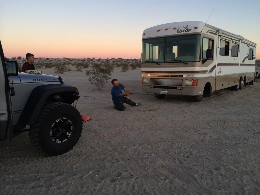

Insanely hard work, took us over two hours, and two vehicles, two snatch blocks, two trees, five people.....
Tesla Cybertruck Winch - What is the priority? 1657227391786
