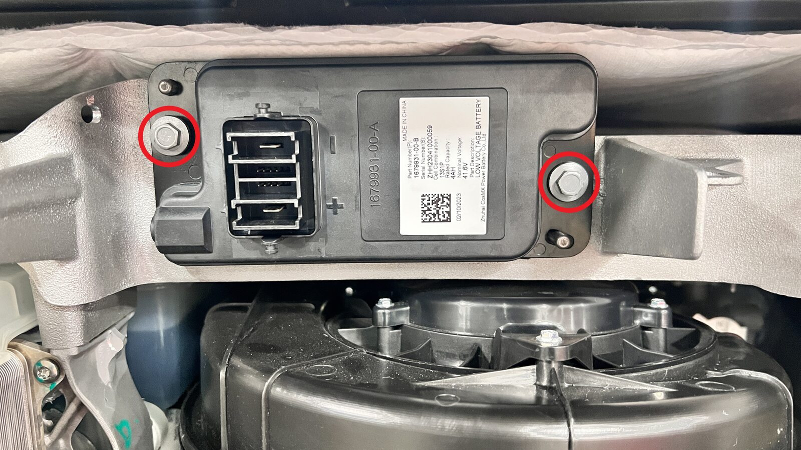

There is a service procedure for disconnecting the MV battery for a true “power off”:
https://service.tesla.com/docs/Cybe...UID-A399E8AE-5DCF-4095-91FA-AF0148503F3B.html
I’ve done it myself before, not too hard.
However, I suppose there’s a chance that the truck may not even startup afterward, but you’ll only be slightly worse off than you are now. Just perform this in a place where it will be easy to flatbed if it all goes sideways.

3. Full MV (48V) power disconnect/reconnect — the “hard reset” (most likely to fix a stuck computer/fault state)
This is what Tesla service does for these bricked cases and what one owner recommended in the exact forum thread matching your description. It fully cuts 48V power to force a complete reboot of the computers.
• With frunk open (from step 1), follow the Tesla service procedure (publicly viewable): Disconnect the first responder cut loop (slide red tab, press blue tab), then the main MV battery connector (red tab + black lever). Wait 2+ minutes (or 5–10 for good measure). Reconnect in reverse order.
• Full steps are here: https://service.tesla.com/docs/Cybe...UID-A399E8AE-5DCF-4095-91FA-AF0148503F3B.html
• There are YouTube videos like “How to Power-up a Dead (but charged) Cybertruck” that show the exact connectors visually (light blue first-responder loop + red MV connector in the frunk).
• Prep note: The official procedure wants windows lowered and rear doors propped open first (shop towel trick in the strikers) to avoid lockouts if it fully powers down. Since doors currently work, you may be able to lower windows manually first.
After any of the above, immediately plug in the home charger and try the app/scroll reset again. If it wakes up, drive it gently and schedule a service appointment ASAP (they can pull logs remotely once online).

Well, no luck with my friend's truck. He tried the 48V battery disconnect / reset, checked the voltage of the 48V battery and it was fine. Wasn't able to get the truck to come back to life. It appears that getting it to the service center is the only option left.
Bummer! This has to be the most unlucky situation so far away from a SC. I would beg them to walk you through some advanced diagnostics.
May even be cheaper to fly some out to the truck 🤦
How long did you keep the mid voltage battery disconnected? I'd say leave it unhooked for 10 mins.

He said he left it disconnected for close to 10 minutes. I'm still a little unclear about what the actual voltage of the 48V battery read when he checked it. He didn't say that it was low.
But then I talked to him yesterday and he said it's on the truck to Anchorage now, and that the 48V battery finally died. So maybe that was the issue after all? Or maybe 10 days of sitting in a bricked state with the computer fan running was enough to drain all the juice. Will be interested to hear the diagnosis from Tesla and whether they can give us further steps we can take on our own.
