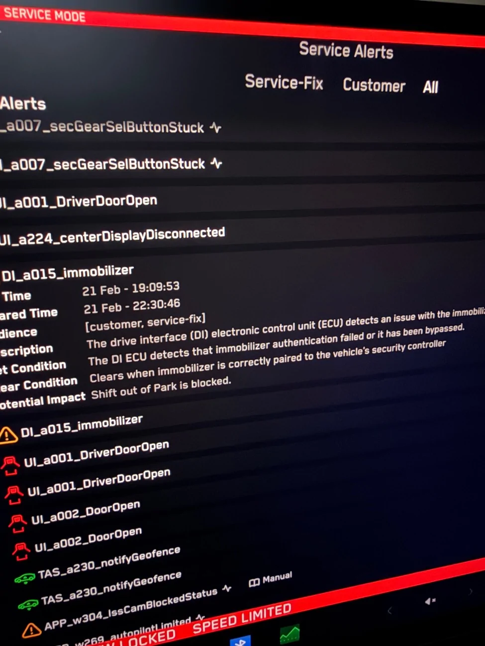

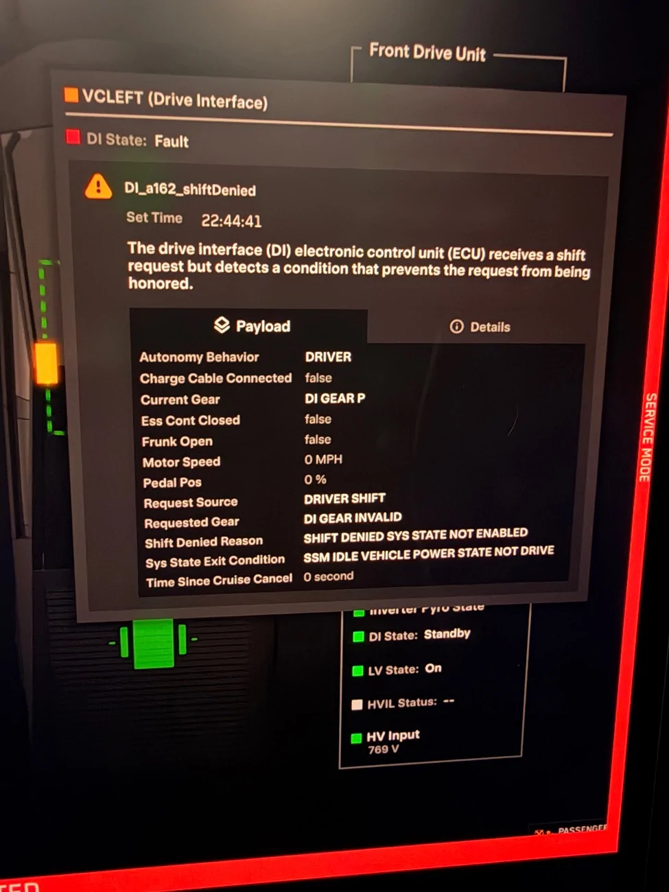

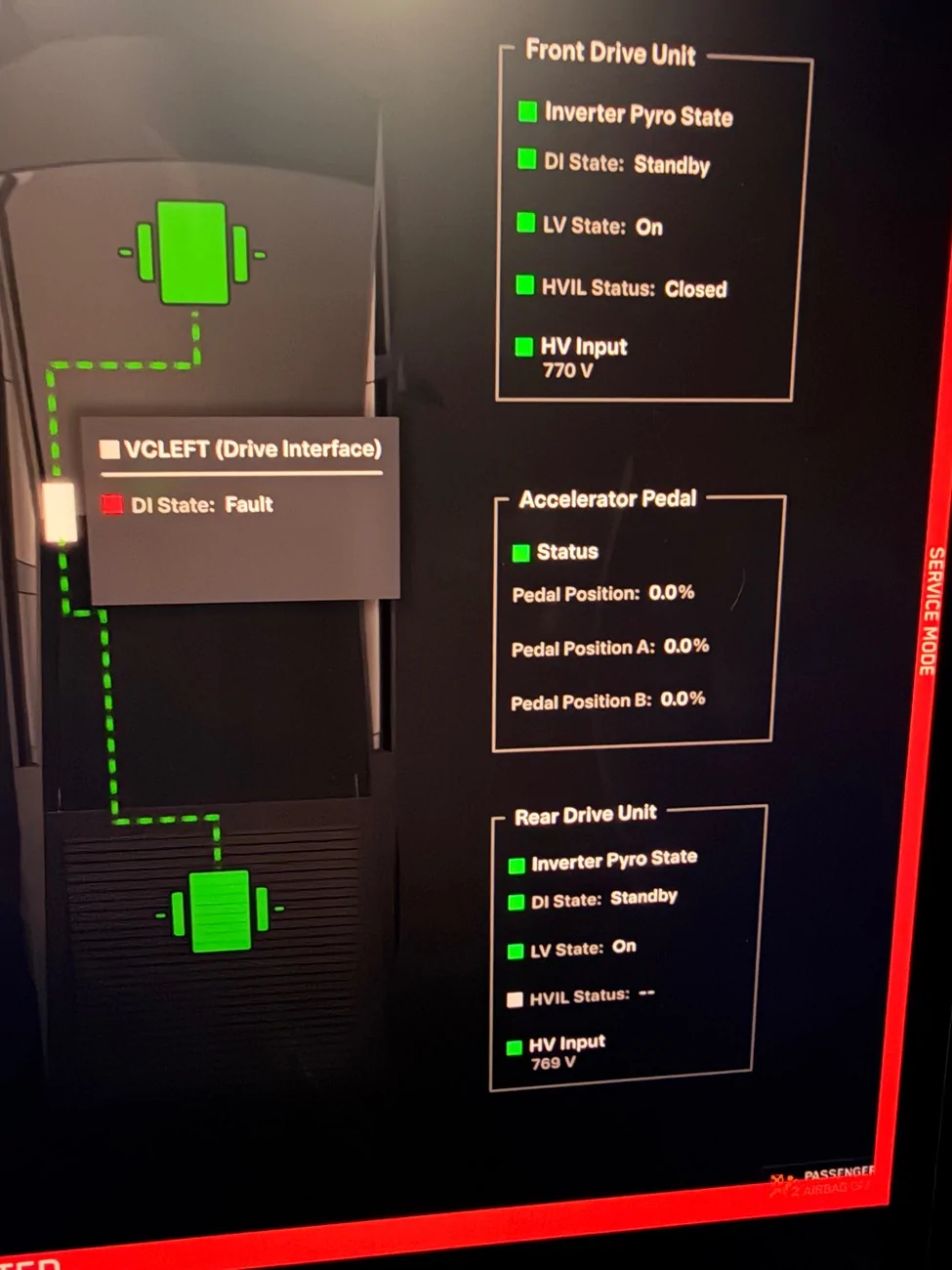

Received the update to 2025.45.10 and after the update I cannot shift into park or reverse. Service mode error DI_a015_immboilizer showed up right after the update. Screen won’t respond to shift request and the secondary “manual” shifter will only allow neutral. Ugh! Buy back here we come I guess
