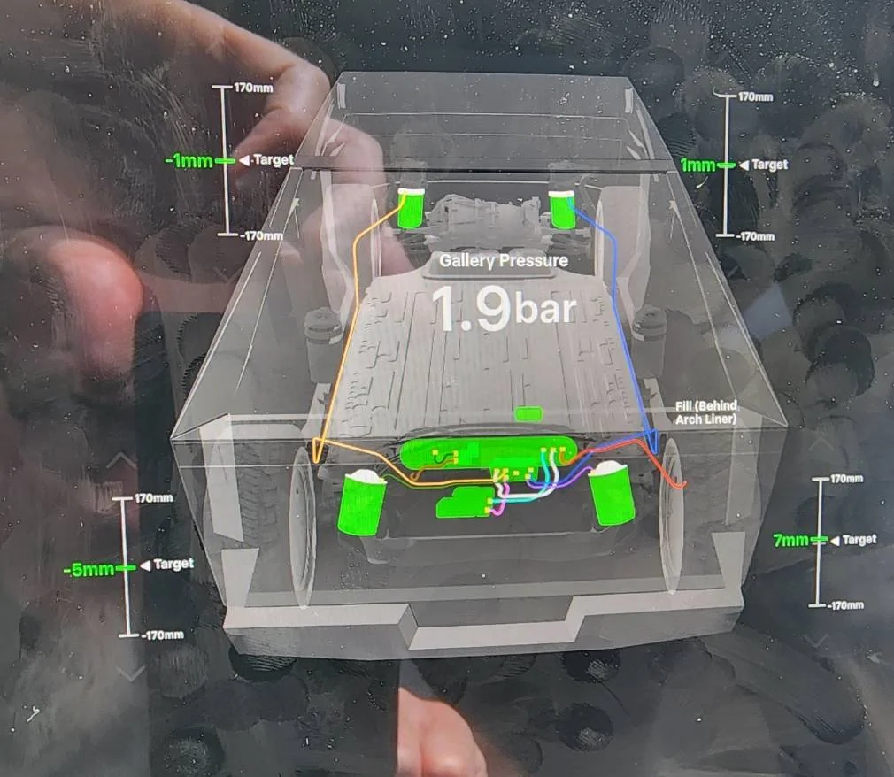

Service mode shows the corner is off though. So is the sensor the issue?
The bracket that holds the sensor could be a little crooked. Which in turn will throw off the reading from that sensor
Yeah, but the sensor reading matches the lean of the truck. That is, rear right higher than rear left.

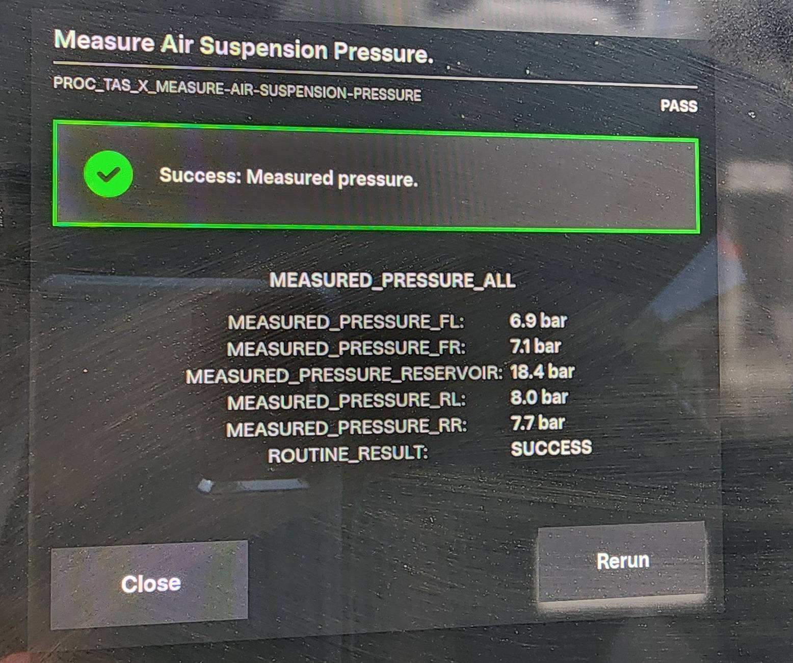

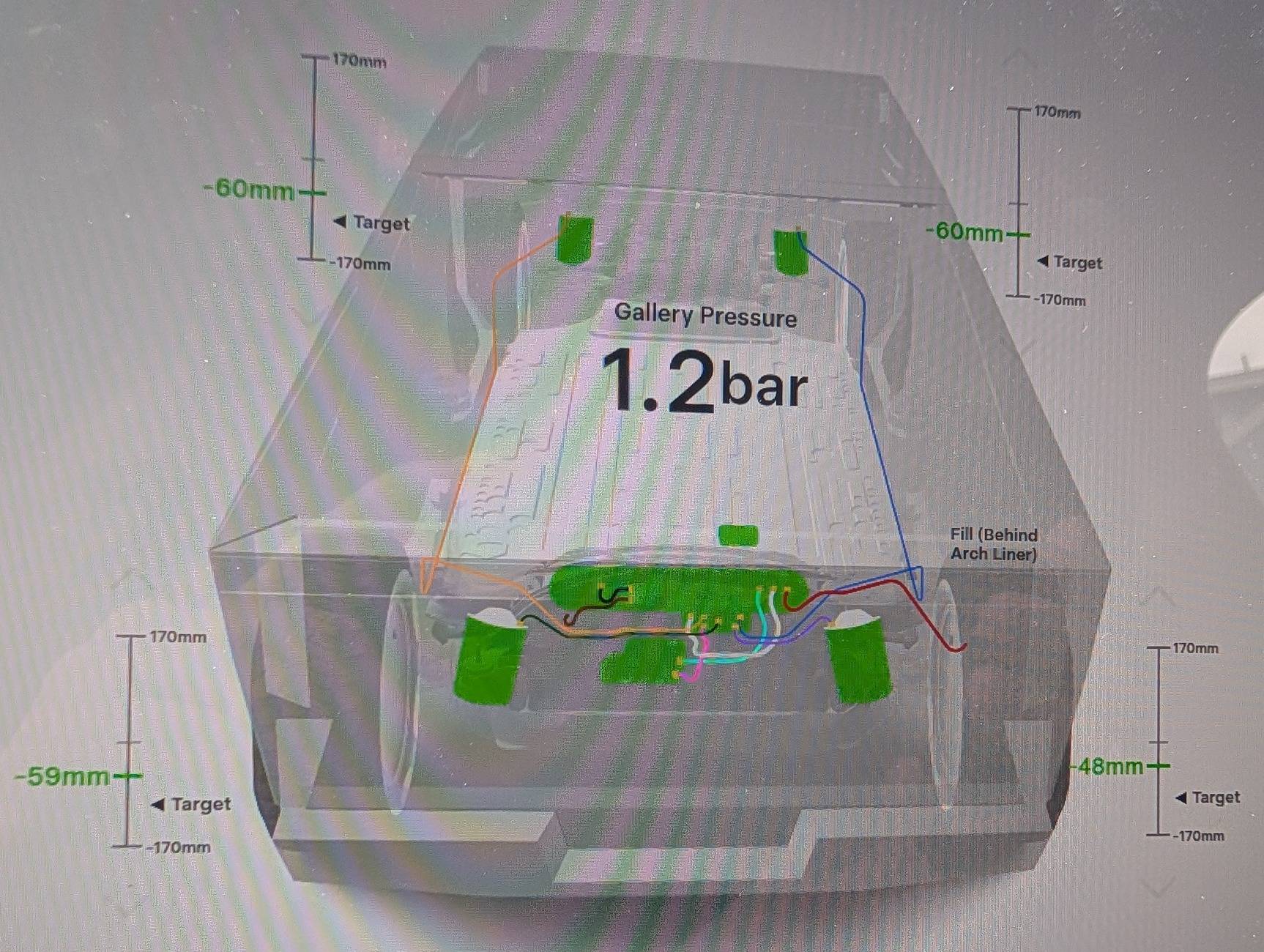

Since people think it is the place I am parked, I did measurements at another location as well.

What order were the measurements taken in and was entry mode disabled? I'm trying to correlate the readings with inflation vs deflation events.

You can see the readings are off.

Set the truck at medium ride height. Then check readings. May have to roll forward or backwards to get it to stabilize. Readings should be zero. There is an allowance of +/- 5mm
I believe I started with Medium and then Low at both locations
