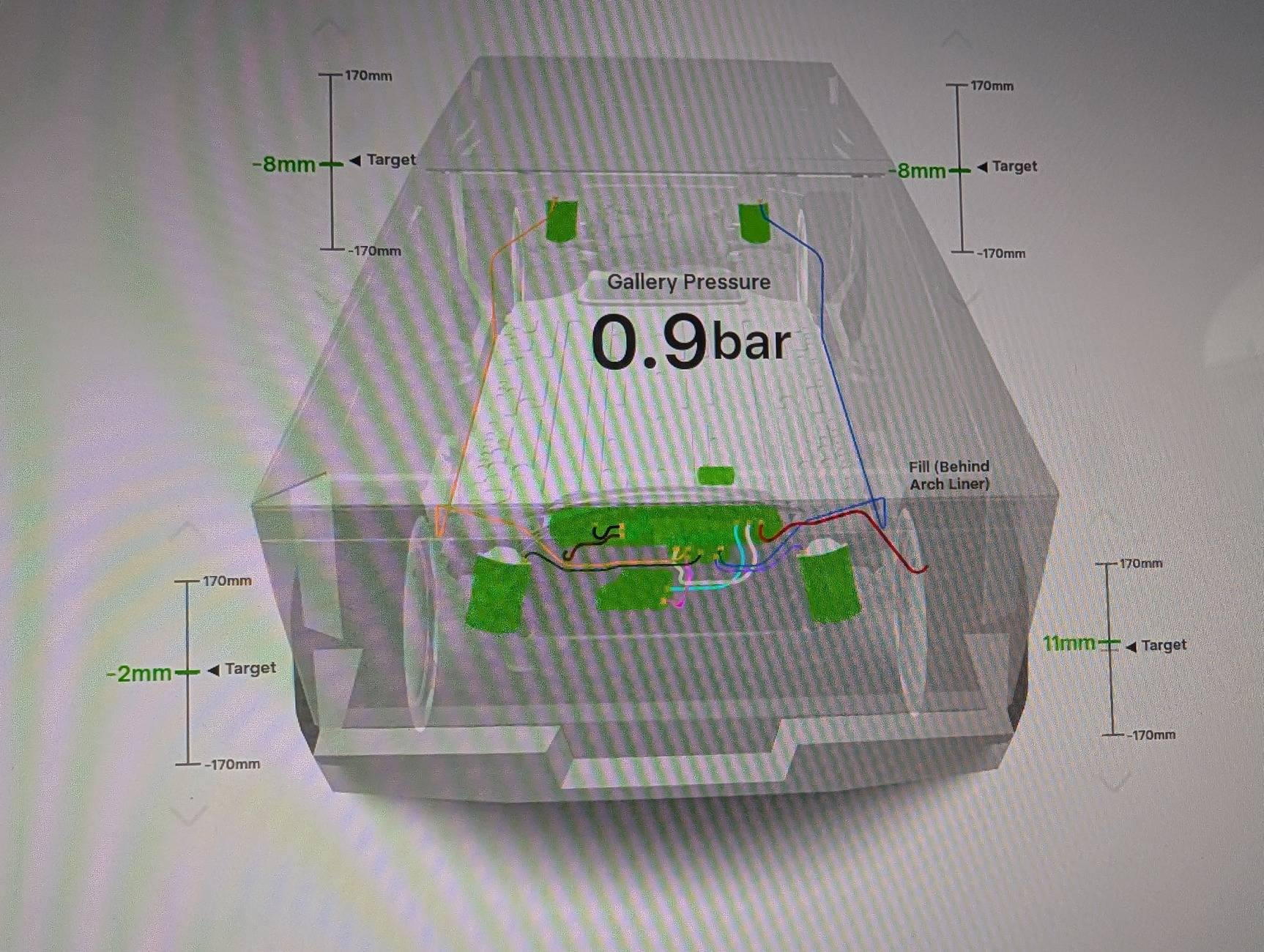

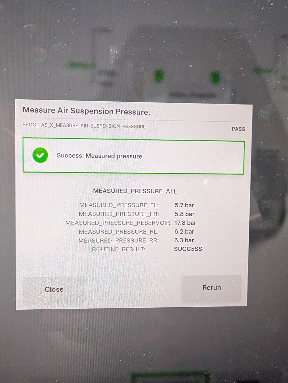

Data says passenger side is 11mm higher (less below center)
Try setting the suspension to medium and see what it reads, but passenger side is off compared to the rest.

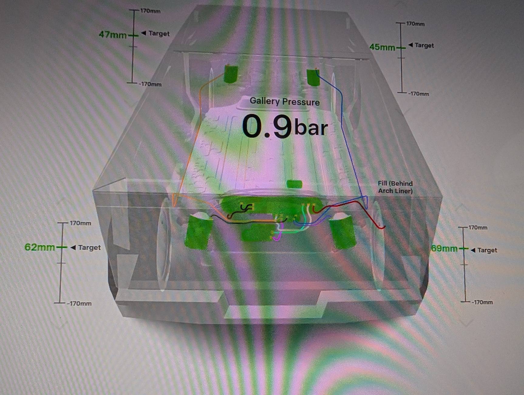

Here are different height levels.

Yeah, something seems off on the passenger rear air shock...
Can you run the pressure check in medium?

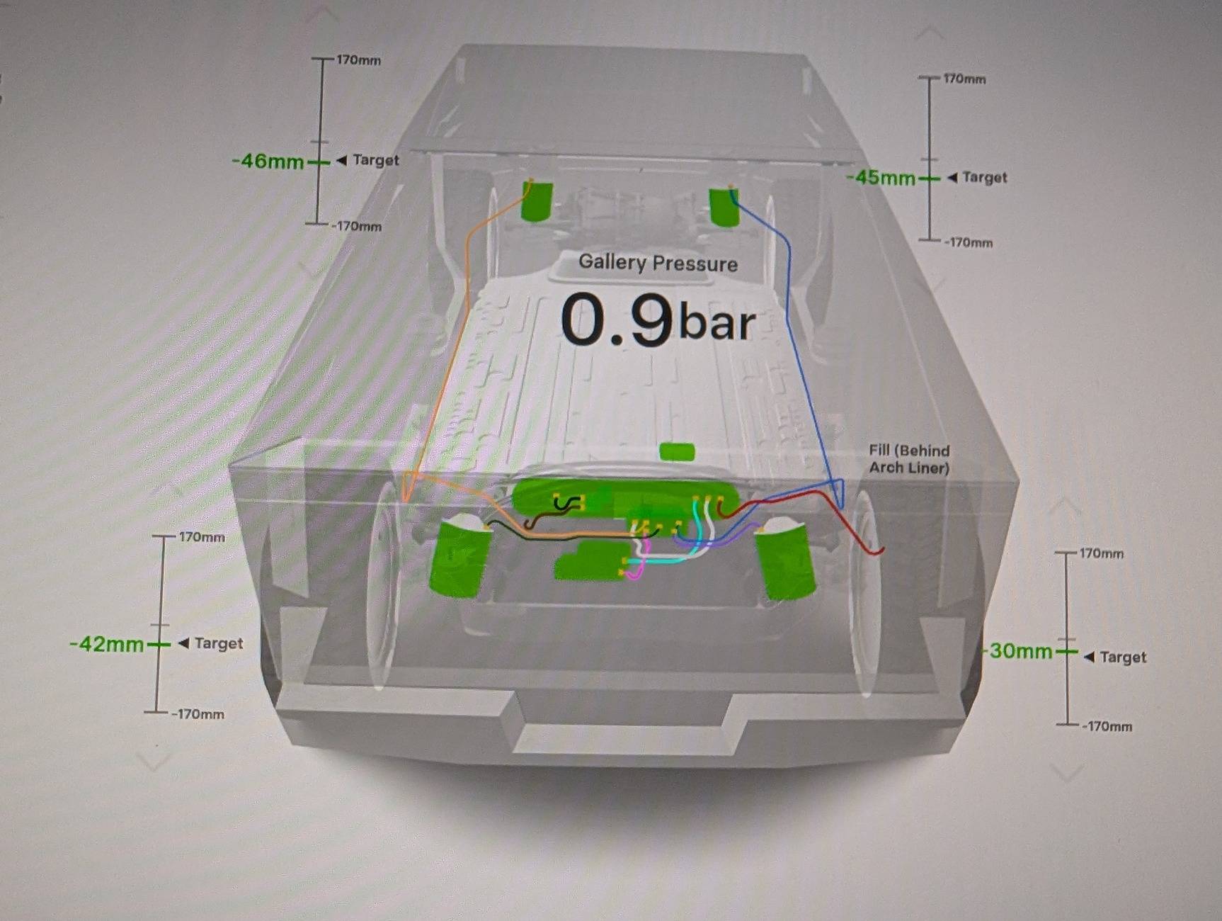

I think the first one is the one in medium

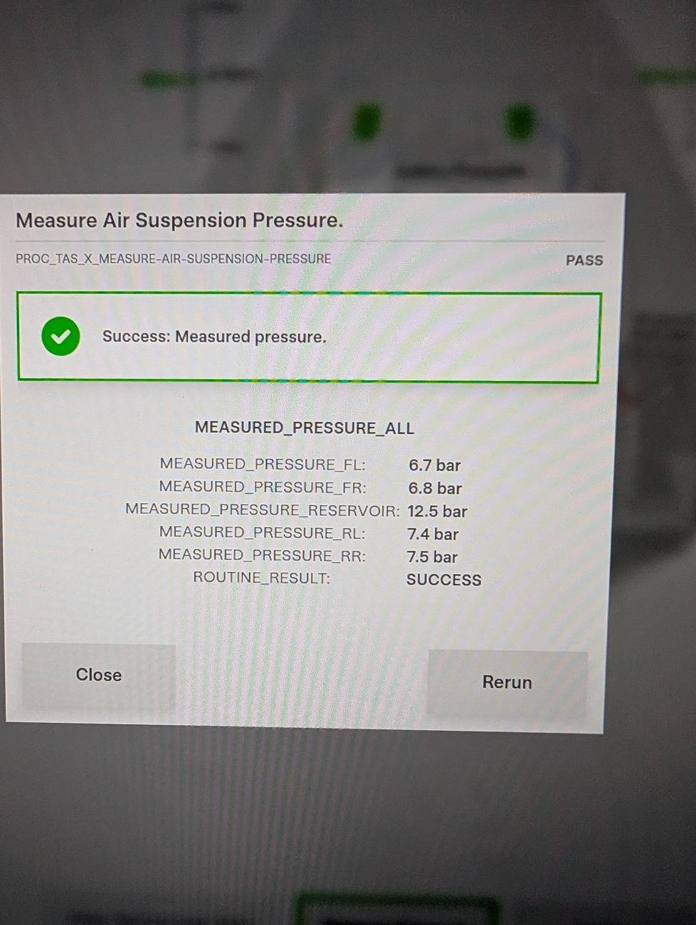

Pressure seems a little high also. I wonder if that valve is slow to change.

So it was off by more than 0.2" from ideal (or 0.4 corner to corner), but they said it was in spec?
Maybe open a new ticket with a few instances of sensor data at medium height along with their spec of +/- 5mm from https://service.tesla.com/docs/Cybe...UID-AD49F177-08D6-4B6E-BE24-4361D52F44C4.html

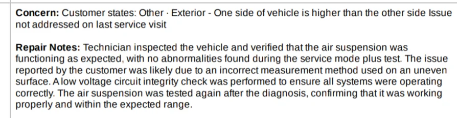

I don't understand how this can be within spec either.... I can only hope they are looking at the same thing but they didn't mention these tests, they just mentioned they measured the rear wheels... They said the did tests and they passed so I have no clue WTF is going on at my service center

And they keep putting these lies that the issue is fixed with every service I have....
Tesla Cybertruck Need help !!! 1000011149
Or that I don't know how to measure something correctly....

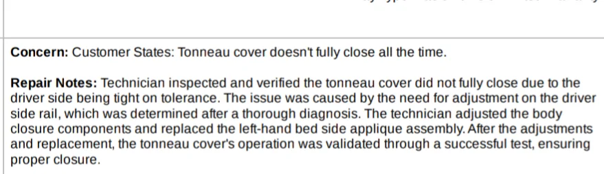

Side note.... I have had continuous issues with the tonneau cover due to an issue with tolerance issues related to the driver side ...

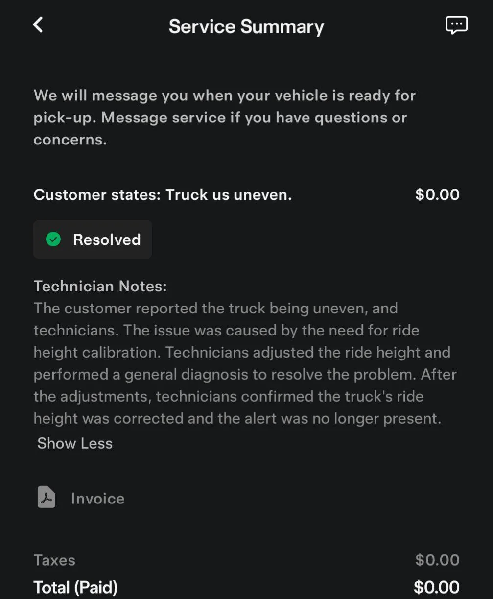

The first service report says that they did need to calibrate ride height. It was only correct afterwards.
