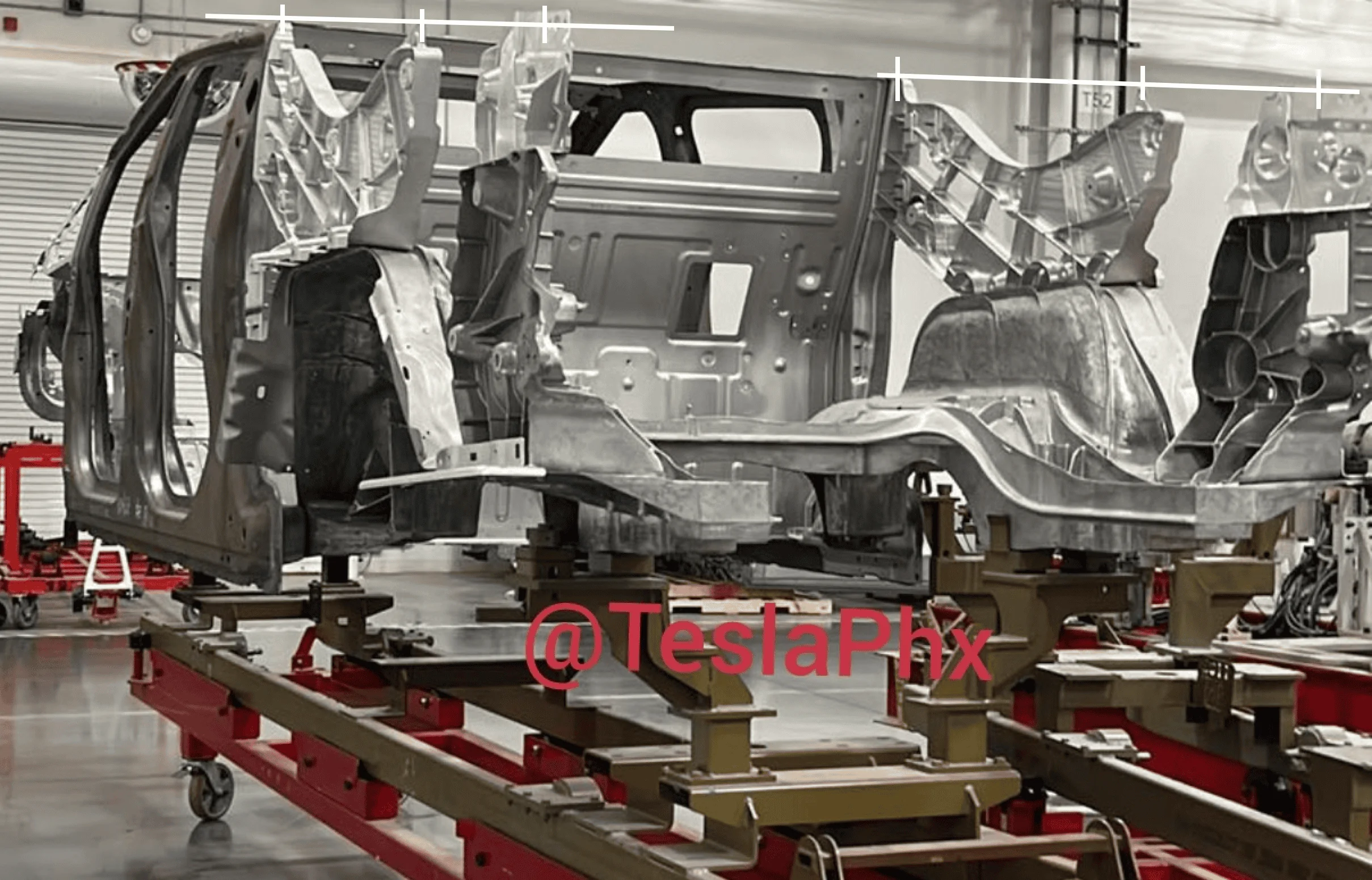

The exoskeleton concept is the classical jet aircraft design concept where the entire strength comes from the outer skin. When the Cybertruck was announce it was going to be built as an exoskeleton using special hardened 3mm stainless steel (as a bonus it didn't require painting). Now the funky (ugly?) shape was a direct function of that 3 mm ss can't be stamped in a body panel press and could only be bent, so design followed function which is all well and good.
Somewhere along the line and without any fanfare, the exoskeleton concept was quietly dropped. For better or for worse??
We seem to be preoccupied with the windshield wiper design, the shape of the mirrors and number of cup holders but no one brings up that the fundamental concept has drastically changed. That just quietly slipped in!
Am I missing something? Not to say that the changes are for the worse, but I certainly believe they warrant discussion and should not be quietly ignored.
Um this has been discussed a while ago with plenty of dedicated and off-topic threads, to the point many were exhausted by the topic.
The main thing that differed is really a misunderstanding of what EM meant with "exoskeleton", because the original CT nor the current version, never really had a "real exoskeleton" by definition, seeing they always had bits that opened or weren't even structural on the outside. It has been fairly clear since the Texas built MY that the construction would primarily be a front and rear cast with cabin frame supported by a structural battery pack. All the rest was the result of people expecting the SS to be the "main structure" and thereby justifying its existence, whilst in reality it had a more superficial nature, with exception of the doors and windows as such.

I wish the photos would be from the side instead of only from an angle. I like the shot from the rear but the shot I'm attaching is shot at the height of the bottom of the CT making it difficult to get a clear understanding of how the rear casting looks. The rear casting doesn't follow the shape of the finished CT but it appears the possible rack attachment points are part of the rear casting. This is good news, at least to me. The weight on a rack would be supported by the casting instead of by the body, which is the way most CIE trucks do it. I added white lines showing the slope of the attachment points along with possible connecting points.
There is no ambiguity about what an exoskeleton is. A Boeing 747 has landing gear which attaches to the exoskeleton. The structural battery pack and mega castings attach to the exoskeleton. The 3 mm stainless steel panels were supposed to be the structure.
