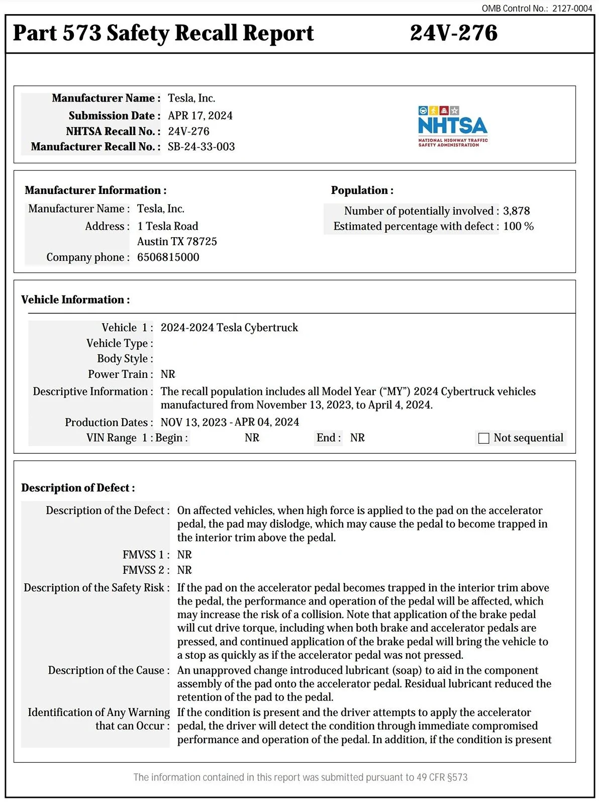

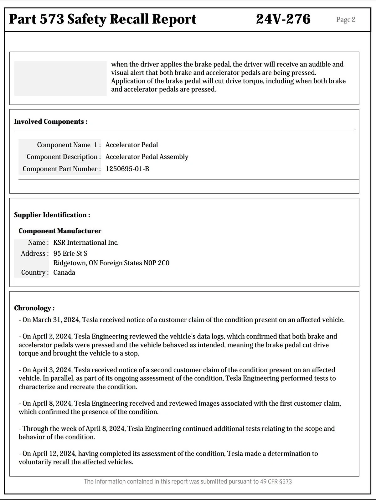

Official NHTSA recall notice:
https://static.nhtsa.gov/odi/rcl/2024/RCLRPT-24V276-7026.PDF
Interesting note—when Tesla filed the recall with NHTSA, they said 3,878 CT were shipped. With the VINS we are seeing seems a little off but I was always bad with math.
