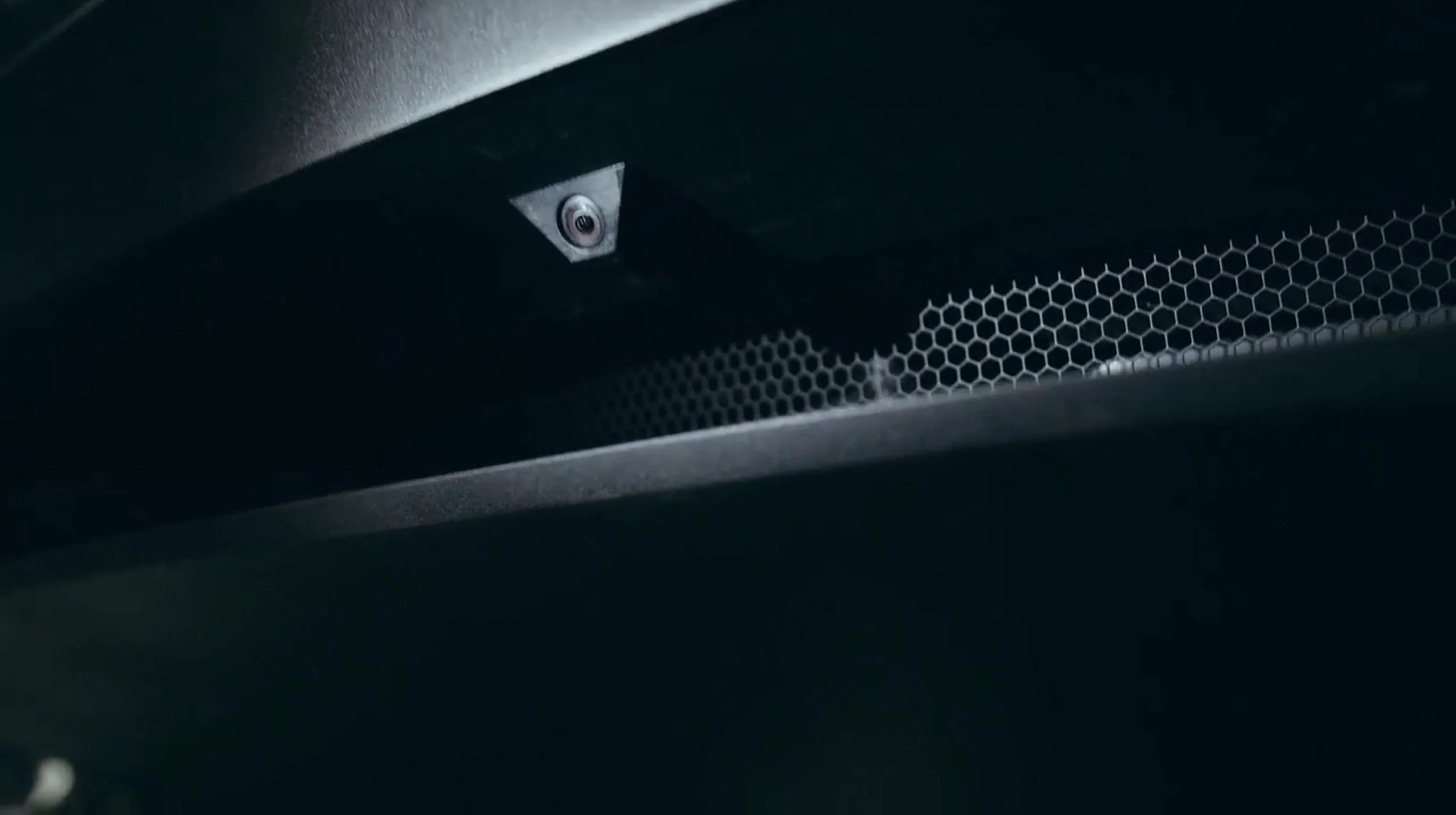

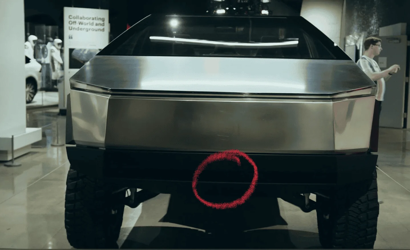

Will Cybertruck have a camera in front grille that could better see high-speed cross traffic like Chuck Cook unprotected left turn with blocked view ?
Will Cybertruck be able to see Around Corners!!
View blocked by walls, bushes, parked vehicles, vehicles in adjacent lanes while exiting parking/driveway or entering streets - see pedestrians or approaching vehicles.

Will Cybertruck have a camera in front grille that could better see high-speed cross traffic like Chuck Cook unprotected left turn ?
Tesla Cybertruck Not enough cameras for FSD - a physic-driven simulation 1668839418597-png
Tesla Cybertruck Not enough cameras for FSD - a physic-driven simulation 1668839329696-jpeg

Agree that Volvo has done a poor job of implementation. Ford's looks poor too.
Tesla new cameras should be much higher resolution than Volvo's.
What I hope is that Tesla puts two cameras (one on each front side) in the front grill (or headlights) that point forward but angled 10-15 degree to the side so they can get undistorted views of environment 180 degrees to the front edge of vehicle (approach cross traffic). These cameras should be primarily for FSD to create more accurate and longer range (100-120 meter) views of cross traffic (especially higher speed traffic, 45-65mph).
