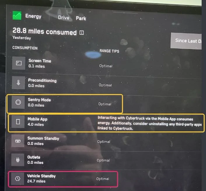

Wow, if I turn off sentry and hvac on my model Y there is almost no drain. I hope this gets figured out.
His display shows "Sentry Mode" inactive and "Mobile App" way lower than "Vehicle Standby"
