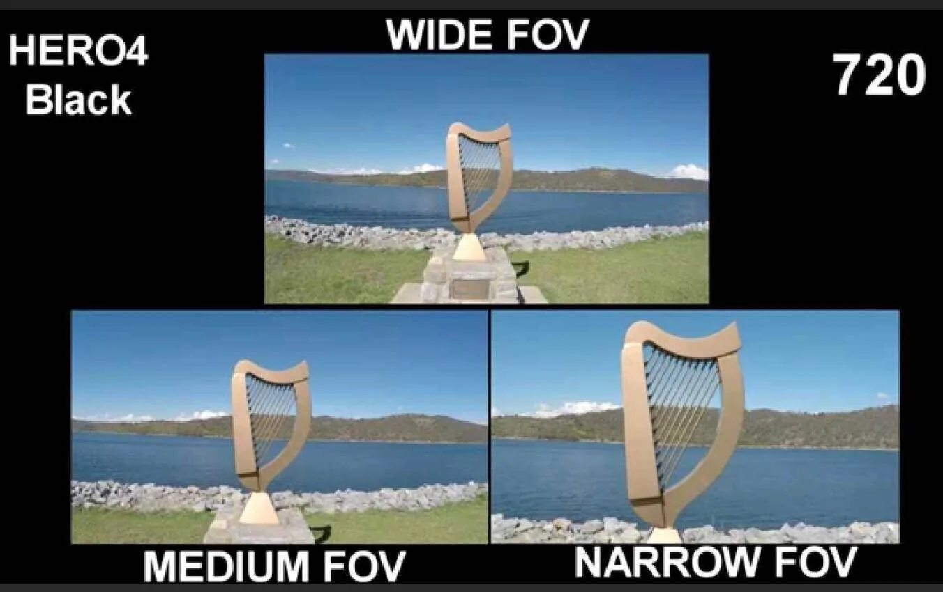

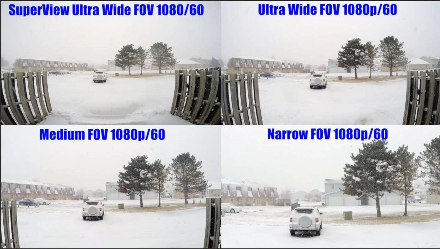

It all comes down to field of view (FOV ) and personal preferences. I know people that never check their rearview mirror and only check the side mirrors (sometimes) when changing lanes.
A wider FOV, which we currently have with the CT rear camera, does allow one to see more area but at the sacrifice of seeing less detail. The photos below illustrate exactly this point. I believe the CT camera rearview (zoomed in) is around a 100-degrees FOV as compared to an old school interior rearview mirror which is around a 40-degrees FOV. If I get some time this weekend, I will try to get some actual pictures with the CT camera system to illustrate this point.
Both wide and narrow FOVs have advantages and disadvantages. If deleting the side mirrors, then a wider FOV is absolutely necessary. If backing out of a garage or a parking spot, the wider FOV is much better. However, for highway driving, I prefer the traditional 40-degree FOV for the better presentation of detail. With the narrow FOV there is less distortion, and I can better judge closure speeds of the traffic behind me. I can also distinguish makes, models and even read license plates, all of this is difficult if not impossible with the wider FOV. That said, when changing lanes then a side camera, side mirrors or a wide FOV display is necessary.
For the CT I would like the option of a traditional 40-degree camera view displayed on the screen (or on the interior rearview mirror). I would like to see the corresponding camera mounted on the top of the cab (as some on this forum have ingeniously retrofitted). The advantages of putting it there are it could also monitor the rear bed and cargo load-even with the tailgate down. It would also be less susceptible to degradation by road spray and "salt".
Personally, I feel the CT ideally should have the ability to display both a wide FOV and narrow FOV picture on the center screen simultaneously. I don't know if this is possible with a software only update or not. Then there would be no need for any no old school exterior or interior mirrors, though some state laws need to catch up to the new technology.
There is so much that is great about the CT it is easy to pick on something that does not reach the level of excellence of the other systems. I always believe we should try to make the best better and the current CT mirror/rearview display setup can definitely be improved.
