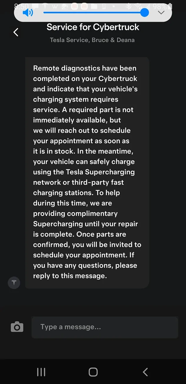

We recently have experienced PCS issues with our 2024 Foundation CT with just over 10k miles. The symptoms we've seen include: Mobile charger frequently limited to 24A, "Camera System Unavailable", and errors encountered by "Sentry Mode" likely the result of the Camera System. We confirmed a PCS issue by entering "Service Mode" where we ran diagnostics that flagged a PCS error. We are still able to charge using a mobile charger, but only at the reduced rate of 24A. We attempted to schedule a service appointment using the Tesla App, but after the service request was "In Review" for 2 days, my wife drove to our local service center (in her Subaru). Apparently the service center folks ran remote diagnostics to confirm the failure and told her they would order the part and schedule an appointment when the part arrived. The Service Center could not give her a ETA for when the part might arrive. The following day we received a message via the Tesla app confirming the issue and that we would have complementary access to Super Charging until the repair is complete.
