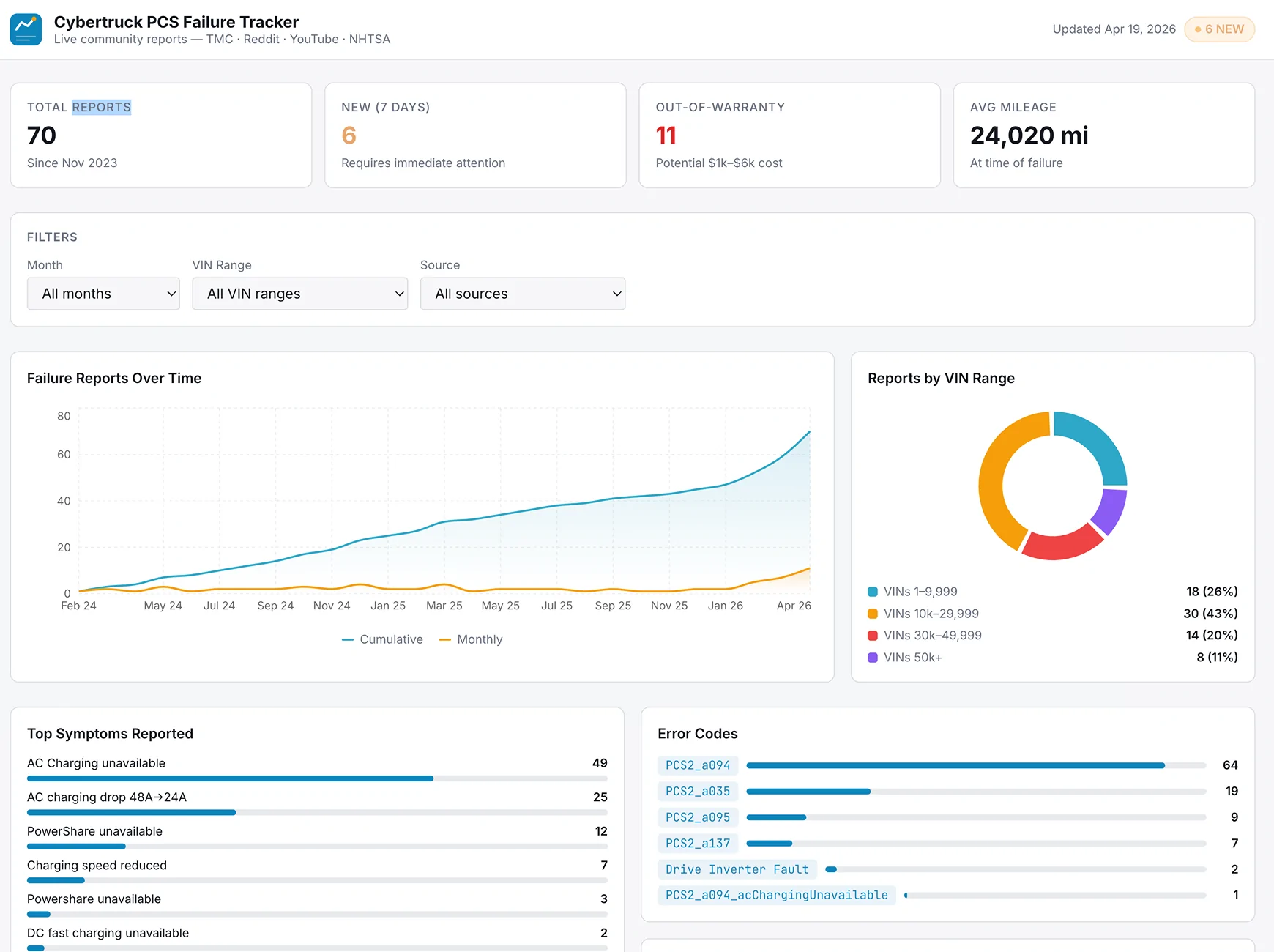

Also filed a report with the National Highway Traffic Safety Administration. My local shop in Houston is experiencing around 3 to 4 PCS failures per week (and sometimes more).
Unfortunately, I am out of warranty and may have to cough up $3k to $7k to cover repair.
I would encourage everyone, even if you’re covered under warranty to file a report with the national highway traffic safety administration to bring visibility to this issue, which definitely warrants a recall.

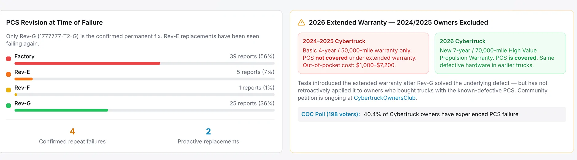

The cost has been reduced to $1000 for the PCS replacement. I’m still pushing for full coverage and have filed complaints with several consumer advocate organizations (BBB, NHTSA, TxDmv. Etc.)… The truck won’t be ready for at least another week due to the pcs being on backorder.
I will stay with the process and wait to hear back from the investigating organizations. I’m still waiting on confirmation if the new Tesla PCS repair price for out of warranty PCS‘s is $1000.
I READ ON A FORM THAT TESLA HAS REDUCED THE PRICE TO $1000 FOR ALL OUT OF WARRANTY PCS REPLACEMENTS. Or this could be 50% Goodwill, which is what Tesla initially offered.

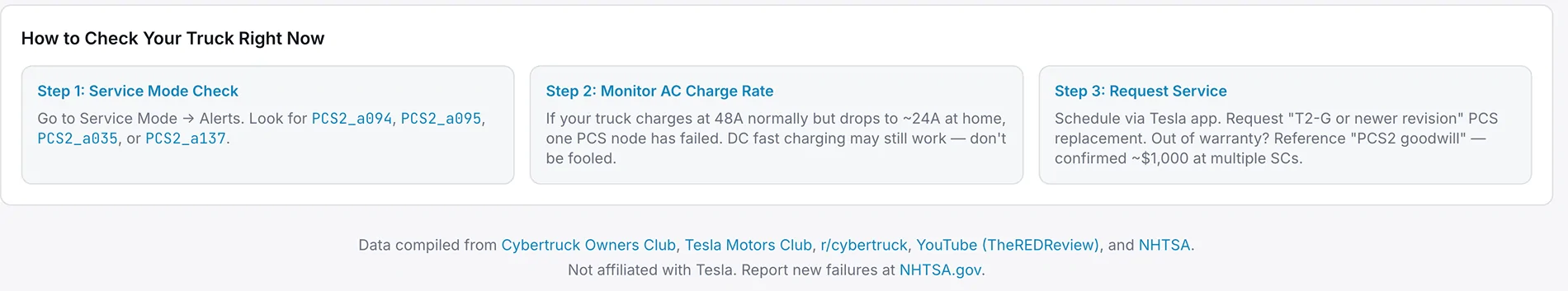

Wait—are people unable to charge both AC and DC when PCS fails?
I thought PCS only affected AC charging. When my Model 3’s PCS completely died, I could still Supercharge it for 4 weeks until my appointment (Sterling, VA service refused to consider it urgent). But maybe the Cybertruck PCS is configured differently…?
My PCS failure prevented any charging, AC home or DC supercharging. Inspite of the dash message reporting DC charging is functional.
Worse on the Supercharger, it did not post an error - watching like a hawk, it would 'start' charging , then switch to 'idle' as if you had not started charging at all. And kept doing that when you press 'Start' charging.

Add me to the list of Cybertrucks with the PCS failure. Was AC charging from 61% to 100% in anticipation of a trip down to Starbase City tomorrow. Charging stopped at 83%. PCS failure. AC charging not available. Never dropped to 24A though. Oct 2024 AWD NonFS. 28900k miles. 41XXX VIN.
I did get an appointment for tomorrow at my local service center. For 2pm. I’m taking it in as soon as they open in anticipation of a loaner that I will promptly drive to the coast. Hope they don’t mind the 1000 miles I’m going to put on it in 3 days.

We actually just had a poll on this. Seems to be a high likelihood every truck will have this issue just depends on when. I had the PCS failure at 5k miles...Is this OUR IMS/Vanos issue?
Keep us posted on how it goes, screenshots of post warranty service /costs would be very beneficial.
