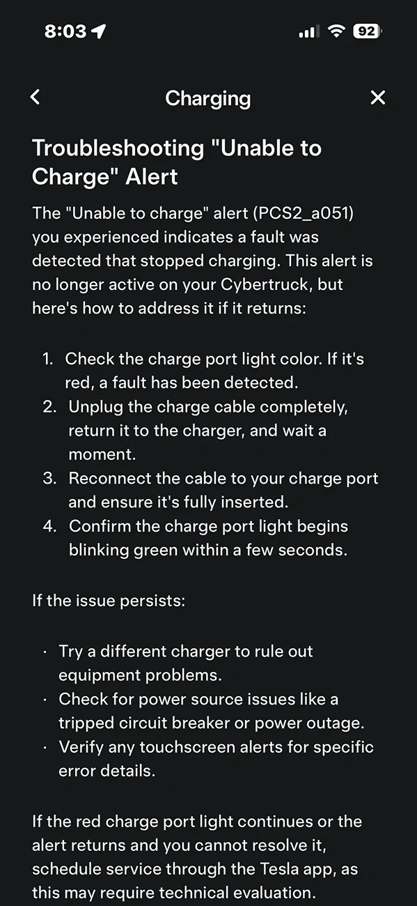

PCS_a051_bmsMia isn't the DCAC charger/inverter module error failure.
. after doing a service request on the mobile app I got this message.
when I unplugged the wall charger I did not notice a red light in the charge port. may not have noticed it. somewhere in other PCS threads there is a list of PCS error codes. I'd assumed this was one of them.
Tesla Cybertruck PCS failure on Rev G Vin 79xxx IMG_7438
May 27, 2024
4,639
5,644
In this case the PCS is reporting that it hasn't heard from the bms, which usually stands for Battery Management System. So the issue could be anywhere in that communication chain.
