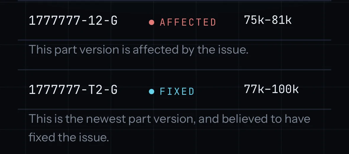

As someone said before, not all G revisions are the same.
As far as I know, there hasn’t been a repeat failure after the correct one is installed.
The good part is the one that ends in T2-G. If it is 1777777-12-G then it still has failures that’s installed originally from VIN 75k to 81k according to the data available.
You can add the last six of your VIN to check which part you have here:
https://pcsinfo.vercel.app/
