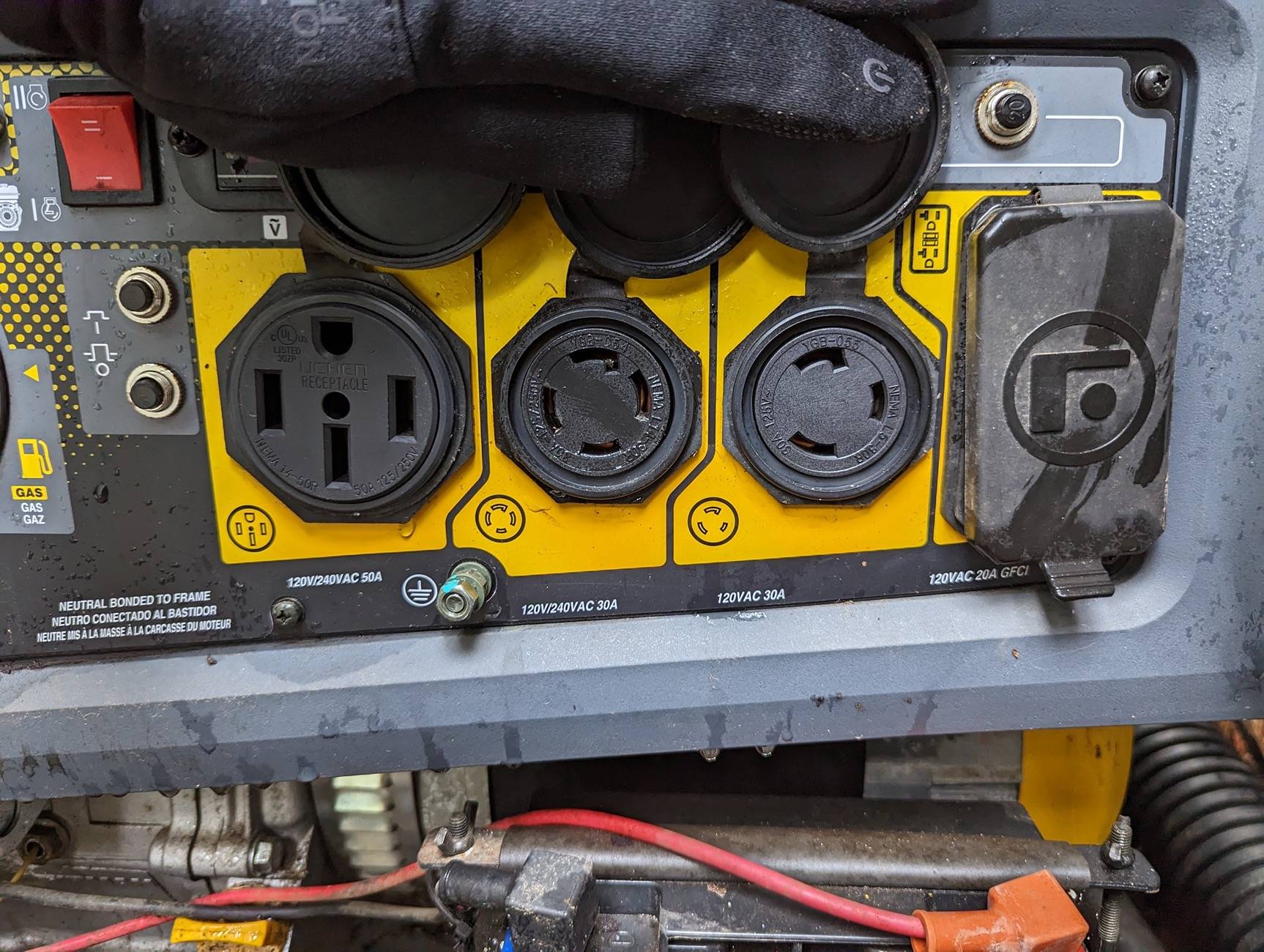

And my generator does provide 240v. Dunno why you'd buy one that didn't if that was your application.
Tesla Cybertruck Portable generator as "Range Extender" PXL_20230110_194401596_Original
It also revs up and down based upon load. Nor is it very expensive. Tho I'd say definitely needs two people to lift it into a truck or a ramp.

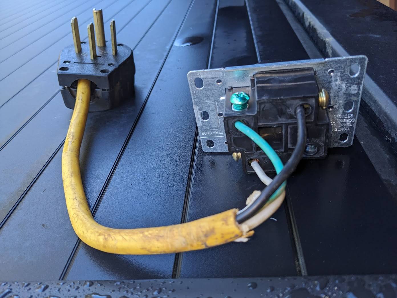

I don't advise anyone to do anything like this below, just sharing what I've done and what the result was. I've made this hasty adapter with one hot, neutral and ground coming out of 14-50 and connecting to hot, hot and ground on 14-30.

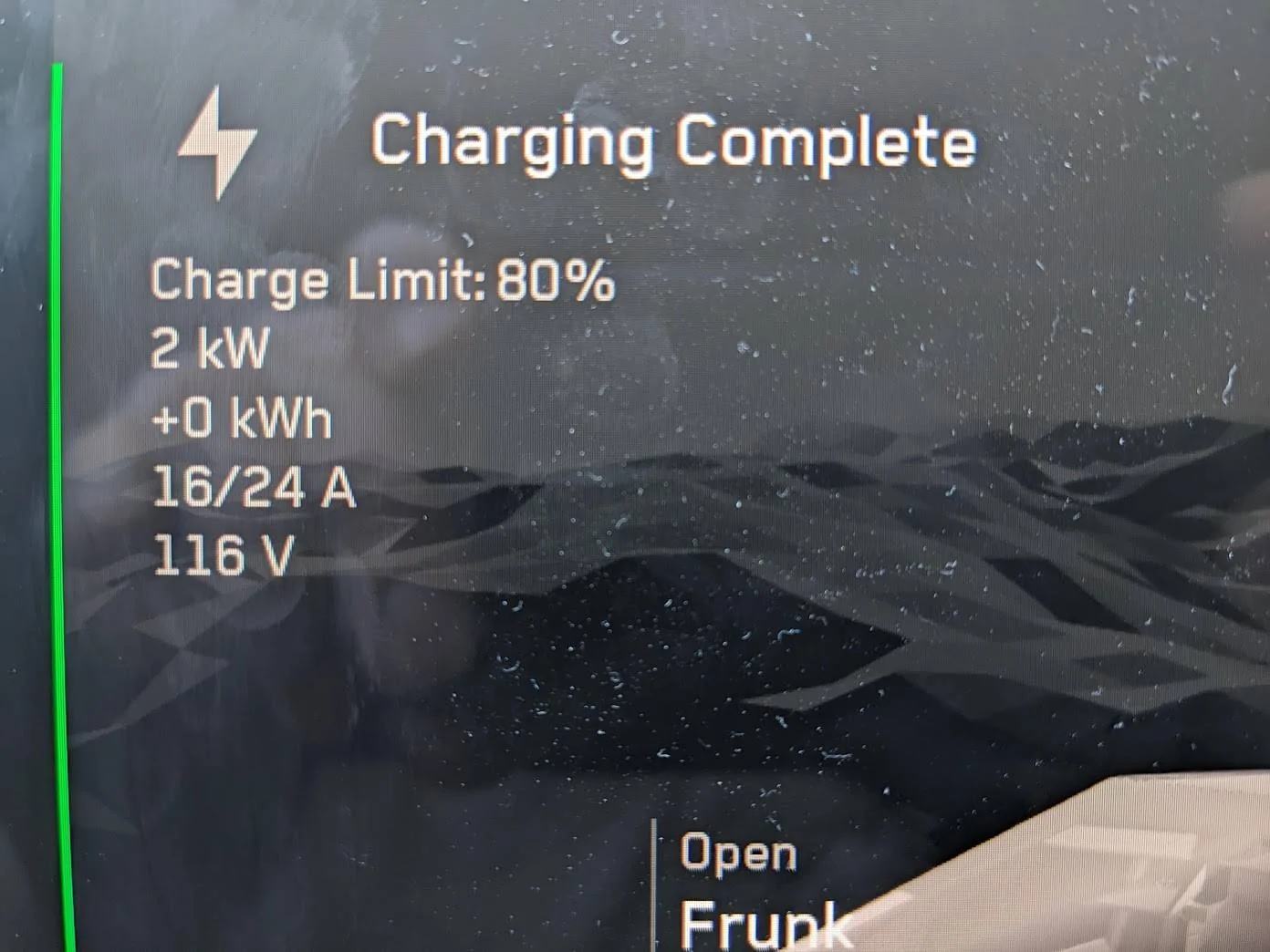

I've then used the 14-30 adapter that came with the Mobile Connector and it was seemingly happy with this arrangement
