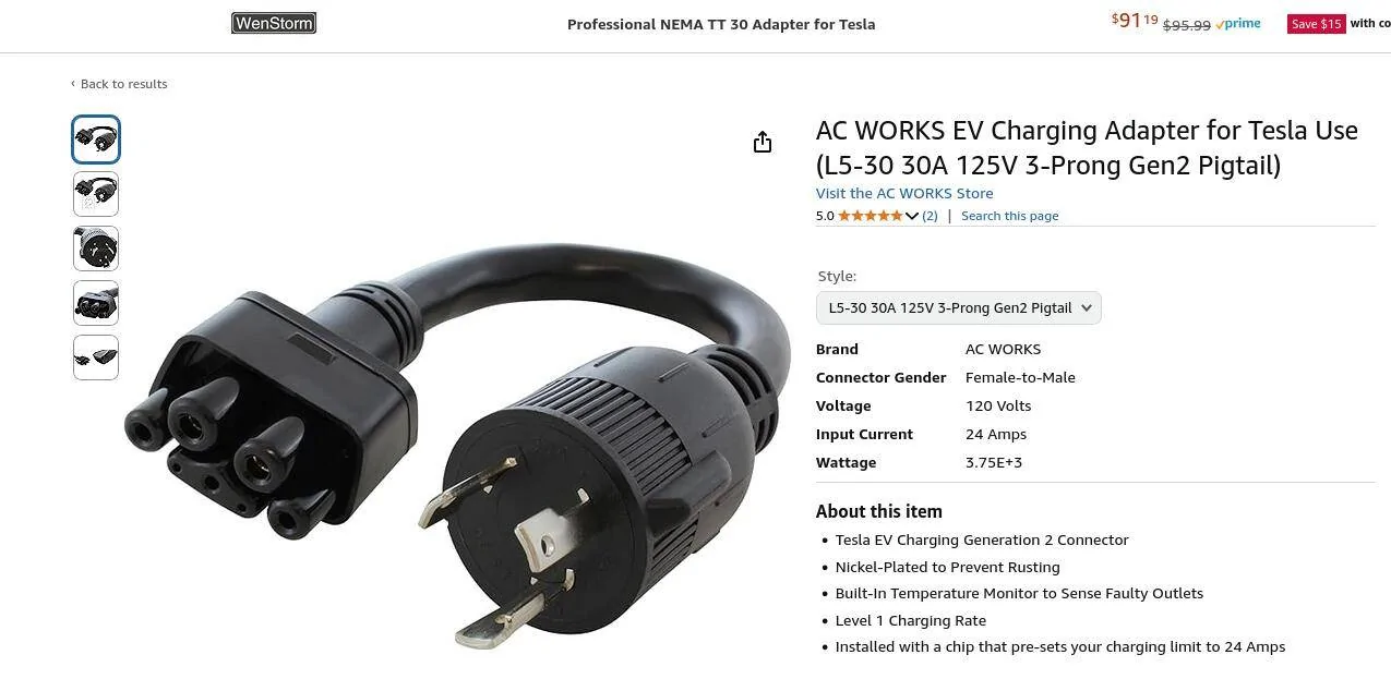

If you end up doing the Honda with the Companion unit, this is the cable you want:
Tesla Cybertruck Portable generator as "Range Extender" Screenshot 2025-01-07 at 21-18-41 Amazon.com AC WORKS EV Charging Adapter for Tesla Use (TT-3

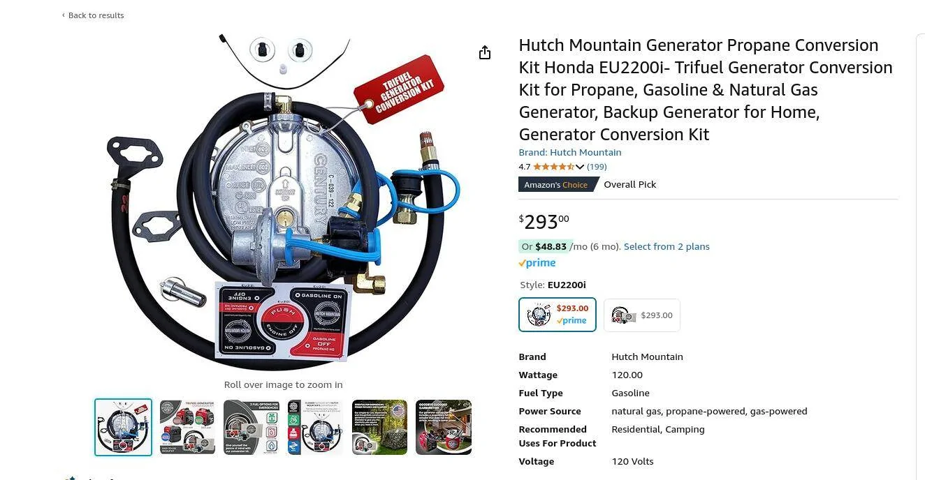

Also those Hondas can be retrofitted to run on propane as well :
Tesla Cybertruck Portable generator as "Range Extender" Screenshot 2025-01-07 at 21-22-33 Amazon.com Hutch Mountain Generator Propane Conversion Kit

i thing personally propane is the way to go . Can also be used to camp with . Just have no idea how much propane would be used in comparison to gas .
It's mostly density. Gasoline contains like, a quarter more energy per gallon and doesn't need a pressure vessel.
But gasoline spoils easily - it can contain water and ethanol, which attracts more water. It can also carry rust more easily. Diesel doesn't ahve these problems as much, but has its own problems.
Propane basically doesn't do this. Propane also burns cleaner. If you're running off of propane you need to do far, far less maintenance, and it's much more difficult to foul plugs or rust the tanks.
So... Bulky propane or finicky gasoline? What's available to you, what's cheaper, etc.
I basically always use propane because I don't want to do maintenance.
