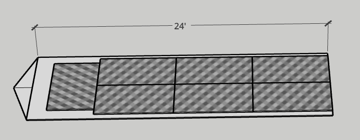

I have plans to put together a DIY travel trailer. With a 24' box you can fit a lot of solar. Between 3kw-6kw. But the nice part is you can load up the RV with a big battery and a 240v inverter. Depending on where you put it in the RV the weight wont add much to the hitch. The cost of the hardware should be less than the Tesla range extender.
I could go into a lot more details, but with a little investigation you can find what works best for you. Towing can be an advantage if what you are towing is also a fast charger (240v 50amp).
I recommend the EG4 48V Indoor 280Ah WallMount Battery & EG4 6000XP Off-Grid Inverter Bundle. Just add as many batteries as you want.
Can you make a YouTube video once you start creating this DIY trailer? I am definitely interested in seeing a setup like this.
The highest efficiency panels you can get are about 224 W/m^2, and you have about 12 m^2, there, so the most you can get (nominal) is about 2.7 kW, and you'll be lucky to get 20% of that averaged over each 24-hr period with full sun in the daytime, so enough to charge the CT in about 10 perfect days. Could be worth it if camped for long periods where you need only occasional use, but sure seems expensive for such a limited use case.
