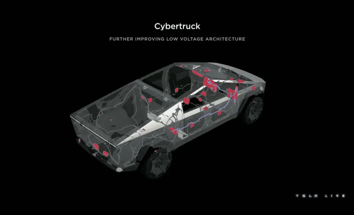

But is there a 12v battery?
Yes. I doubt there will be a 48V battery, it will just be a buck converter from the main pack. They need 12V for the compute module and cameras to run when the druvetrain is off

There's a thread we're we went through the patent. It's a new connectorless 4 core bus system with remote processing units, and that gets rid of most if the wiring length, not just the 48V. Each processing unit would then have a buck converter, or mini inverter motor controller, depending on what was powered. CPU/GPU needs low voltage, (under 2V) and most mainboard power supplies are 12V.
Tesla Cybertruck Powered Frunk In Action! Great shots!! 1698509191949
PS you'd need three of those converters you linked to just to run the computer.

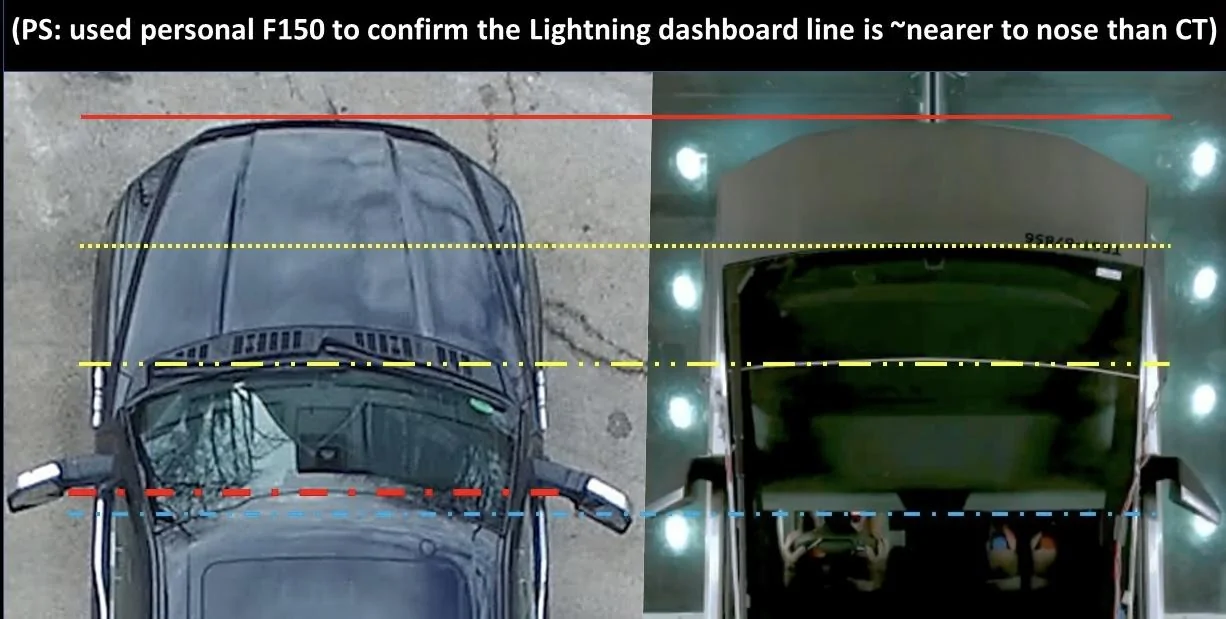

It's the result of shortening the front end for the "it must fit in my garage" crowd.
it’s really not, in a way
the front end is just as short as the Lightning from say, tip of bumper to front axel line. It’s also ~identical to the Lightning from tip of front bumper to dashboard.
the difference in Frunk depth then isn’t in front of the axel line, it’s instead the available space *behind* the Frunk, towards the cabin, and forward of the dashboard. Below been proportionately adjusted to assume CT is ~227”
Tesla Cybertruck Powered Frunk In Action! Great shots!! BC393442-DE4E-4A26-B239-14AD8E9B23C2
and so while in theory, of course, they could have stuck a long nose out ahead of the tires - and had a nose longer than the lightning - but it’s not clear they didn’t avoid that that primarily for crashworthiness/visibility (see eg the Lightning) etc, not for reasons of overall length.
afterall, the lightning is 232” where the CT is 227” … that’s only a 5” delta, AFTER they took 6” off the CT’s original prototype bed length (from a 6.5’ bed to a 6’ bed).
Though the CT manages to still have 6” more bed length, and ~5” less overall vehicle length, which means the CT somewhere loses roughly 11” of total length between front bumper to rear of cab compared to Lightning.
And it’s not between front bumper to dashboard.
Because the CT is just as short as the Lightning from bumper tip to dashboard, that results in there being in theory roughly 11” less length between the dashboard and rear bumper, including and despite the CT bed being 6” longer

People are talking like the truck has a 12v battery, but I thought it was already confirmed that the electrical system would be 48v to save on wire size and weight.
the CT has three voltage buckets.
where an eg Model S has two, eg a “low voltage” (12v) and “high voltage” (eg pack), the CT has 3:
• low voltage (12v)
• mid voltage (48) and
• high voltage (pack)
• low voltage (12v)
And 5v for CPUs
3v for LEDs
20v USB-C outlets...
If the CyberTruck even goes with the 48v system there will likely be many different buses for all kinds of power demands. 48v for everything may make sense someday, it's probably foolish for Tesla to try to ramp up suppliers to 48v EVERY component, at volume, in the truck before November 30th.

This paper appears to be legal 8.5x14
puts Frunk void height at ~16” and depth at floor centerline at 18”
Puts CT Frunk volume at roughly the following footprint, but a ~bit more dramatic height slope forward from the max height at back wall:
or as gone over (to death) before:
about 1/2 to 3/5th the volume of a Lightning Frunk, but the preferred usability of either depending on the need (eg since the shapes are different, they’ll fit different things differently)
