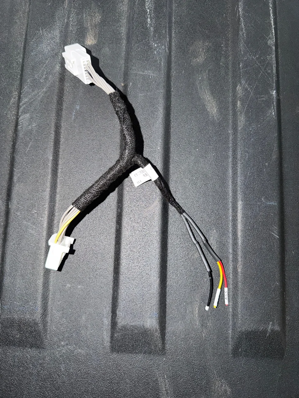

It’s just pulling power.
I’m not sure why the power stays on after exit for a short time. Perhaps its keeping power to the back display for a short time in the event someone is still present.
I posted previously that there are a few unused pins on this harness. If someone wanted they could carefully pull one of those pins out, move the pin to the 8 position, then cut and splice to the(Yellow and Red) wires to get the pin 8 pass through needed for the tweeter audio signal. I really don’t like they tapped this audio line though - otherwise I would have done it.
Here is a picture of where I cut the harness.
Okay, so I just run the power from the new tap location, red and black (tapped to red and brown), to the red and black on the wire to the mirror that you cut off harness? What about that yellow wire?
Yellow and Red go to positive together. Black to negative.
