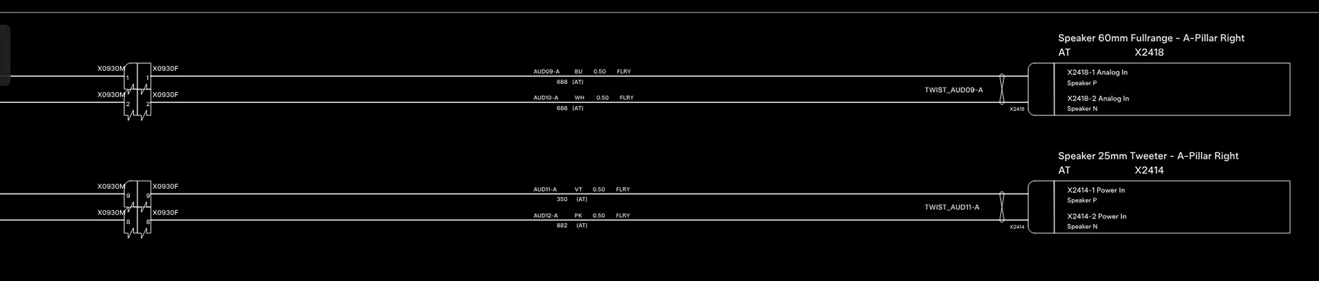

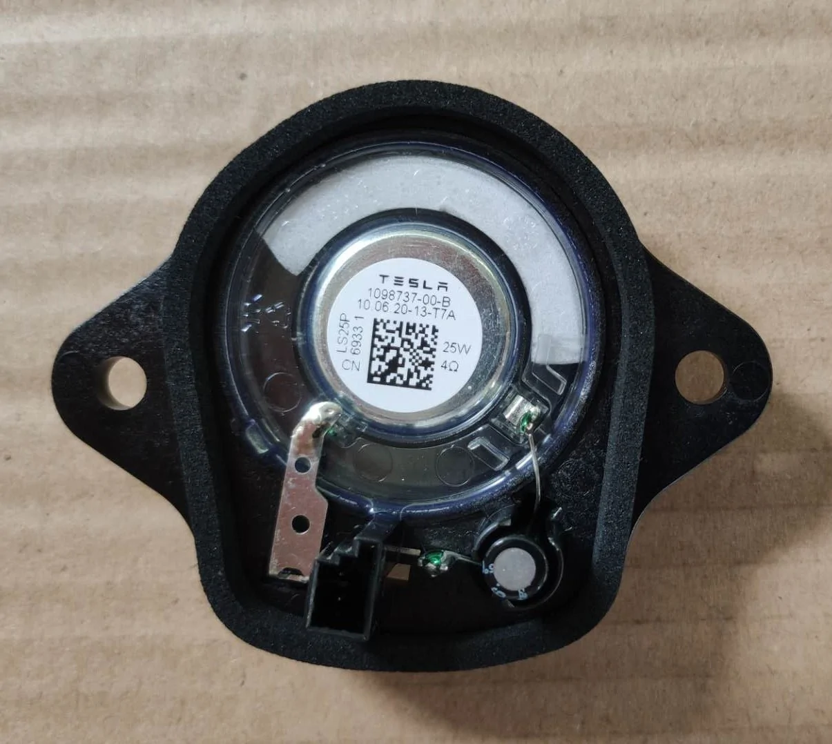

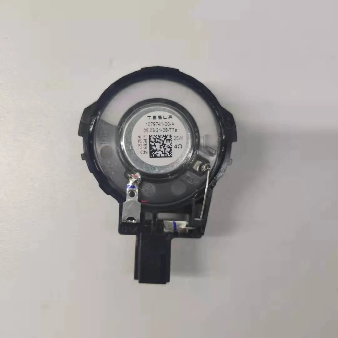

Pins 8/9 are audio to the passive (no internal electronics) tweeter. They aren't DC power sources.
Any voltage there is because the audio amp in the left control module is biased to that potential.
The amp can put out 12V on both 8 and 9 resulting in 0 volts across the tweeter when idle.
Same speaker is used on other Teslas. One thing to be aware of is the description is "active", but the speaker does not have any decoding or amplifier circuitry. That wording differentiates it from the version with a high pass filter capacitor for "passive" filtering.
For vehicles with active filtering in amplifier section:
Tesla Cybertruck Powering Accessories Struggles - Don't let this happen to you! 1079741-00-A_3
For vehicles with full range audio output (base models) :
Tesla Cybertruck Powering Accessories Struggles - Don't let this happen to you! 1098737-00-B_1
Signal designations:
Tesla Cybertruck Powering Accessories Struggles - Don't let this happen to you! AISelect_20260615_063957_Firefox
