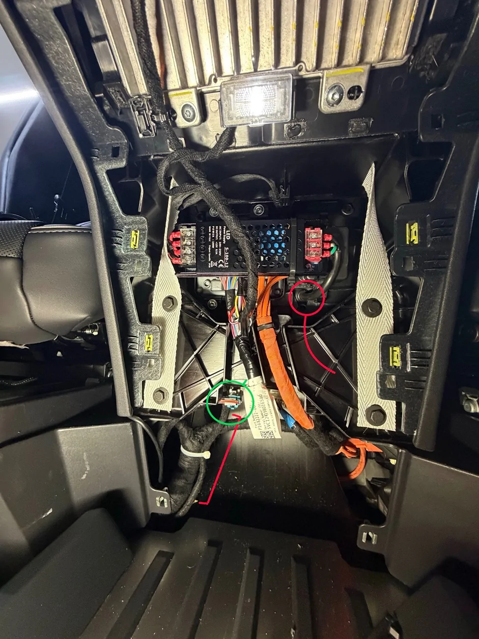

Update:
Went on my first long haul trip with this mod over the weekend. You need to know that when your SOC gets down to 20% the Cybertruck goes into Low Power Mode and shut off all the outlets. For my ride the maximum duration was about 15-20 minutes when I road the SOC down to 7% before a SC stop.
I’ll keep this in place for now.
Would like others input on the 12V source outlined in this schematic:
https://service.tesla.com/docs/Cybe...e/prog-242/interactive/html/index.html?page=6
Follow the trace for the “2nd Row Display” at the bottom of this schematic. There is a 12V supply from the MCU to the 2nd Row Display that connects at two accessible locations. One in the passenger footwell on X0848-1&2 and the other right where I connected this 120V near the front console panel at X0806-1&2. This appears to carry the coaxial digital video signal to the rear display along with 12VDC. I don’t have time to test this out but wanted to share.

Update:
That would be a drag to suddenly have your mirror and radar detector and other accessories go offline when the battery reaches 20%. What are your thoughts on the other 2 locations? Is the footwell location the one we already know about where 3rd parties are currently tapping in or is it somewhere else in the footwell?

If I am reading the schematic you linked correctly then there is a connector - X0879 which has a male and female fitting, pin 1 would be a red wire and pin 2 would be a brown wire representing 12v DC positive and negative/ground respectively, is that what you are seeing? Do you know if those wires and/or the X0879 connector is shown in any of your pictures?

I believe X0806 is circled in Green. Colors Match. Very easy to get to…
Did you get a chance to check this location yet? My garage has been an ice box so I have not had a chance to test yet. If this location works I was thinking of running wires to the passenger footwell and installing a fuse block there with attachment points for all the accessory wires that will need them in that location if I pull apart the harnesses for various items and want to connect them all to a single spot. It also wouldn't hurt to have fuses for each item attached.
If this spot is the place to tap in then the question becomes what way would you tap in? Is there a way to get some sort of connector for this location or would it have to be a wire tap?

I looked at digikey, mouser and others for this Rosenberger automotive fitting but no luck. And even if I found it I need to get the right coax wire and all the special crimp tools to make a nice butt splice. I have some posi-taps on the way. Those are the least destructive way without cutting a wire but will not look great. Will not have time to dive in until the weekend to tackle this. I have a small fuse block as well with some busman 3A fuses.
BTW the other end of this wire connects with the same fitting at the footwell area you’re trying to get to. Click on X0848 and you will see it appears to be just below where Hansshow was tapping in.
