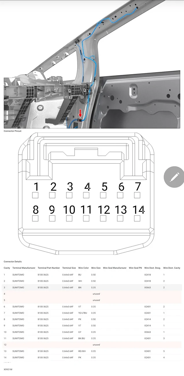

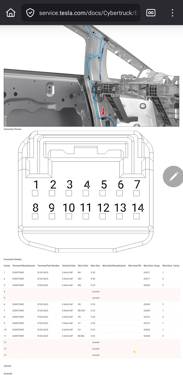

Driver's side is the same connector with same connections, but doesn't have the second set of A2B connections on pins 13/14.Does the drivers side connector also not have power wires but the same A2B bus as the passenger side? The Hansshow LED Dash light strip ( ) has a secondary wire that plugs into the drivers side port that looks to be the visual equivalent of the passenger side port. I will get you some photos of the connector ends and I have a continuity meter in my toolbox somewhere...![]()
Loss of tweeter might be a software decision due to the A2B bus failing versus the tweeter wires being disconnected.
