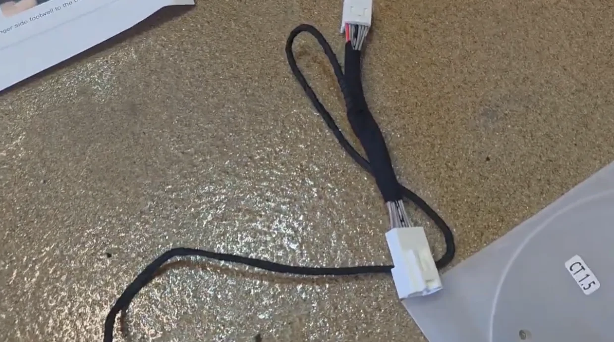

I don't need any pics personally, if there are 5 missing pins it's probably set up for driver's side.
Beyond that, if pins 8 & 9 are routed through correctly, then the tweeter should work.
Sadly I don't think they use the same color coding for the wires so I would have to pull the harness and put a continuity tester on pins 8 and 9 on each end and see what I get...
Yah, or all the same color...
Just info for the next time you dive in.
I just published the Light Strip article here : LED Dash Light Strip by Hansshow
and there is a pic of the power connector in question before I installed it if that help, obviously testing it with a continuity tester is what needs to be done but I thought you might want to see it.

I just received my V2 Rearview last week as I was planning to upgrade from V1.
I used a continuity tester and rang out the harness and all wires ring through except pin 8.
The female side of the connector has a yellow wire but it does not pass through to the male side pin 8.
Pin 8 in the Tesla diagram is listed as "Speaker 25mm Tweeter - A - Pillar Right".
Pin 8 ties into the Hansshow harness to both the ACC & BATT+ wires.
Pin 11 is tied to GND.
The Hansshow tranformer is listed as DC12 - 24V input, Output DC5V, 2.5A.
Problem is not fixed yet.

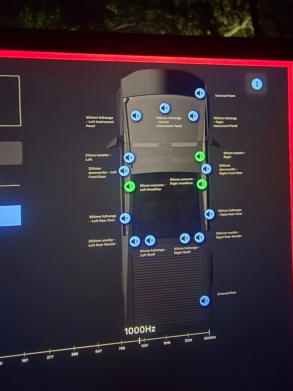

Went through the thread. Impressive! I just need somebody to produce an A2B compatible Y-connector that can be daisy chained into the car and I can plug my rear-view mirror (from Tesstudio) into it (and not use the daisy chain capabilities of the harness provided).
So, does anybody want to make a business by selling these Y-cables? I'd be happy to buy one (or more)!
I've just tested and I have 3 mute speakers since I installed the mirror and I have not even realized it! 😡
Wow, I didn't test all the speakers, just the ones @TeslaKen showed in the video. I didn't think it would affect others too. This is a pretty shitty thing to do to your customers.
