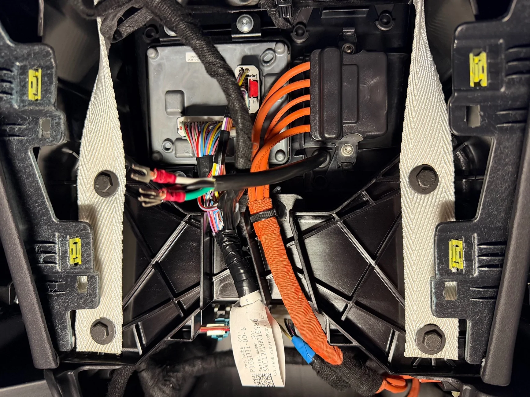

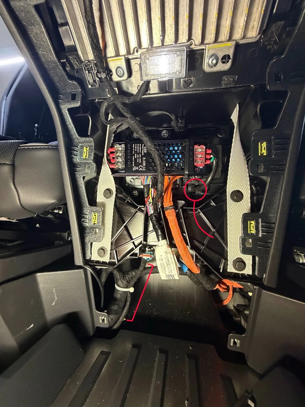

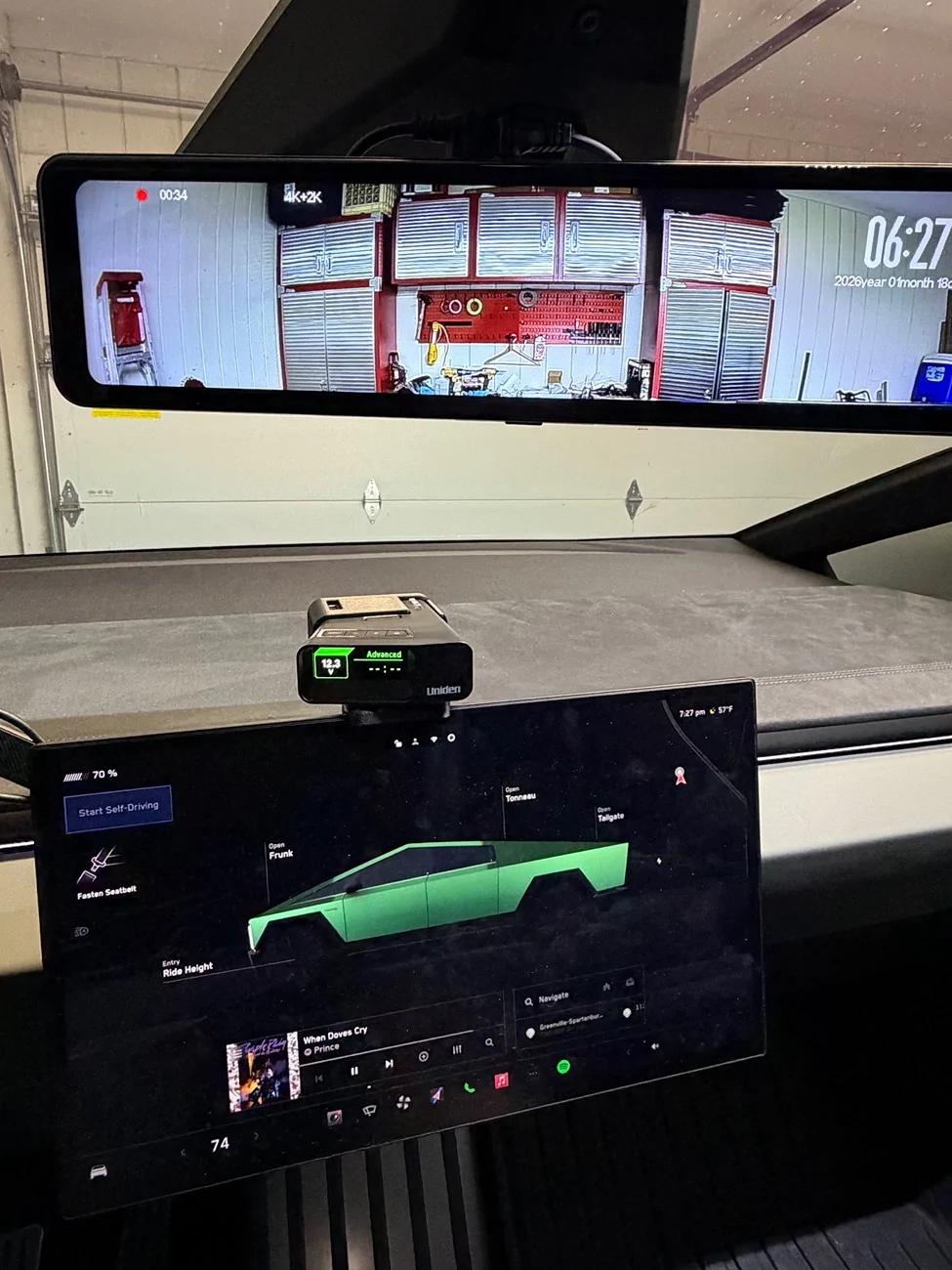

I’ve completed a 12V DC supply solution that works for me.
I routed a 12VDC supply line to the passenger foot well for the Hansshow V2 mirror and one behind the screen for a radar detector.
Works perfectly with “Enable Cabin Outlets on Entry ” selected. The power comes on when you enter the vehicle and goes off when you exit.
Fairly easy project that solves the 12V DC supply issue. Front console panel pops off easy to give you access to run a line to the 120VAC outlet. Note that the power to the outlet is available, orange wires, but I didn’t want to mess with splicing those and found a nice pass through outlet that works fine. The console bin is made of a soft rubber but I still added a grommet to make it look neat running from the outlet.
I moved the radar detector from a mirror mount to just above the screen. This doesn’t obstruct the view out the windscreen at all. I posted the link to the mount I used.
I cut the Hansshow harness off and spliced the USB-C power lines to the 12VDC supply line. In the event I add anything new I have a small 4 line fuse box I can add here for future upgrades.
Parts for reference:
Pass through outlet: Cable Matters 2-Pack 2 Outlet... https://www.amazon.com/dp/B09DMRWYX8?ref=ppx_pop_mob_ap_share
12 VDC Supply: LED Driver 12V 100W 8.3A Slim LED... https://www.amazon.com/dp/B0CWWM7DS5?ref=ppx_pop_mob_ap_share
Radar Mount: Bartallama3D Radar Holder for... https://www.amazon.com/dp/B0DJZYF7XX?ref=ppx_pop_mob_ap_share
Very nice work. Could you show with a marking of some sort where the pass through outlet is? Where did you wire the AC side of the converter? Also, what drove the choice for that specific convertor over the 300-400w ones? Size?

Where to cut the Hansshow harness: Follow the USB-C plug down past the small box (12V to 5V Converter) and you will see they have the wires already labeled. Three wires are loose and unbundled near the end. Cut and Tie both the ACC(yellow)and Power(red) together - twist those together and use a butt splice crimp to tie that to the 12VDC positive. Tie the GND(black) wire to ground. I ran two sets of 12VDC supply lines from the converter - both wrapped in felt tape to match the other harnesses. The pass through spot I used is outlined in the red circle. There is just enough room here to pass the wire through neatly.
There is enough room to run the wire up the center divider. You can tuck it in under the plastic molding then run it up under the rug to the right foot well. I spliced the Hansshow mirror at the footwell location like it was originally intended.

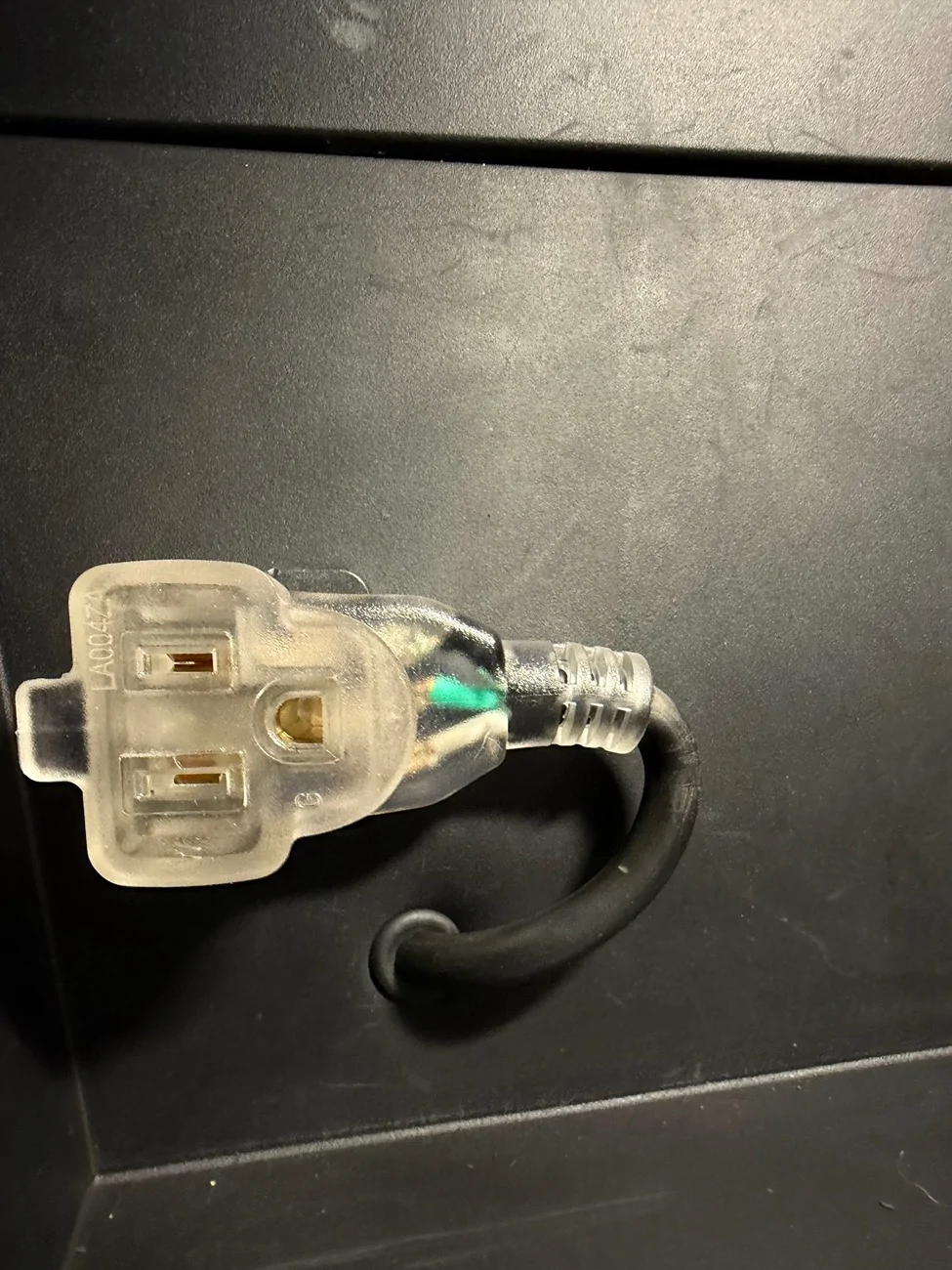

This is brilliant Jack. I’m just not fully understanding where the wires going into the 120v side of that convertor are coming from.
Chopped off pass through power cord in the first photo:
Thanks. Was thinking of maybe reproducing this with the input plug of this thing I have plugged up to the center console 120v socket

Thank you. Yes I saw where you tapped through to get the plug into the center console and then the wires coming from the plug to the convertor, I was more wondering about the wires coming from the convertor to the rear view mirror and/or other accessories. I suspected that perhaps you ran in under the plastic in front of the center console then up under the dash and over to the passenger footwell. With respect to the Hansshow harness once you cut the wires and attached them to the wires coming from the convertor, was there any need for the Hansshow harness anymore or did you pitch it? I was thinking of running the 12v DC power from the convertor to the footwell and attaching it to some sort of distribution block with black and red pins that I could then attach whatever accessories I wanted there assuming I don't go above 100w which I believe to be unlikely with these electronic devices we are discussing.
Such a shame that Tesla didn't think to have some 12v DC power adapter plugs in various locations in the truck to support non 48v accessories. Extra cost I guess but I don't see the automotive accessory market moving to 48v any time soon...
If you have any pics of where you tapped in at the passenger footwell or any routing pics please feel free to share those as well. Thanks again!
