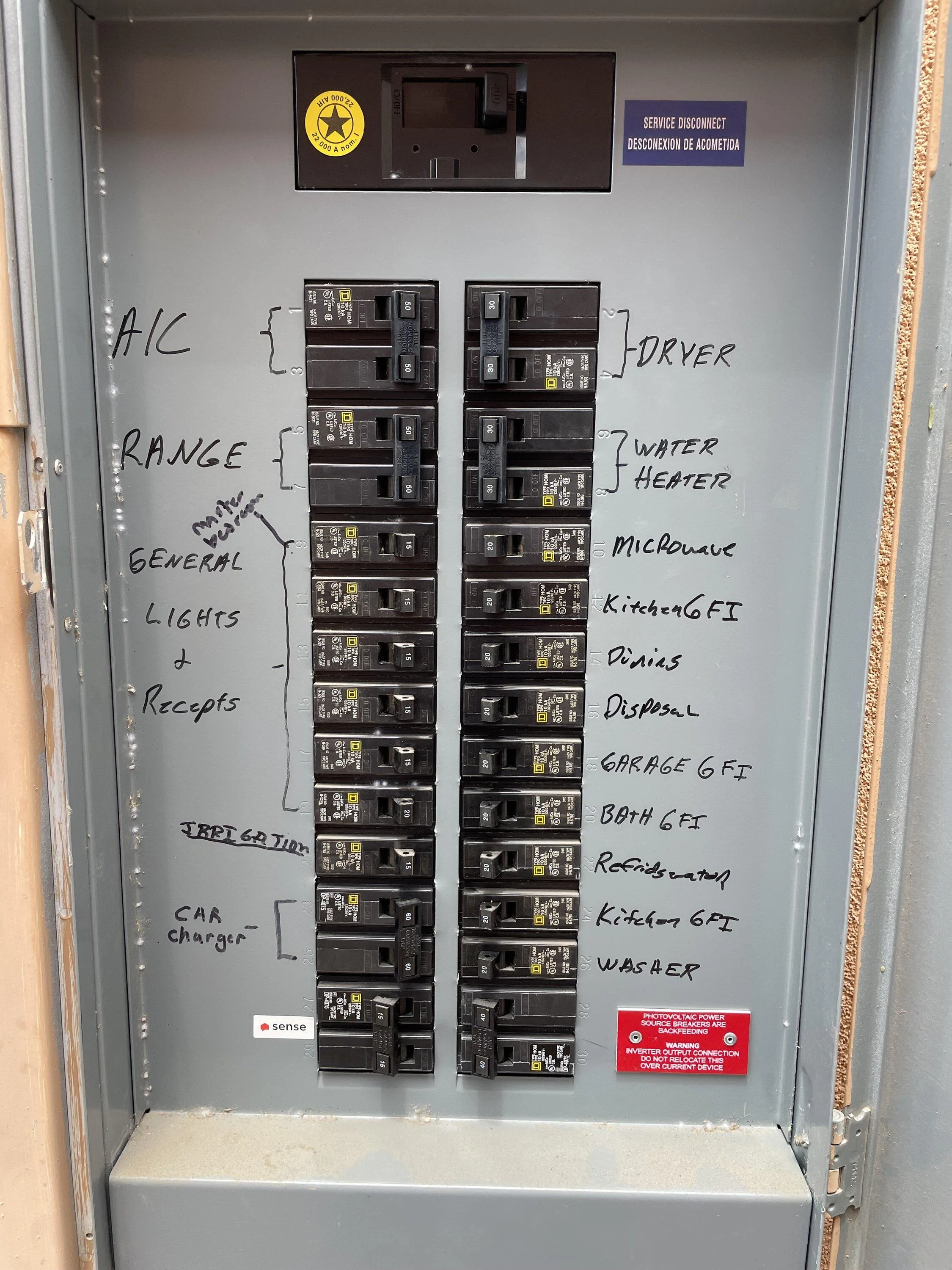

The panel that I was referring to was the power distribution panel. Upgrading a 100A panel to a 200A one is far from trivial and requires new power lines from the street.
I thought it was the same thing we’re talking about. This is my panel.
I guess we were talking about the same thing, but it is really hard to believe that the electrician would upgrade for free.
Of course there's always the possibility that you'd get the new panel for free. His installation charge would be north of $2000 though.
If you change that top breaker, you tend to have to get the service into your house increased, and there have been numerous examples of the power company not allowing it.

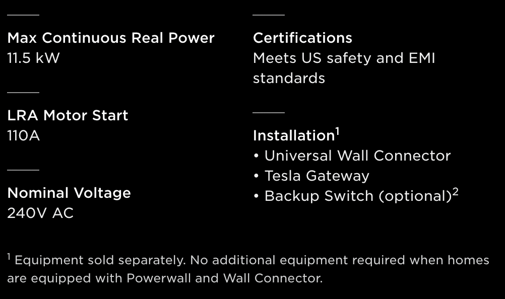

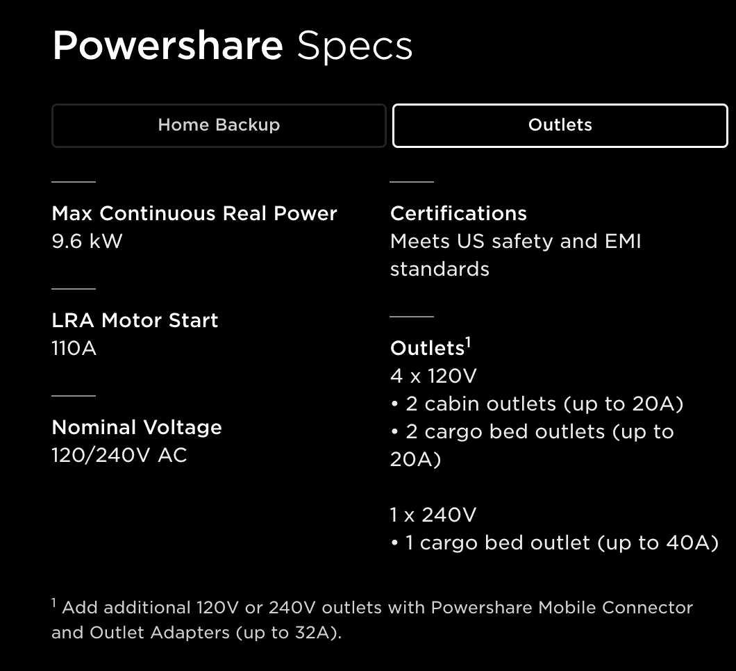

Did we already know about the outlet adapters that can go on mobile powershare connector? to add additional outlets.. It's possible they were just referring to the different adapters to charge at different plugs? But that is a weird way to put it if so. I am imagining my mobile powershare cable going from my 110 outlet to a little box that has a bunch of them on it lol idk. could be 220
Tesla Cybertruck PowerShare availability for foundation series buyers. 1705619958993
Also, were we tracking that people with powerwall and wall connector dont need to upgrade anything? This one feels like we knew that but idk.
Tesla Cybertruck PowerShare availability for foundation series buyers. 1705620009014
If you have powerwall you should hop on bestbuy and get the UWC lol (I think they had it)
I assume that you are talking about the very last line?
I think that there have been pictures of it flash during videos, but quite sure.
I believe that there have been statements of how easy it is to hook to existing PowerWalls.
But I think that there's some semantics that are getting missed, even by Tesla when it comes to the wall thingy. It seems as if there is a PowerShare Wall Connector as well as the existing Wall Connectors.
But details are yet to be seen.
