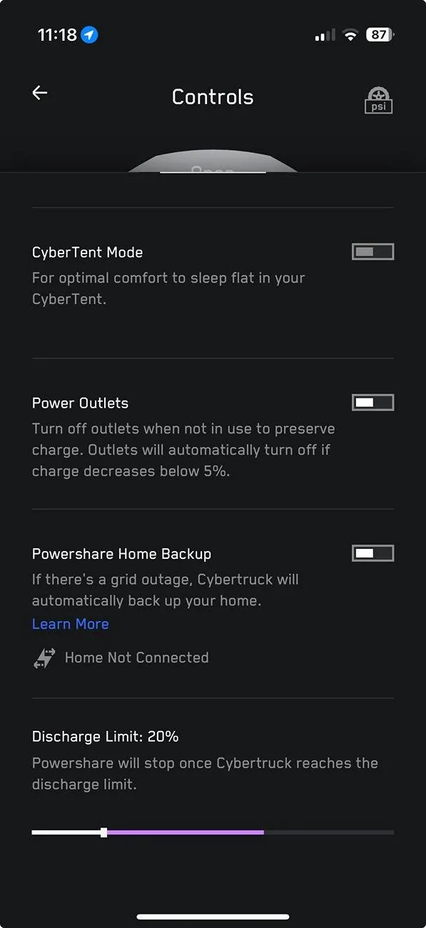

I definitely do not have Powershare and it looks like it's just a toggle in the truck or app, here is the app view. So if you can access the Controls panel or have app access for a demo drive I think you can flip the switch.

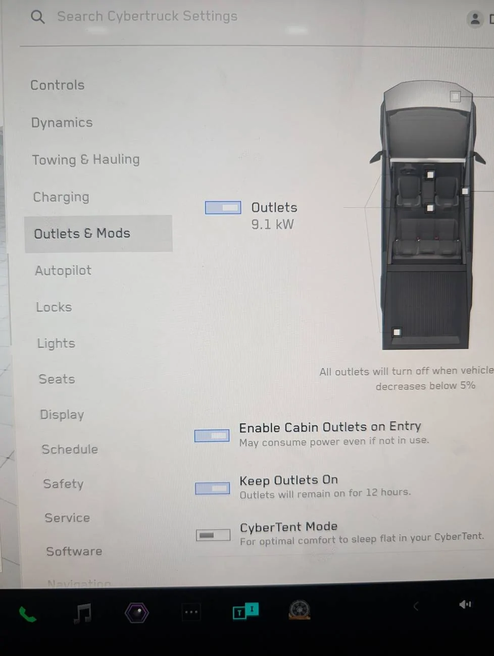

Do truck outlets all work ok?
Testing was done by both methods. Largely by pulling the master breaker. The app results in the same.
The truck passed the outlet test. It is able to charge our plaid on all three outlets. NIce! I have never tried that!

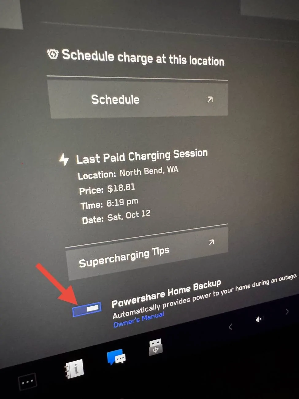

You have this right?
Tesla Cybertruck Powershare fails in Utah. Looking for CT owner with powershare. 1749753984240-2
116
8,375
9,629
Yep. That’s what they had me switch on when I called them. Didn’t realize there was also something else they had to do. Is that accurate?
