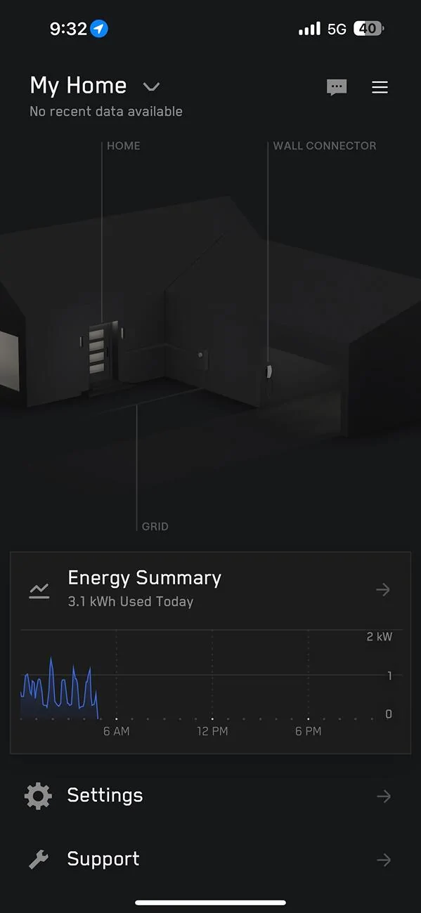

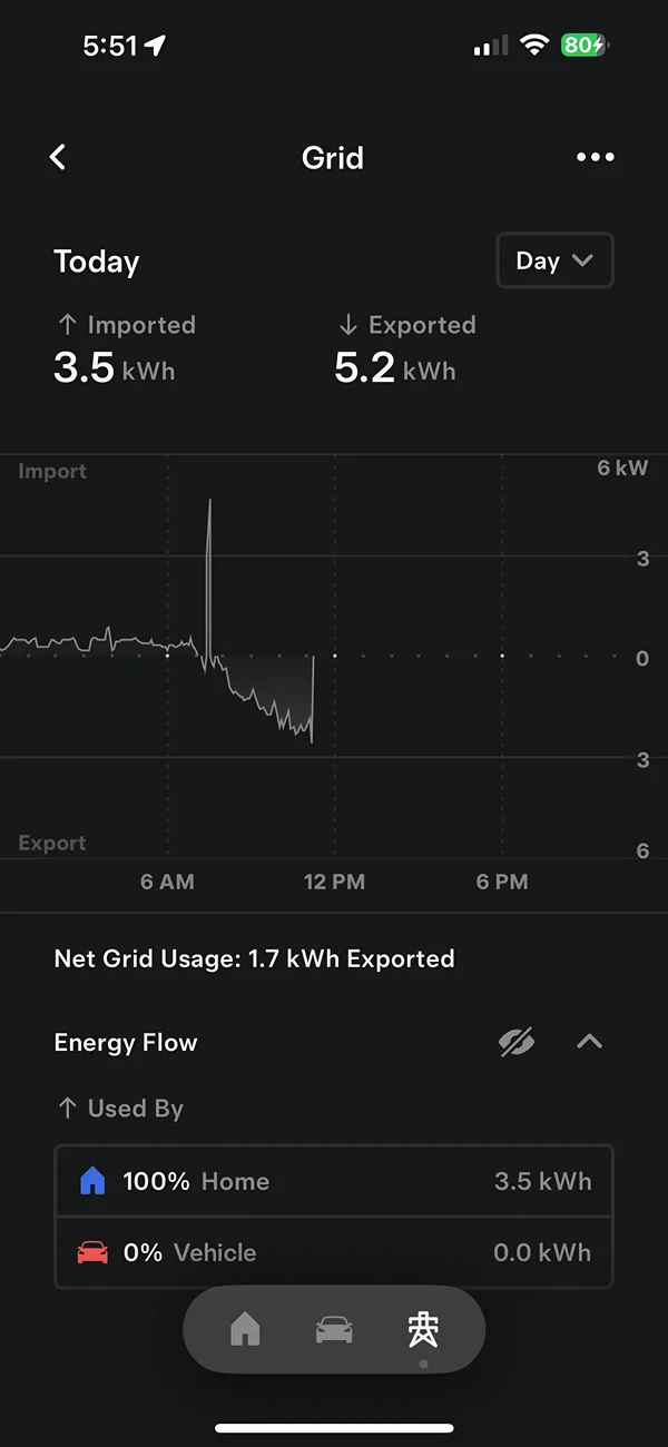

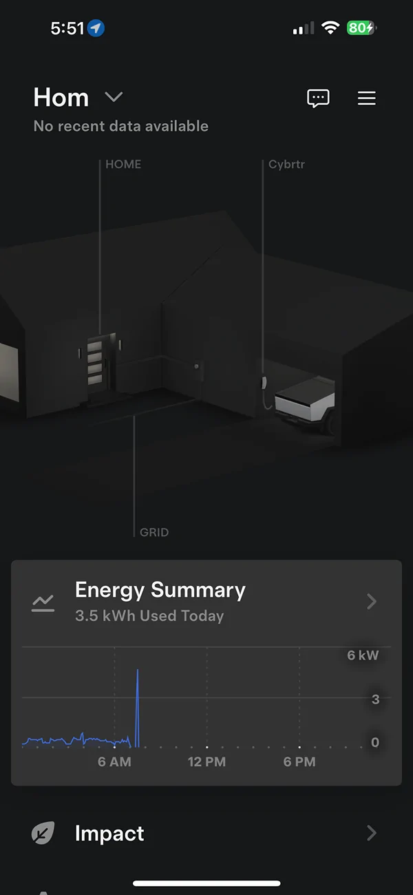

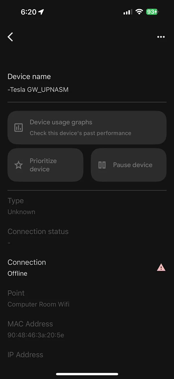

I have Gateway offline issues on my system as well (purchased CyberTruck Foundation Series which included gateway). Installer came out and worked with Tesla to diagnose and ended up replacing the entire gateway with a new one….and now the problem continues…very frustrating!
