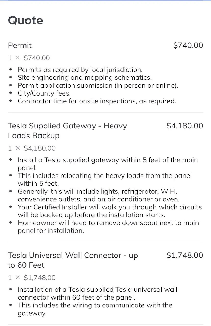

This appears to be for a relatively small location, probably with a 100A Service panel. Specific loads are not required to be moved.

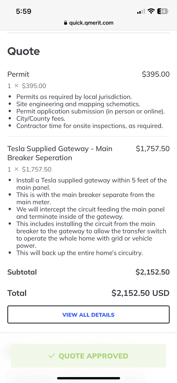

I read it multiple times and didn't see the Powerwall 3. Is it on another page?
Instead of listing and pricing it as an item they placed the Powerwall 3 in the Labor section.. Poor invoicing on their part led to a strong emotional reaction on my part ?

It really helped to get other eyes on my quote. I missed how they added a Powerwall 3 in the tiny print ?
After some thought, I think I do want that and 10k out the door for it all seems fair.
Adding a Powerwall makes a power outage transfer milliseconds instead of minutes if I understand correctly. Plus a multi day outage scenario means I can unplug and drive till I find a Super Charger that works while the Powerwall keeps the home running.
I accepted the quote and am in a scheduling queue..

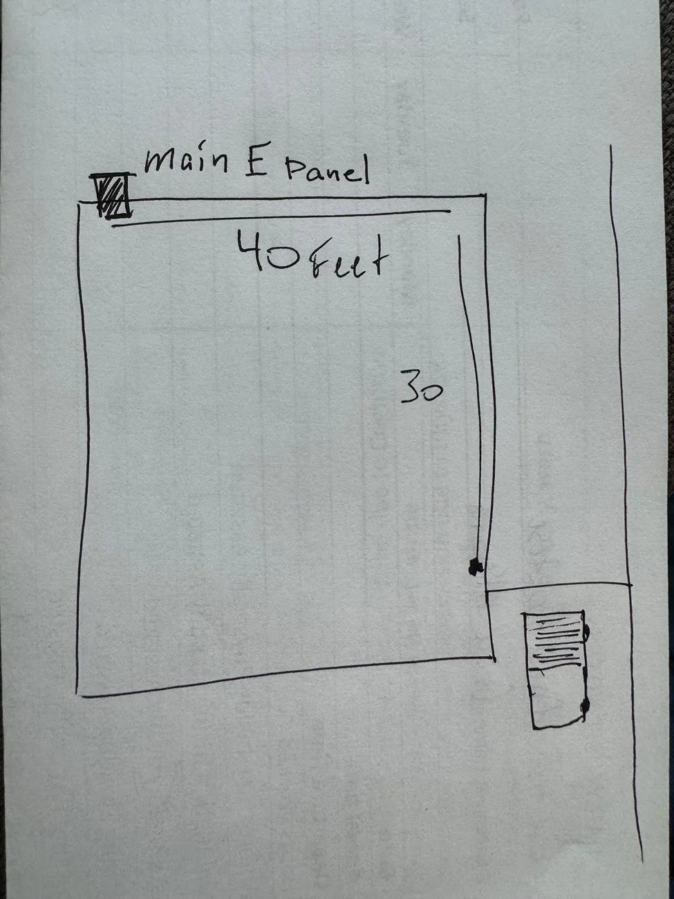

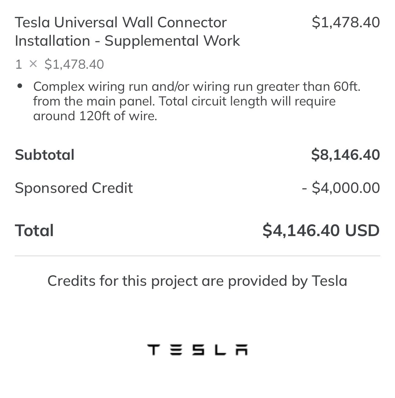

I live in San Jose area and finally was assigned Installer company. Today I recieved their quote for a total of 8,146 dollars. I have 4,000 credit so final pay is $4,146. This looks ridiculously expensive. My panel is in the back of the house an ill have park the truck in the driveway since I don't have a garage.
Looking for some advice, I know being in the bay area I should expect to pay more than average but this looks extreme.
