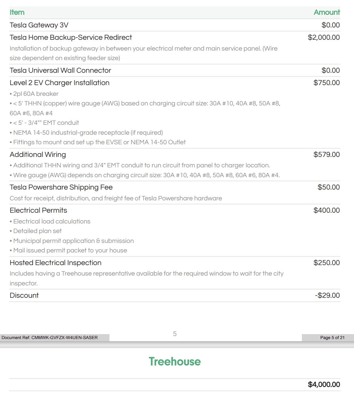

4600 installation quote here. Still waiting on a voucher to purchase the equipment.

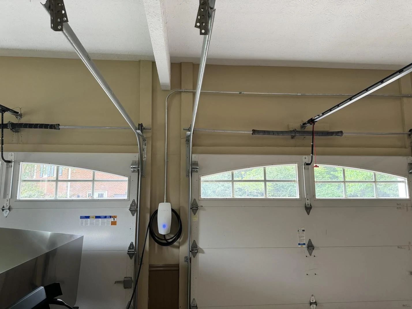

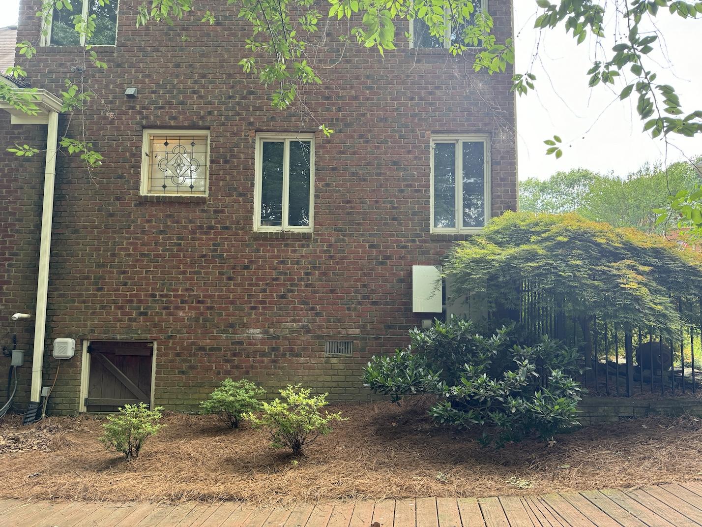

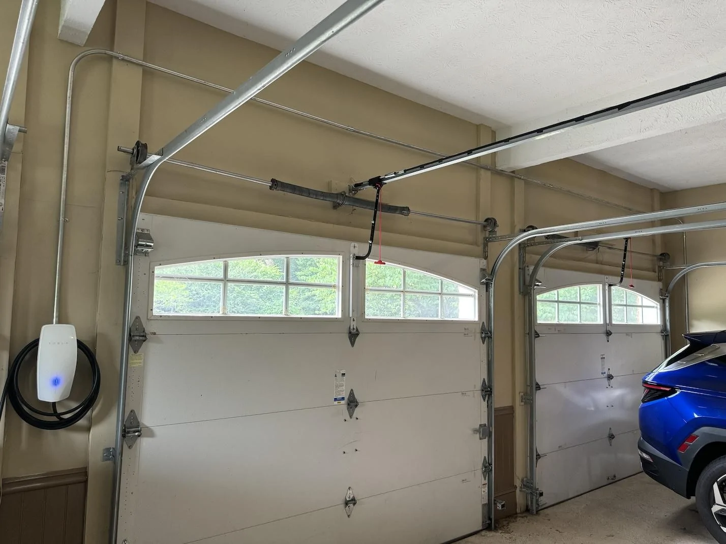

I had mine installed last month, the hardware was sent directly to the installer. The total cost was $3650 for the installation of both the gateway and the UWC, which seems very reasonable for the amount of work they did.
The PowerShare gateway is attached next to the mains on the rear of my house, and the UWC is in the garage from a new pull under the crawl space and run up over two of the garage bays, so it sits pretty much right next to my charge port when the truck in in the garage.
Excellent work, and I've already had a PowerShare real-world incident that went exactly as expected.

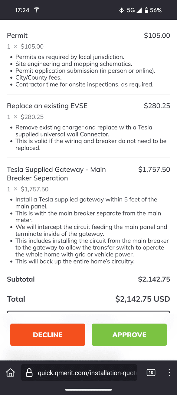

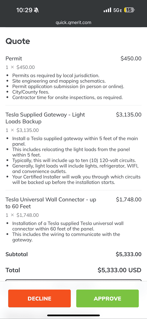

Instead of waiting for Tesla, I submitted a request on qmerit and I got the quote back today.
the total is ~$5300 including $450 permit, ~$3100 power share installation and ~$1700 uwc installation. The project is pretty standard and I don’t see they mention anything special in the quote. In comparison, my buddy got a Tesla installer for wall charger last year only cost a bit more than $1000.
I was hoping my CB’s $4000 credit should cover the total cost of pretty standard installation, but this quote is still a lot more than that. What is everyone else’s quote? Am I able to change an installer other than the one qmerit immediately assigned to me? I am in Austin.
if the $4000 doesn't cover it, I dont' want it.
