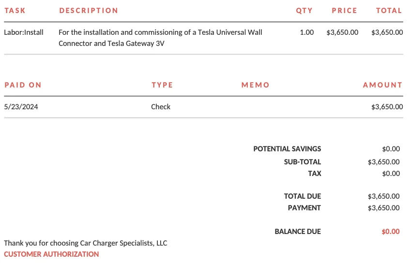

I paid $2600 for install of gateway and charger. No reason to be hostage to this particular company. I usually use Yelp to get multiple bids for jobs or I suggest you reach out to Tesla for alternative qualified company. They have an email for problems, I'll send in follow-up message

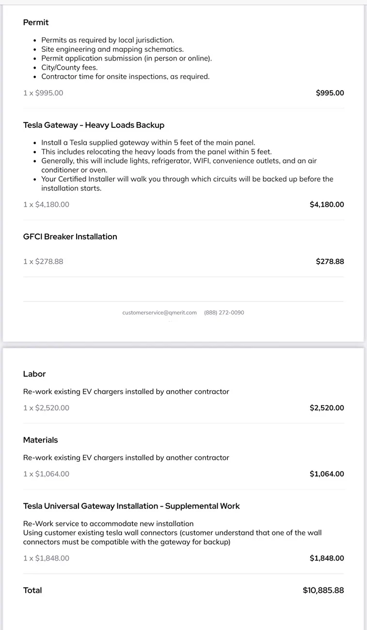

Mind you I already have 2 Tesla Universal Wall Connectors installed by a certified electrician and QMerit wants $10,885.88 to Install the Gateway which cost me a separate $2500.
Basically without Qmerit whom works with a local electrician we have no other choice correct?
Also is any of this eligible for the 30% Fed Tax Credit?
Sorry for so many questions this sticker shock is unreal!

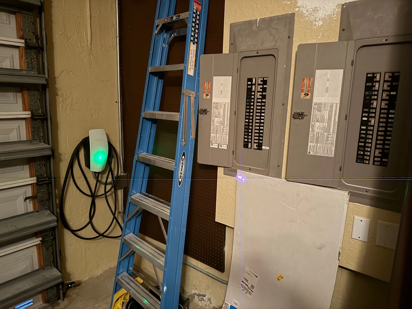

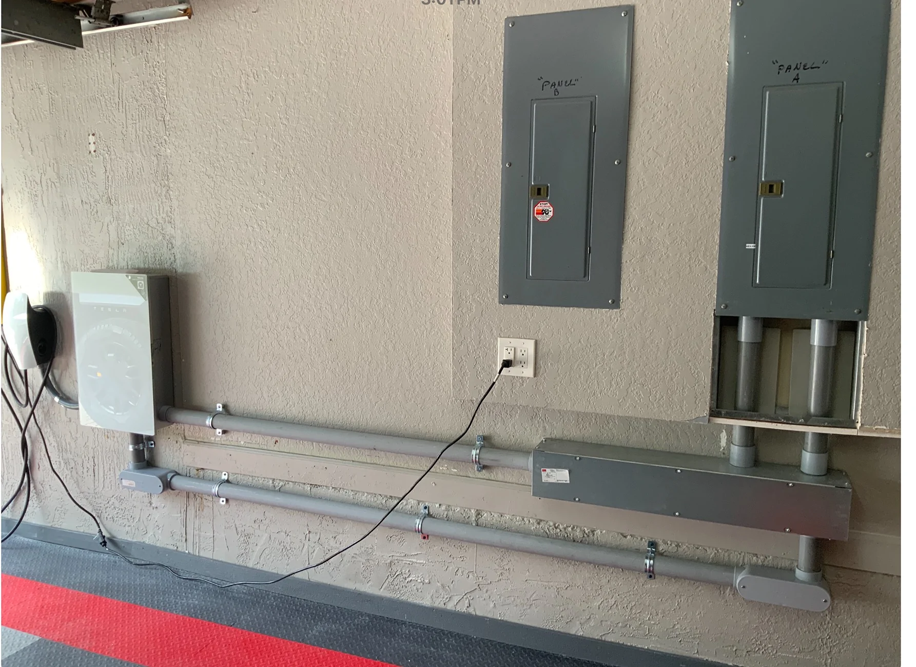

Do you have 2 HPWCs setup to load share? I assume that EMT is continuing on to something else further down the circuit? As long as that is #6 THHN in that conduit, that's sufficient for Powershare. You might need to run it separately from a 2nd HPWC (if that's what it is), since I don't know if load sharing on the UWC and Powershare are compatible.
Looks like your setup is otherwise similar to mine, 320A service split into 2 200A panels? Did you choose the Heavy Loads Backup install option or did they? Your panels look to be a mix of both high and low loads, buy my install is mostly low loads in 1 panel and high loads in the 2nd, so I had them go with the Main Breaker Separation install, which makes my 1st 200A panel a sub to the gateway. Since my 2nd panel had mostly the loads I didn't want backed up (minus the fridge circuit I had moved) it was a no-brainer. If you have a mix of loads from both panels you want backed up, the heavy loads backup might make sense, but I have no idea why it is so much more expensive than the main breaker separation install.
