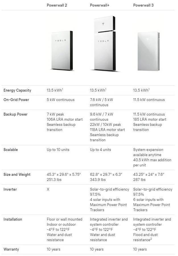

Tesla Cybertruck Powerwall and CT Powershare G-3V default energy prioritizing Powerwall spec and features - tabl

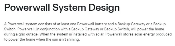

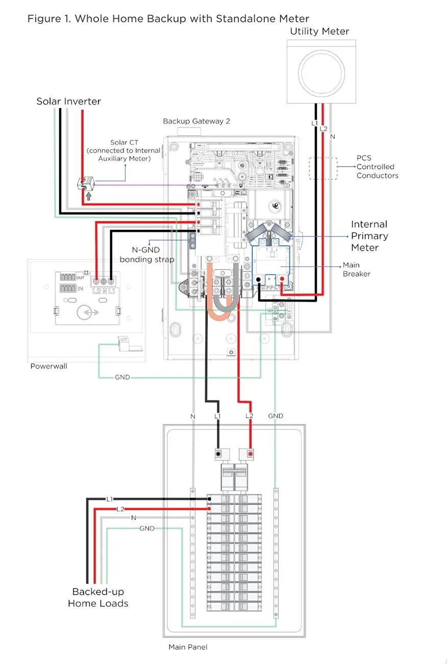

Tesla Cybertruck Powerwall and CT Powershare G-3V default energy prioritizing Powerwall System Design = Battery + Gateway (grid transfer switch)

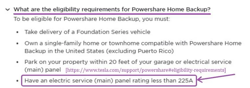

Tesla Cybertruck Powerwall and CT Powershare G-3V default energy prioritizing 225 amp or less main panel requirement - FAQ Tesla Powershar

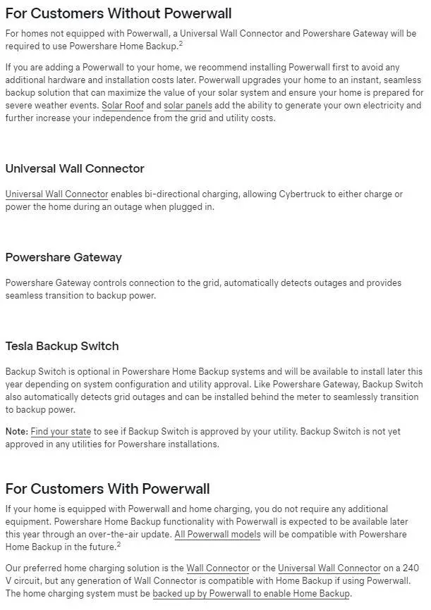

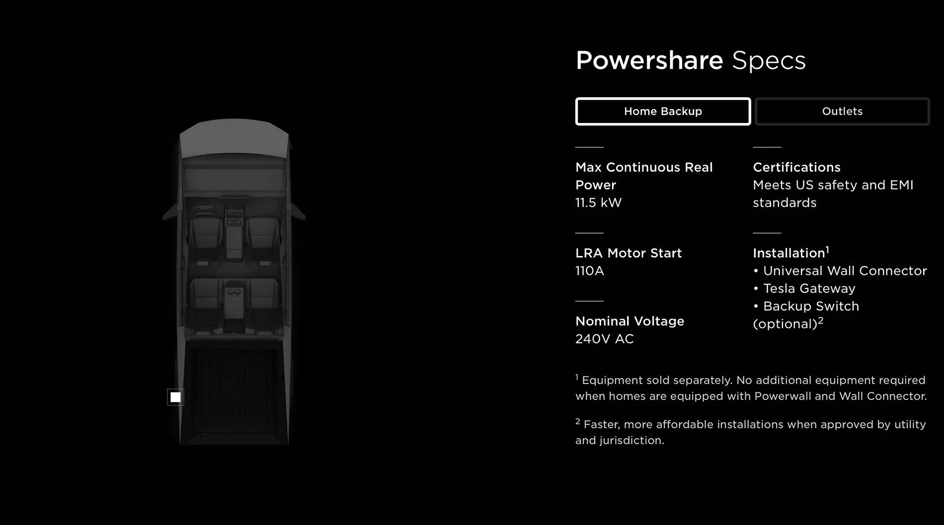

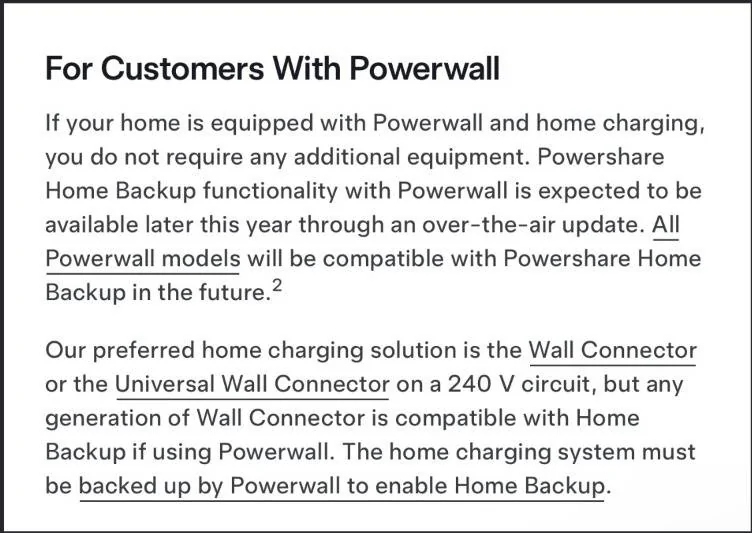

Gateway 3V is not for homes with existing Powerwall/ Gateway installations. On those setups, Cybertruck/ Powershare will backfeed via Wall Connector once Tesla releases the software to enable that (no one has it yet).
For a new build where you plan on having Powerwalls, Tesla recommends doing that installation first as the Gateway 3V has a site controller which becomes redundant once the PW are installed. This complicates PW installation.
If you are doing a generator backup also, the recommended configuration is grid -> Gateway/PW -> Generator ATS -> backed up panel. This kicks the generator on once both the grid and PW are discharged.
Powerwall only kicks in as fast as Gateway switches over and reaction time also depends on previous state (charging vs discharging, solar...). You shouldn't count on signal digit millisecond recovery if you have critical loads.
Thank you for taking the time to provide those details.
a) So Cybertruck Powershare Home Backup is two flavors
  1. UWC|WC + any Powerwall system (Powerwall battery & gateway [island/site controller])
  2. UWC + Gateway 3V [island/site controller]
b) My overall question/goal is during a power outage and I am islanding ... to have the Cybertruck provide power whenever it is plugged in and leave the Powerwall(s) as full as possible. This seems like an obvious prioritization to me as the CT is ~10x the kWh and you may need to take the CT to do errands or go to the Supercharger to charge up. Am I missing something with this goal / thought process?
I guess we will find out how #2 above works "later this year".
c) The "Generator ATS" example you provided doesn't meet my goal (it doesn't seem).

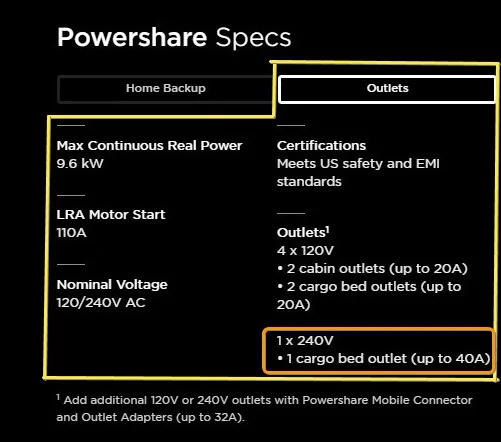

d) I'm wondering if there is a way to meet my goal using Cybertruck Powershare Outlet? It might not be automatic tho. ie. manual transfer switch (MTS vs ATS).

Tesla Cybertruck Powerwall and CT Powershare G-3V default energy prioritizing Powershare specs - outlets only
a) yeah
b) #2 yep, to be seen how it works (guessing Cybertruck usage gets prioritized because PW are made for load balancing)
c/d) can use 40A bed outlet with manual transfer switch or *maybe* two gateways in series, one for PW, one for Powershare, but only if b) doesn't meet your needs.

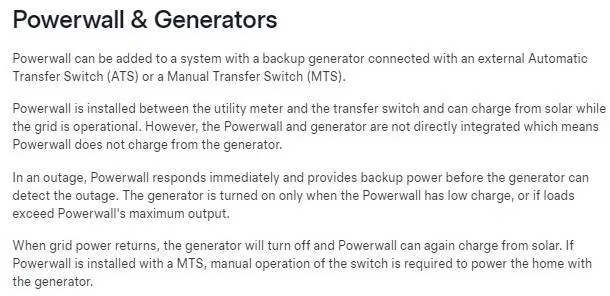

Heck, I was hoping that I could do this:
grid -> Generator MTS|ATS[CT,etc] -> Gateway/PW -> backed up panel
eg. PW is used when grid or 'Generator' (aka CT or similar 240v power source) is OFF
and PW is charged when grid or 'Generator' is ON. I noted that on the Gateway v2 or v3 it says "overcurrent protection device" range is 100-200 amps.
I see what you said is defined on this Tesla page in the 2nd paragraph as well:
Tesla Cybertruck Powerwall and CT Powershare G-3V default energy prioritizing Generator and Powerwall
Yeah, I think the root issue is that the generator's voltage and frequency output isn't regulated well enough for Powerwall to happily charge from it.
The overcurrent range is for the optional main breaker in Gateway when used as the service disconnect.

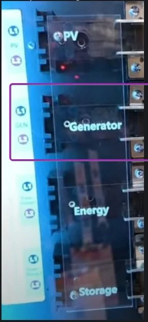

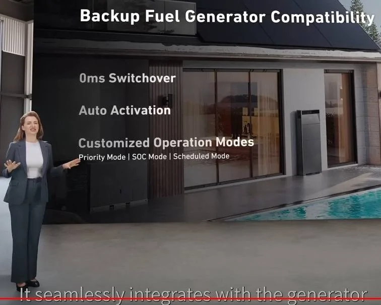

Sounds like Anker Solix X1 will support a dedicated generator input to charge back up their battery and run your house.
Tesla Cybertruck Powerwall and CT Powershare G-3V default energy prioritizing DjgXkp6
Tesla Cybertruck Powerwall and CT Powershare G-3V default energy prioritizing Back up generator ## Anker SOLIX X1 Launch Event - YouTu
