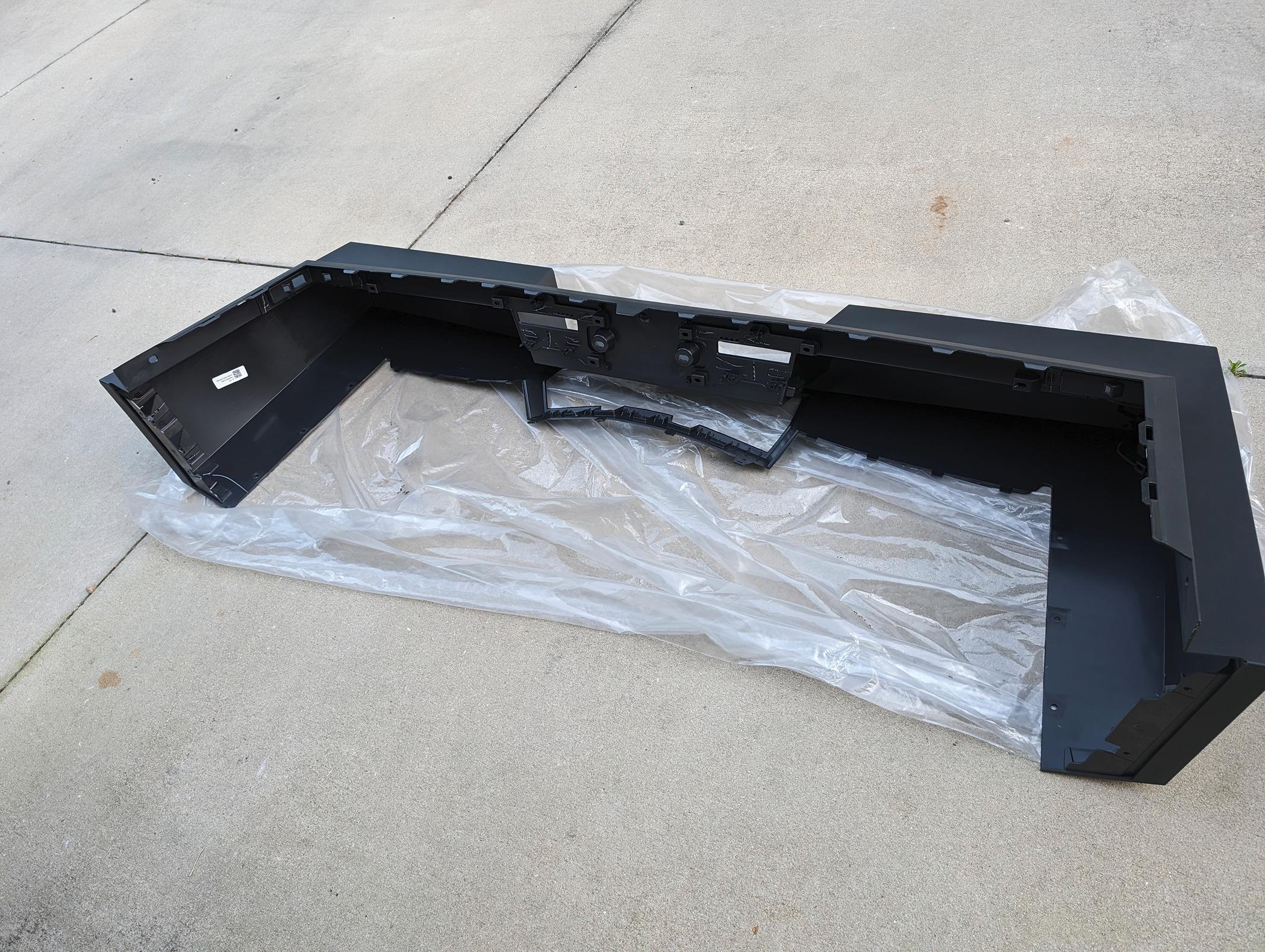

I was able to get the part ordered from our local Tesla approved body shop. Thank you Hendrick Auto! About $600 after taxes, etc.
The part fit in the back of the truck with the Tonneau cover partly open to accommodate the dimensions.

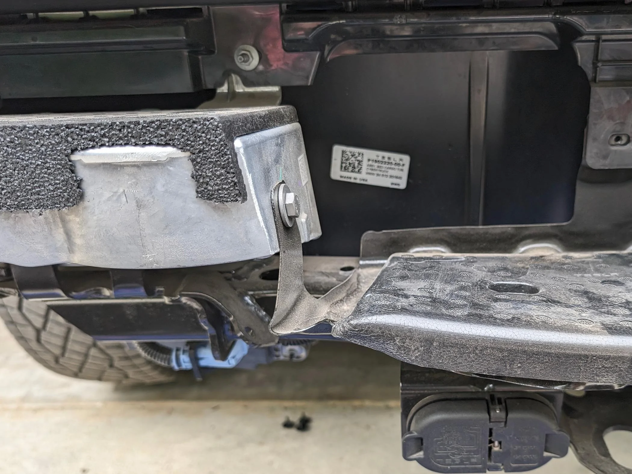

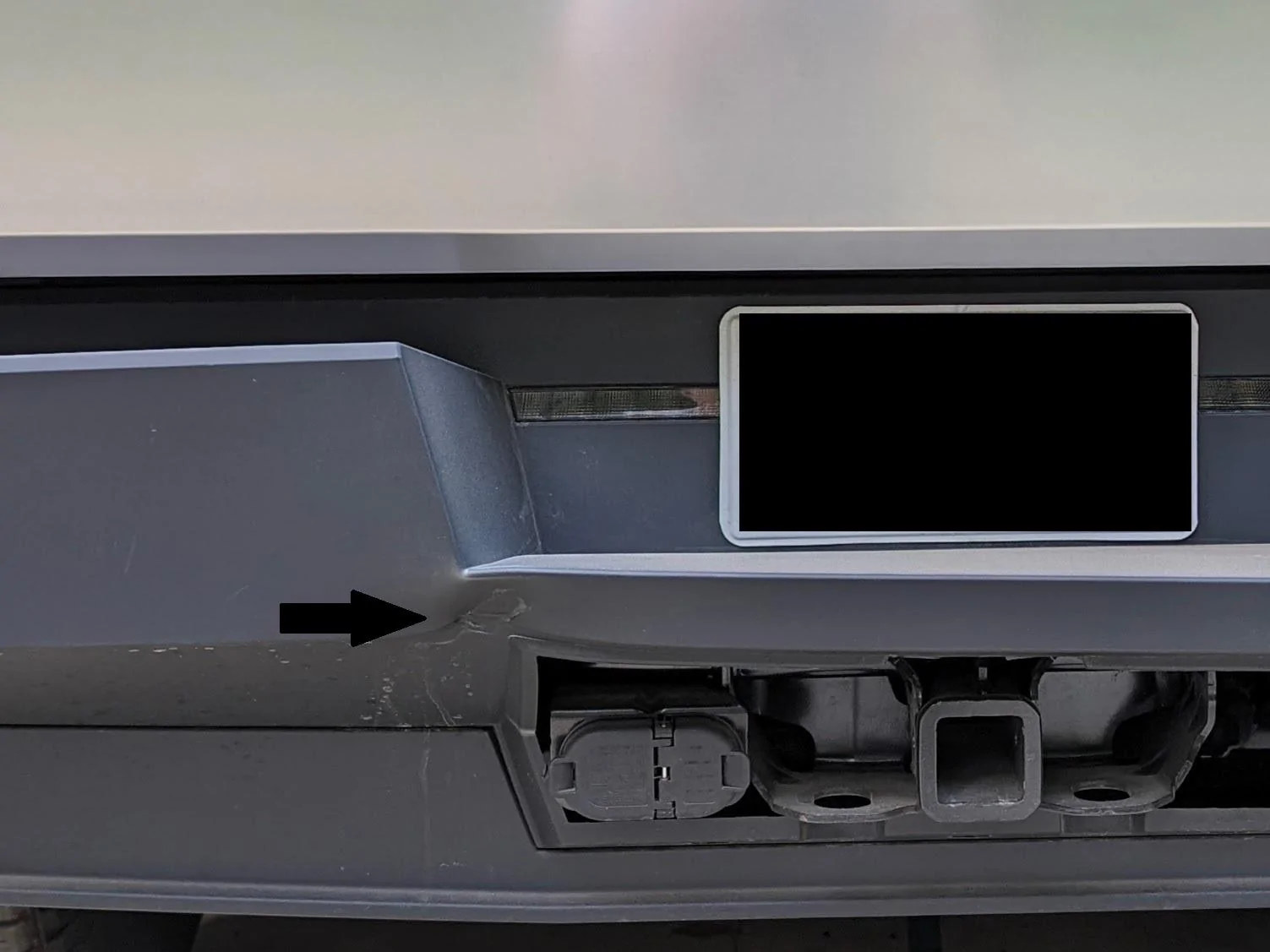

Found a bit of additional damage to a metal part (shown in one of the pictures) but was able to remove it and coax it back into shape. I don't think it creates a safety issue. Only meant to support the 'step' below the license plate.
(The damage - See original post for how it happened)

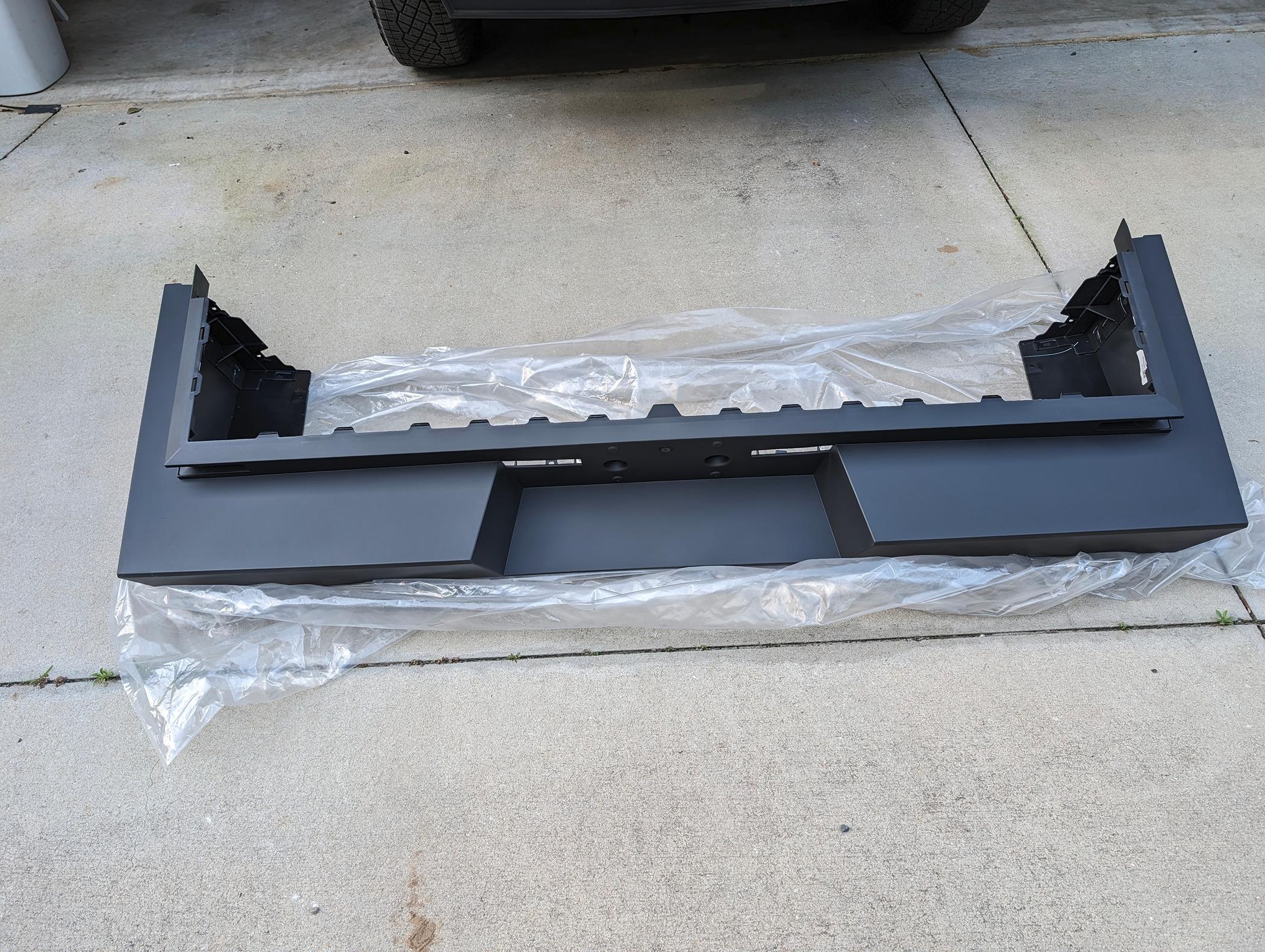

(The Part)

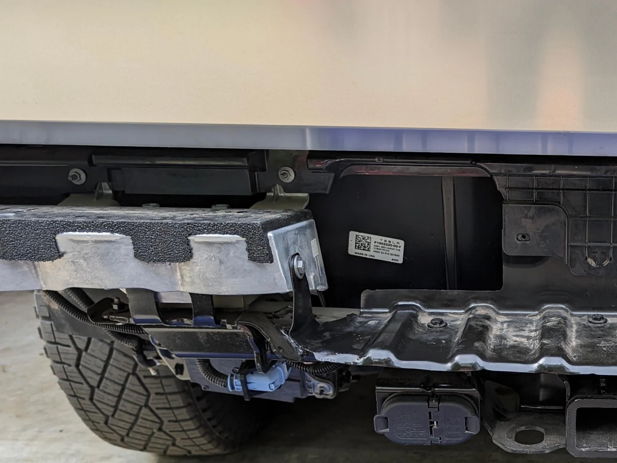

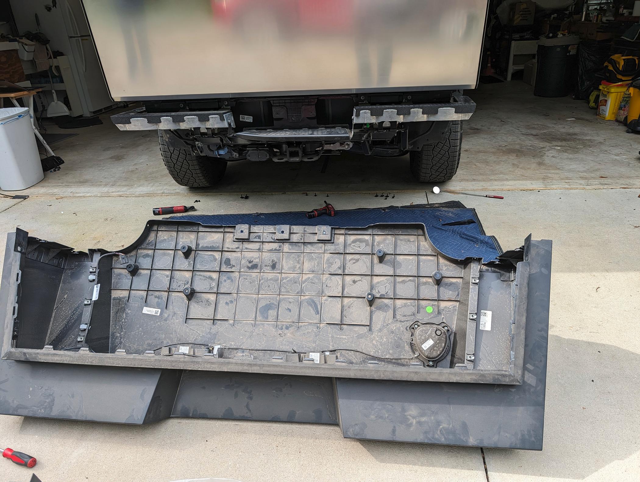

Removal of Fairing (note wiring harness and connected part)

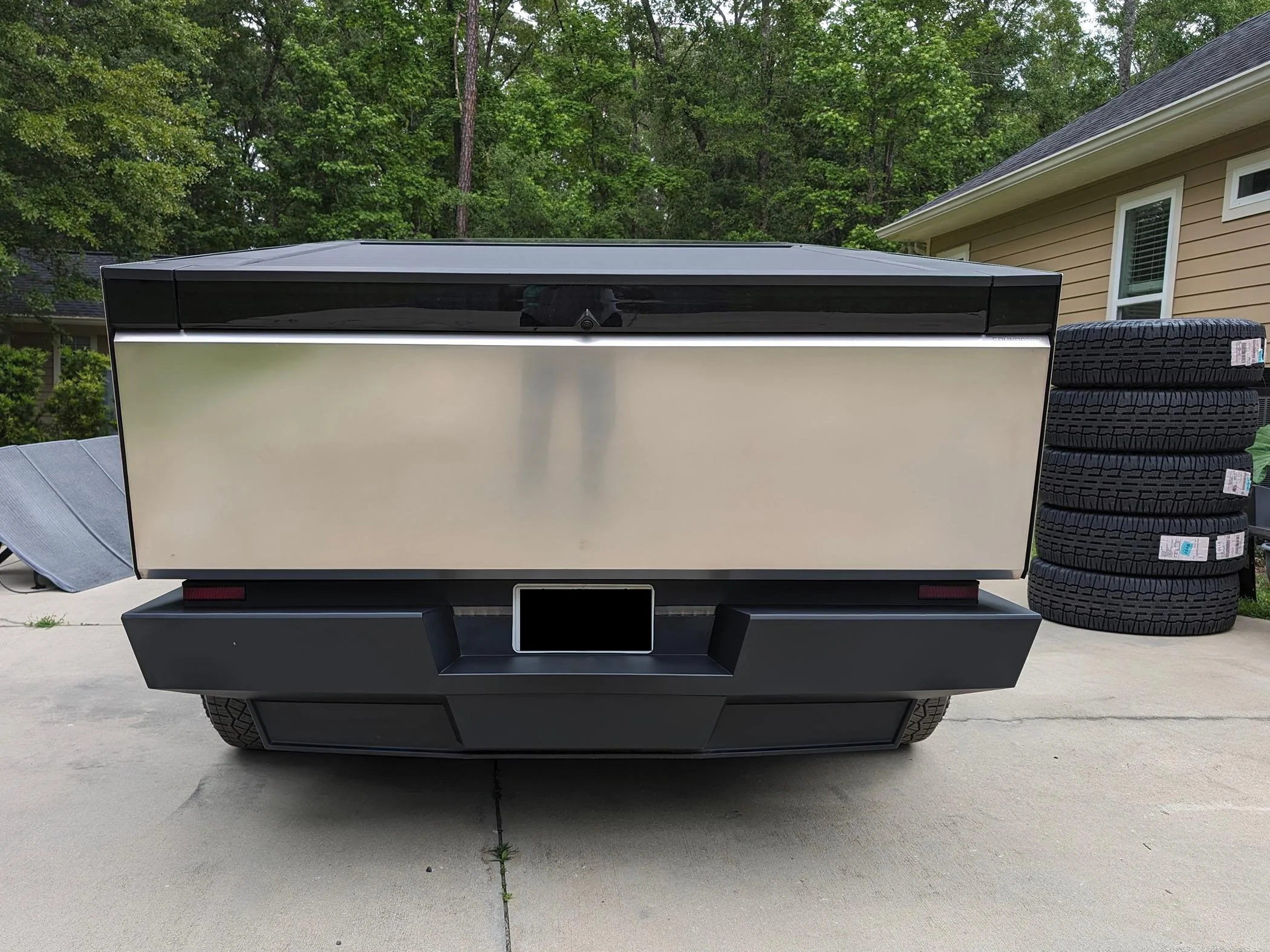

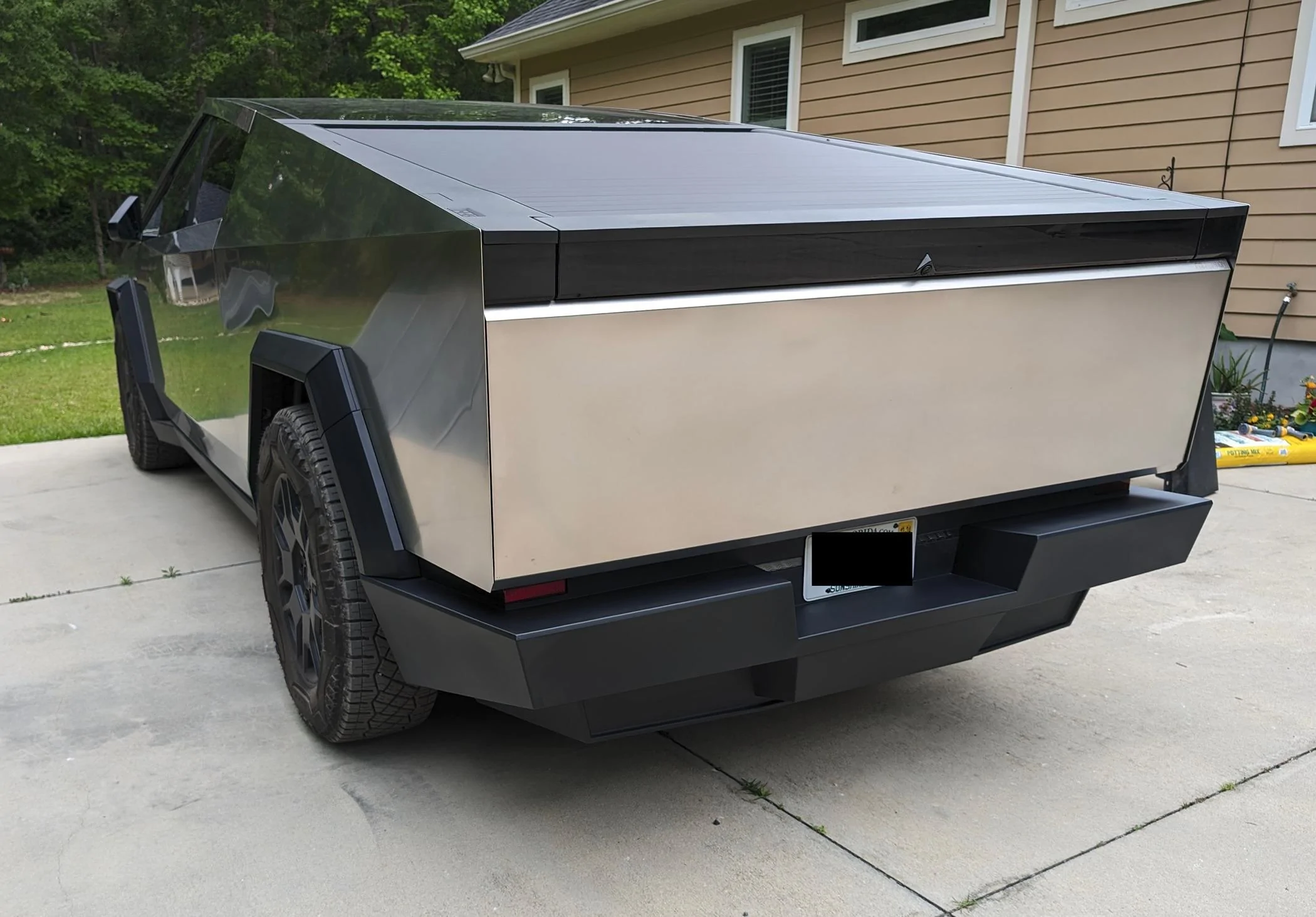

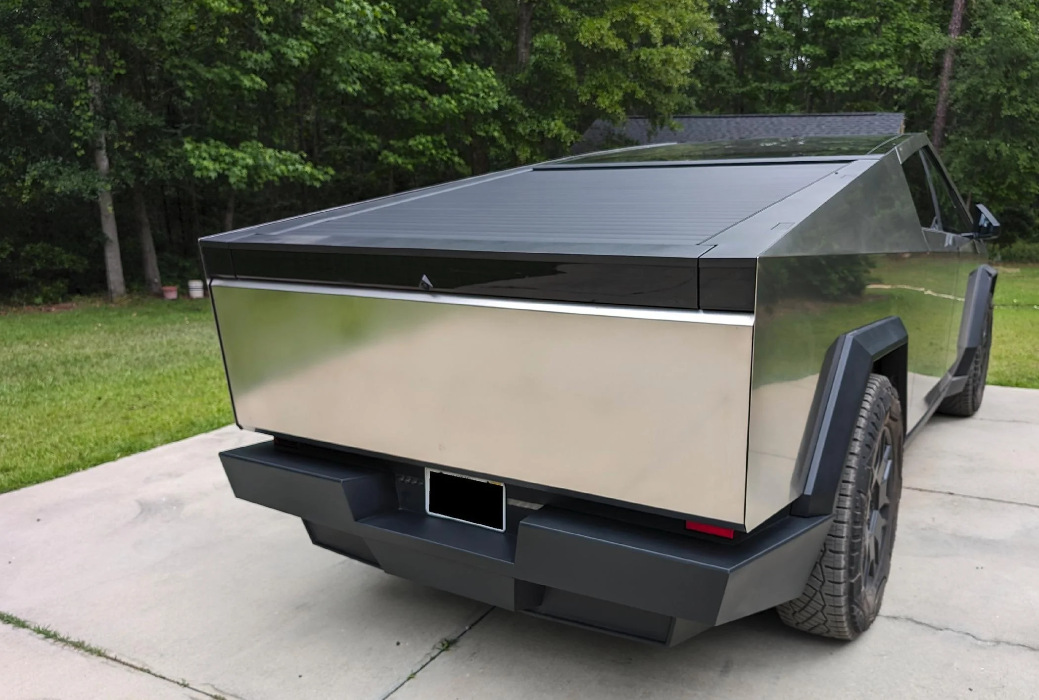

(Finished!)
(The Part)
(Damage to Step - Probably a cheap part but decided to fix rather than replace)

(Finished!)
