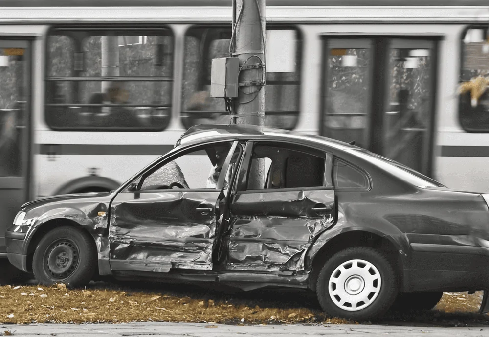

door are like fenders, vanity add on and keep out the weather and hold the window. Only thing protects you during a crash is the crossbeam. The whole point of sledge hammer to a normal door is to prove that very point. Indeed the trajectory of human intellect is falling off a cliff.
Doors contribute in a major way to protecting the occupants because they spread side-impact forces out more evenly to the frame of the passenger compartment. Crossbeams make the door stronger but the door itself would transfer considerable crash energy more evenly to the rest of the structure, even if they didn't have a crossbeam.

Doors are not vanity items.

Also, the high-strength steel crossbeams in most vehicle doors do not need to be impacted directly to be of great benefit. The crossbeam helps prevent the door from caving in when impacted, even if the main impact is above or below the crossbeam. Keep in mind that it's somewhat non-sensical to talk about a side impact that missed the door's crossbeam because the front of other vehicles are never shaped like a sharp wedge, at least not the structural parts of the front of the car. Will Cybertruck have a crossbeam inside its doors? It's probably not needed but we don't know yet. It could have a cross member in there if testing shows it to be a benefit.
