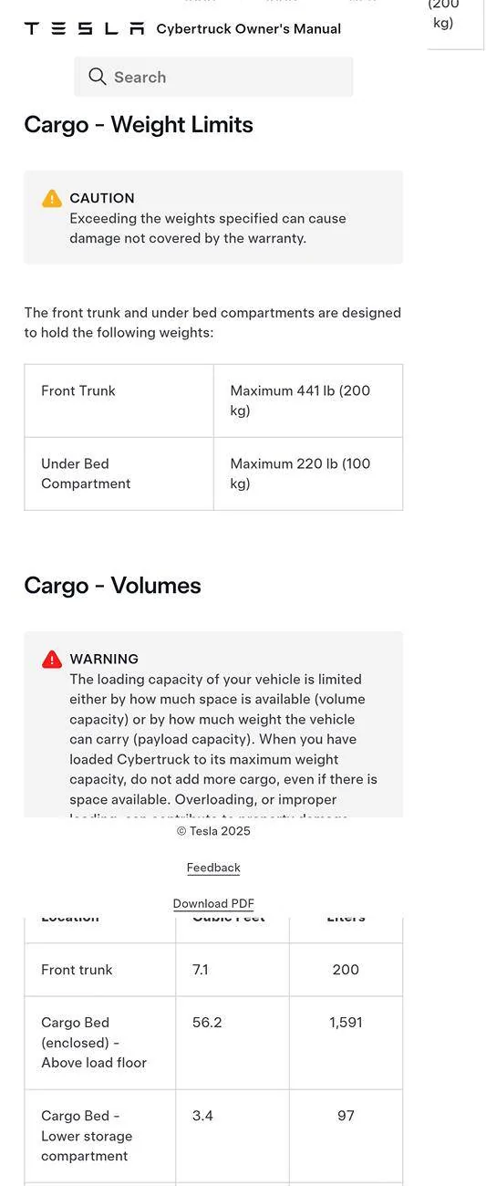

Hear me out...according to Teslas own owners manual, the bed's lower storage compartment has the total of 97 liters of area, and a maximum weight capacity of 220lbs.

With that said, the current 4680 Tesla battery: "has dimensions of 46mm in diameter and 80mm in height. This translates to approximately 0.133 liters in volume." So with those numbers, in a direct transaction, equal a total space able to fit 729.32 batteries!
Now, of course that doesn't include fittings in spacing, cooling, and all the fun tech that goes into a battery pack...
So lets talk about weight. A single 4680 battery weighs 355 grams (0.78 pounds). So with that number (and the previous mentioned total capacity of 220lbs), the lower storage compartment could only support 282.05 batteries ? (plus all the weight of that battery pack stuff)
So... CONSERVATIVELY, we are somewhere between 200-600 additional batteries that could fit in the lower storage compartment. This would likely need to remove the current plastic container, and replace it with a reenforced structure to hold a battery compartment.
What that would mean for extra battery??
A single 4680 Tesla battery has a capacity of 5,500mAh...meaning 200-600 additional batteries could mean:
1. 200 batteries: 1,100,000mAh
kWh = (1,100,000 × 3.7) ÷ 1,000,000 = 4.07kWh
2. 600 batteries: 3,300,000mAh
kWh = (3,300,000 × 3.7) ÷ 1,000,000 = 12.21kWh!!
***"Documents submitted to the EPA by Tesla reveal that the AWD and Cyberbeast trims of the Cybertruck use a battery pack with a capacity of approximately 122.4 kW"
That means we could have a battery pack increase in capacity of roughly 3.3-9.9% increase.
Does that mean an increase in range of 3.3-9.9% (roughly 10-30 miles)??? Likely not, due to increased in weight, but who knows?? Please investigate Tesla and aftermarket vendors!!! Tesla has already does the work on making it possible to direct connect and additional battery pack "extender" and I for one would love to see some options in using this space!
