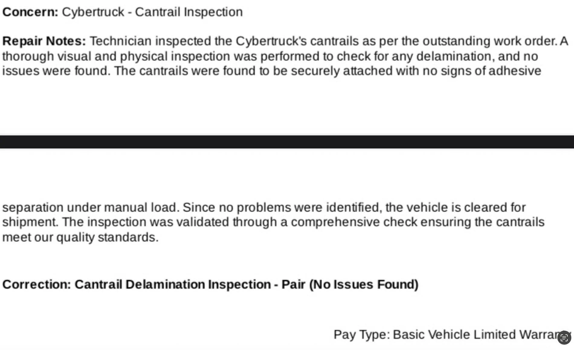

hmm... As part of the other service, couple of days ago, my service center inspected the and found that they are sturdy and hence they are not replacing it. May be in future ask them to fix it.
Tesla Cybertruck Recall: exterior trim / body panel detaching issue (46,096 Cybertrucks affected) 1742668712244-gq
