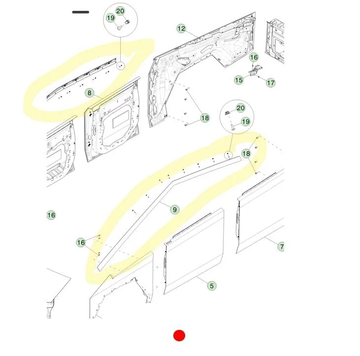

So what has been falling off the CT? Seems to be a failing of a glue system, and some news reports say that stainless panels have fallen off. Surely the large sheets of stainless are not just attached with glue? It is a long way to the Dealer, and I don't want to do that if there is no actual problem developing.
These pieces:

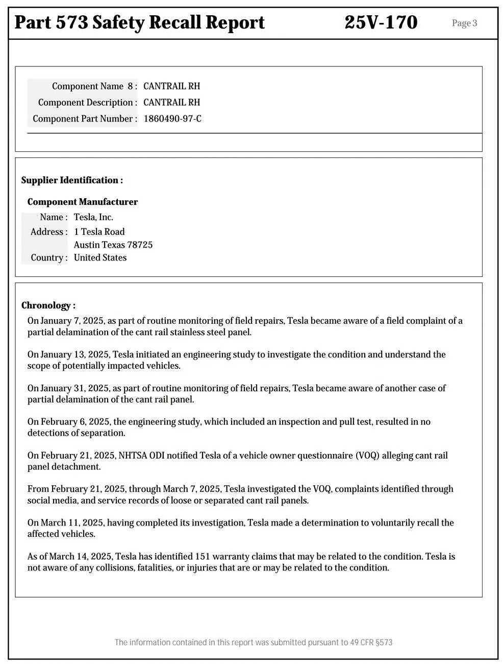

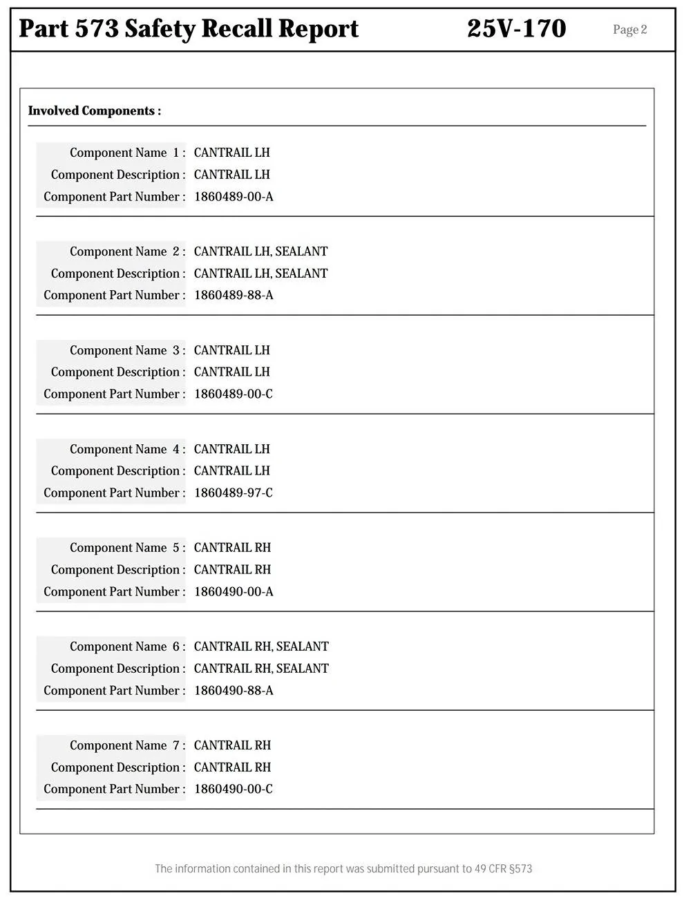

Update: Here's the official recall notice:
https://static.nhtsa.gov/odi/rcl/2025/RCLRPT-25V170-9407.PDF

Newsmax just reported that Tesla is going to be ready recalling over 46k cybertrucks..
Tesla to Recall Over 46,000 Cybertrucks Over Exterior Panel Issue
March 20, 2025
Tesla said on Thursday it is recalling 46,096 Cybertruck vehicles in the U.S. over an exterior panel that can detach while driving, after more than six call-backs for the pickups last year.
Tesla is recalling the vehicles over issues of the cant rail — a stainless-steel exterior trim panel — delaminating and detaching from the vehicle, it said.
As a remedy, Tesla service will replace the rail assembly free of charge.
