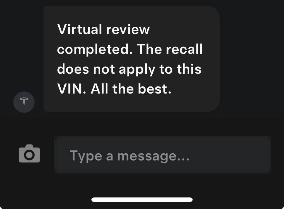

Not sure this is accurate. My VIN is not part of recall and confirmed with Tesla Service center. Not sure if they messed up or not all Cybertrucks produced are affected
Same here. VIN 51XXX. Received delivery in Nov 2024. Tesla just said recall doesn’t apply to my VIN, but https://www.nhtsa.gov/recalls shows recall is applicable. I asked Tesla rep to confirm whether the issue is fixed in my vehicle. Probably it’s fixed as the VIN is above 50K ?‍♂.
Tesla Cybertruck Recall: exterior trim / body panel detaching issue (46,096 Cybertrucks affected) IMG_2899
May 27, 2024
4,646
5,652
Not fixed. Tesla skips VINs. Database probably needs updating.
