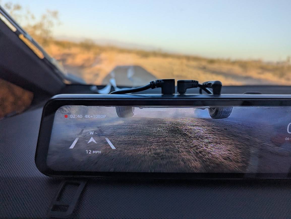

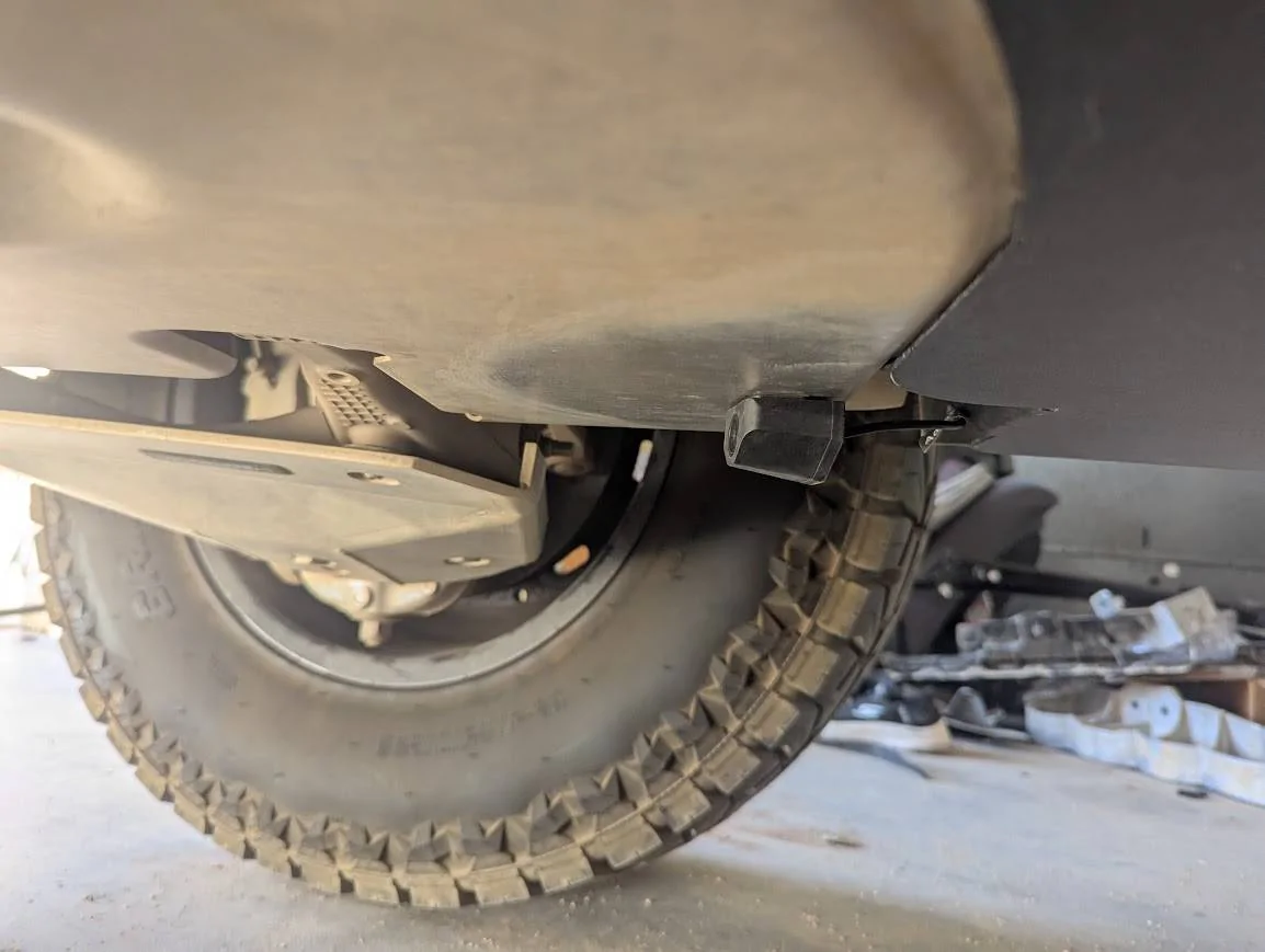

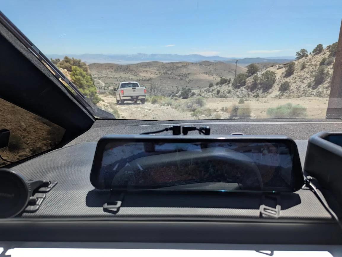

I went ahead and installed the Wolfbox G900 in a bit of a unique way since I didn't really need a second reverse camera or a second dash cam. But to their credit, the Wolfbox cameras are MUCH higher resolution than the built-in cameras on the CT that are designed for FSD use. Instead, I set up the 1080p camera on the undercarriage and I still haven't decided where to put the 4k camera, but I'm excited to find a perfect spot.
After installing it as intended on the rear view mirror, I decided that I preferred it on the dash. This is a personal choice since I find that blocking my view of the dash is better than blocking my view of the road--I've come to really like not having a rearview mirror, I guess.
I installed the monitor on the dash using two magnetic phone mounts. I powered it using an existing 120v->12v converter that I already had installed for my ham radio that is powered on the AC outlet from the center console in the back. I prefer this approach because it's really easy to run wires in the CT, the G900 came with a 12v connection, and I prefer the way the 120vAC system turns on automatically on vehicle entrance (as opposed to the 48v system).

Frankly, the G900 system is great. It did everything and more that I expected of it. Latency is damn near perfect and the image is crystal clear. I really tested this bad boy. I was in the boonies of the St. George desert, Death Valley, and the mountains around Cedar City. Exterior temperatures got to 110F/43C, and the main screen got MUCH hotter than this being on the dash in the direct sun the entire time. No issues and ran perfectly. I really can't think of anything to complain about as it does what it advertises, does it well, and has no bugs that I've been able to find.
I did test both cameras and they worked great, but ultimately I stuck with the 1080p camera under the CT--for now! Looking for creative ideas for the 4k camera that doesn't cover what the vehicle's built-in cameras already cover.
My subjective, personal overall score for this product is a 9/10. I only removed a point because I had to come up with a creative way to adapt it to the CT--dash mount, 120vAC->12vDC converter, etc. However, that may be a little unfair of me since pretty much all products need a little bit of creative adaptations to work on the CT.

Sure, to each their own! But being able to see under the truck is a newer feature in most off-road/overland rigs including the Hummer EV, Canyon AT4X, Tundra, etc.
As to rock crawling usefulness: being able to see under the vehicle is very useful in many situations, certainly including rock crawling. I personally don't do much rock crawling, but what I do use it for regularly is knowing tire placement for extremely deep ruts and jagged sidewall dangers--especially medial tire sidewall threats. This is particularly relevant on a vehicle with rear wheel steering.
On this one extended weekend trip I would estimate that I relied on it heavily to see where my back tires were located and how they were turning on at least 10 occasions.

So do you have the camera on the undercarriage pointing backwards? Is that how you can see the rear wheels?

Interested in the dash mount setup. Still struggling for a secure mount for the Hansshow mirror. I thought about using 2 clip in phone mounts as I don't think I want to use double sided tape on the back of the screen...
This is correct! No issues with debris or anything knocking it off, yet. I was concerned, but the glue is quite good.
