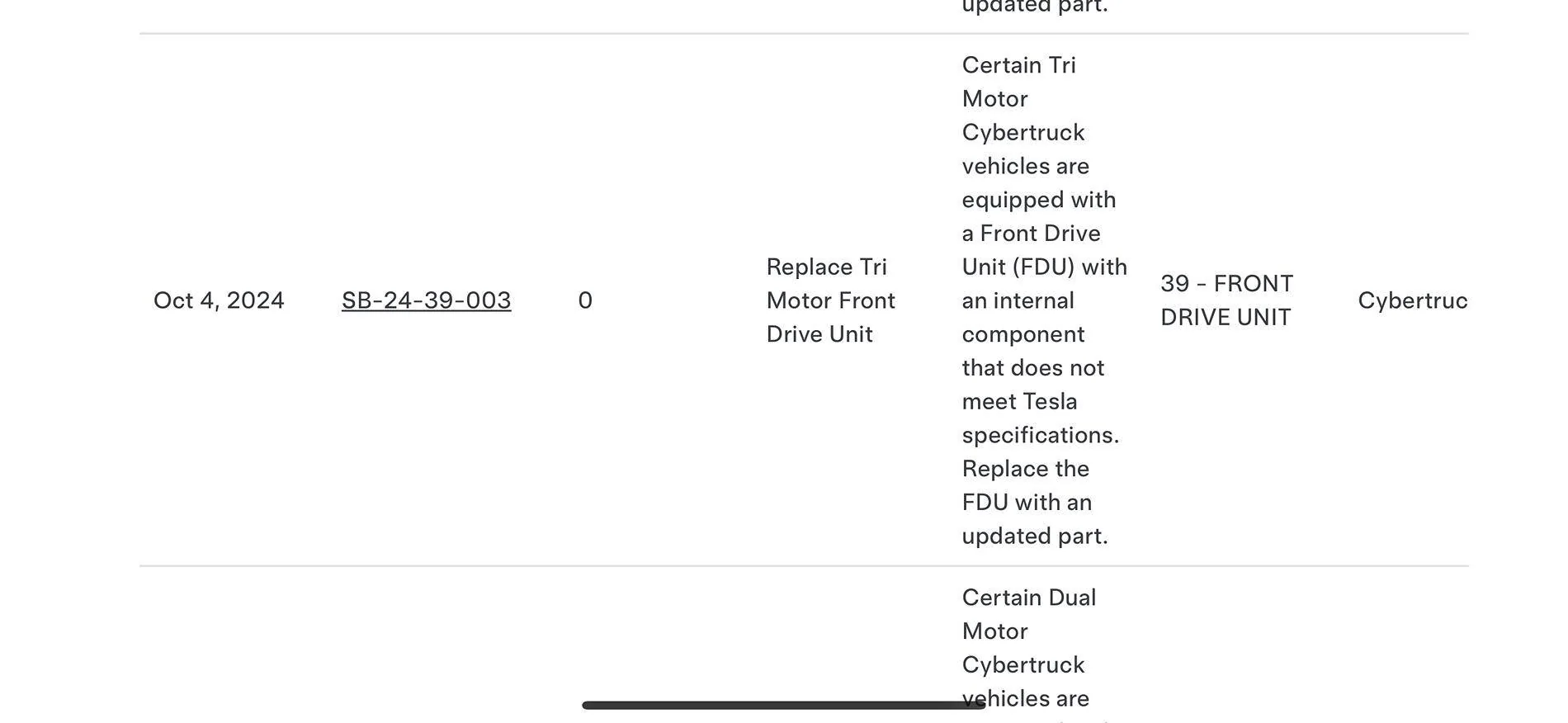

This is the most interesting diagnosis I've heard. Some saying it stops when the front is replaced but others it hasn't and then both are replaced.
How did you come up with the permanent magnet?
Tesla Cybertruck Slight Regen Vibrate at 42-46 MPH IMG_5269
Tesla Cybertruck Slight Regen Vibrate at 42-46 MPH IMG_5268
By reading some threads here and reviewing the Tesla service documents. Just a conclusion that makes sense to me.
https://service.tesla.com/en-US/documents?modelCode=CT
For the Beast trim, replacing the front driving unit would fix two issues:
1. Speed limited at 114 mph (I believe this is the dual motor’s top speed; Beast should be higher)
2. Potentially fix the vibrating issue at high speeds and regen between 30-85 mph

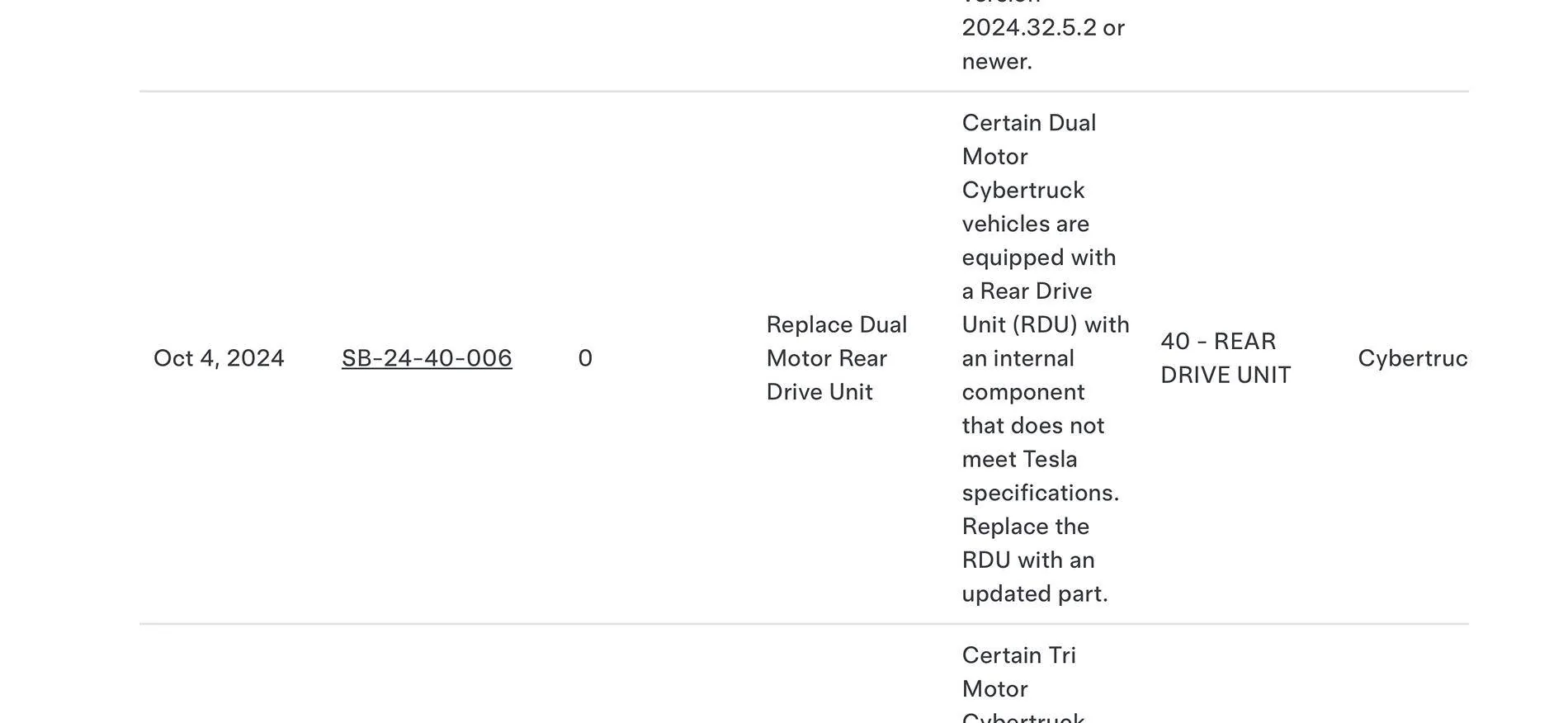

it was just the front motor assembly. So it could also be the half shafts, or it could be the rear motor. This might be inherent to half shafts, they may just vibrate when you hit exactly the right amount of force to where they stop pushing or pulling and are able to rattle back and forth rotationally. and being an EV, the way that regen works may make it more obvious than ice vehicles with similar suspension/driveline.
I'm only speculating, I don't really know, but I can see the way the splines mesh together on half shafts causing something like this

Interesting. I think Hello4x might be correct on the permanent magnet being the issue. Which means in the beast the front unit needs to be replaced but it's the rear in the AWD.
