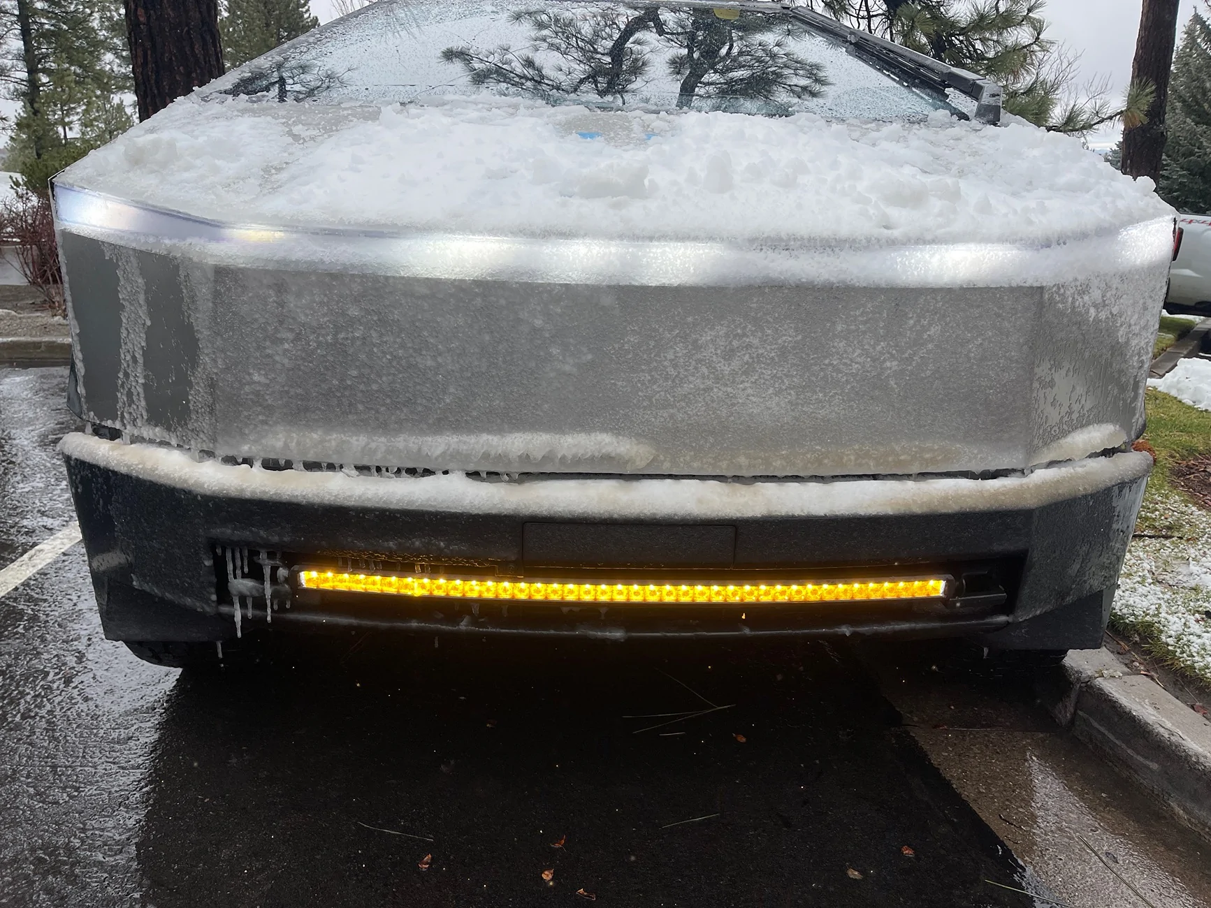

What is the light pattern like in front of you? And how likely is it that the LEDs will survive winter road bullets? I don't imagine it comes with a good cover for when not in use?
I’ll take some video this evening but it’s a wide dispersed flood. The lightbar angle is adjustable so we have it aimed in a way that gives the best increase immediately in front of the truck. I’ll be in some dark roads this evening so I’ll show you the difference.
I’ve never really had any difficulty with road bullets and their impact on lights but I’ve also never had a lightbar this low. I’m gonna guess it’s minimal but possible. They seem very well made and quite industrious but time will tell.
You can find a variety of covers like this but I decided not to go this route as we use the bar daily while driving at night.

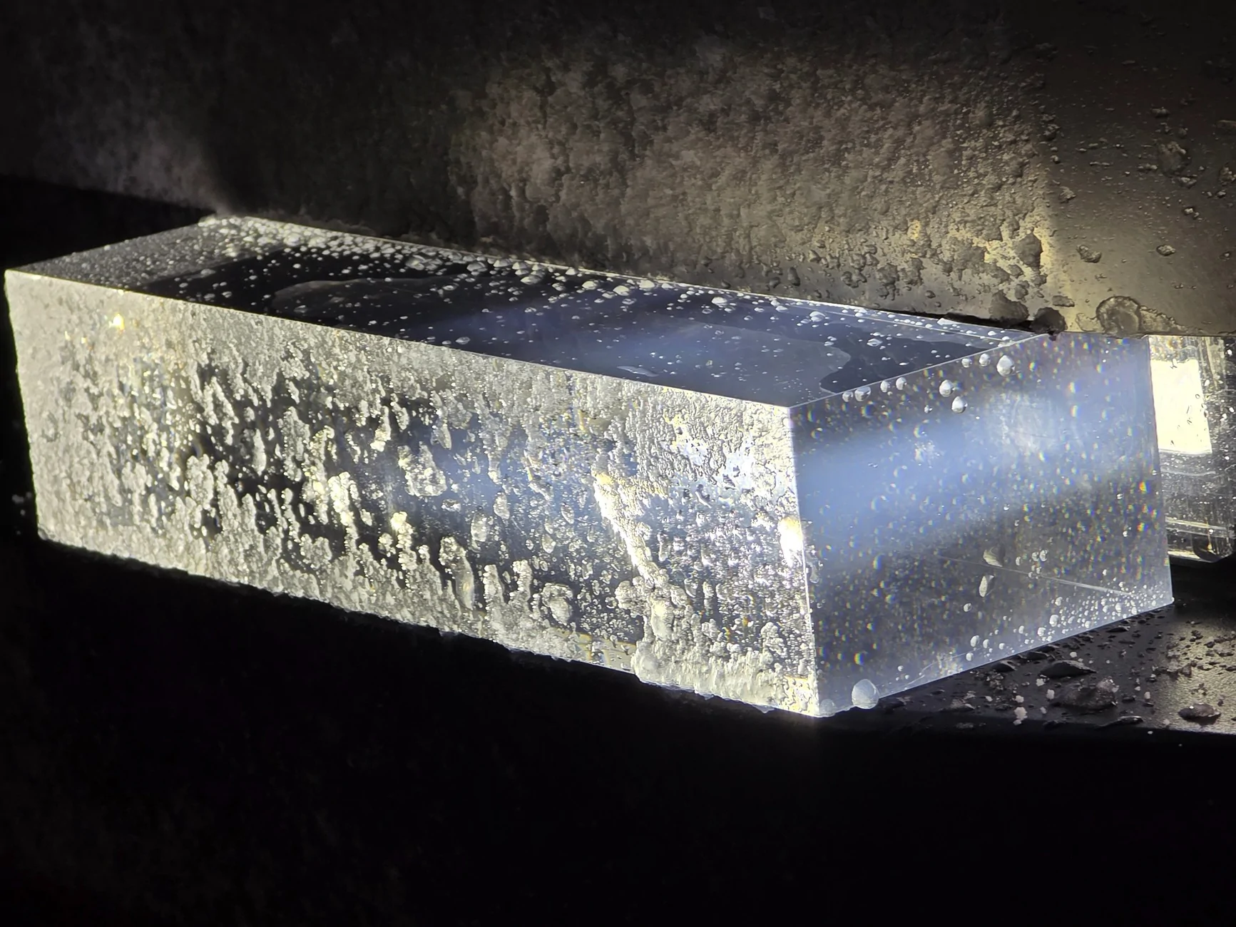

My initial tests went well, I'll finally get a really good test this weekend. Simple acrylic block in front of the headlights. Held in place by Frunk
Tesla Cybertruck Snow blocking headlights 20251214_055403
