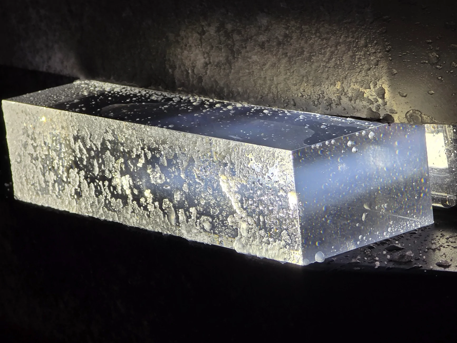

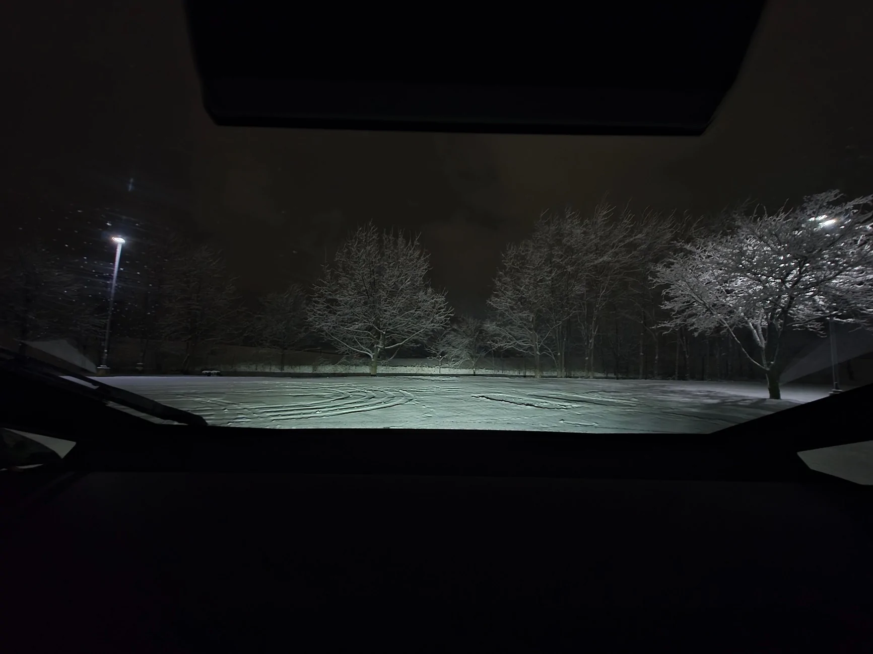

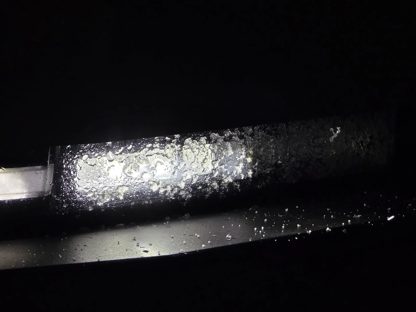

My of the shelf acrylic blocks came, and so far, so good. I got to drive in the snow this morning before sunrise, but not enough accumulated to block the unaltered light.
The mounting was incredibly easy, because the acrylic block is about a 16th of an inch taller than the gap, so the frunk lid actually provides a little compression when it closes on the block.
There is no noticeable prismatic, or other visible problem with the low or high beams going through the acrylic block.
As one member of The forum suggested, I put the block over one headlight and left the other one uncovered.
One picture shows the headlights, the acrylic block is mounted on the driver side.
The other picture show the uncovered Tesla headlight, and then the Tesla headlight covered by the acrylic block. You can see they both collected Frozen material at about the same rate.
Now I need to get out in a big enough storm, to see how they compare once snow really begins to build.
