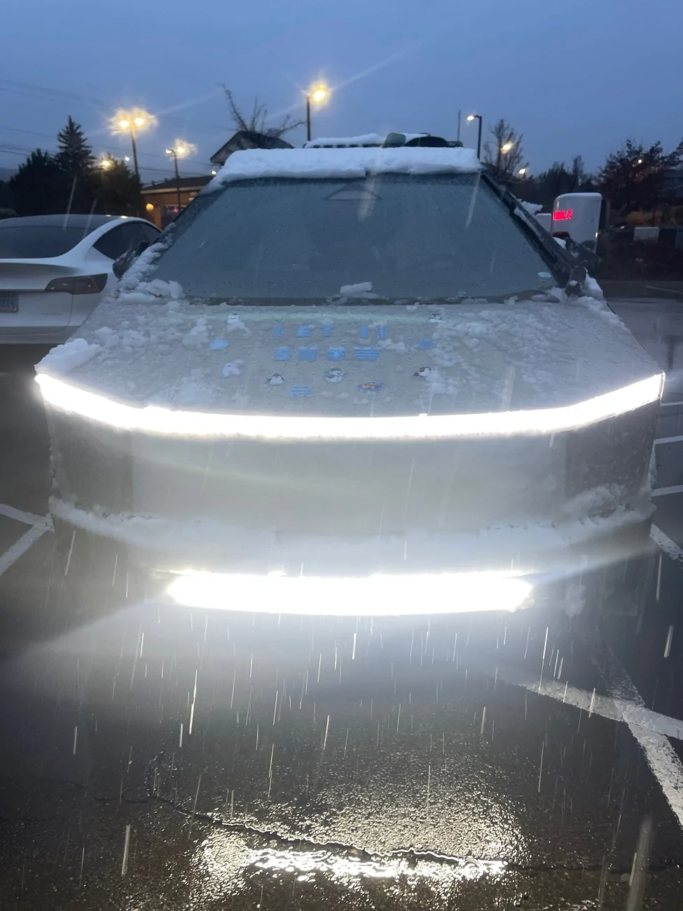

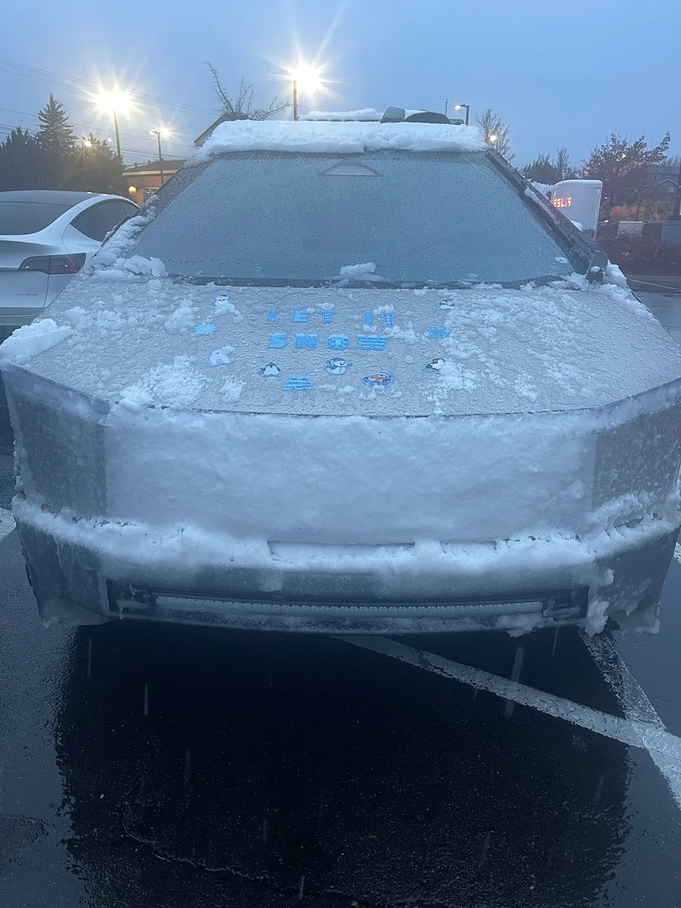

For a visual, here is what is being attempted to be solved. I decided to go with a bumper lightbar that I’ll be covering with an amber tint. This accumulation was during a 34 minute drive at 24 degrees, with snow falling at approximately 1.25”/hr.

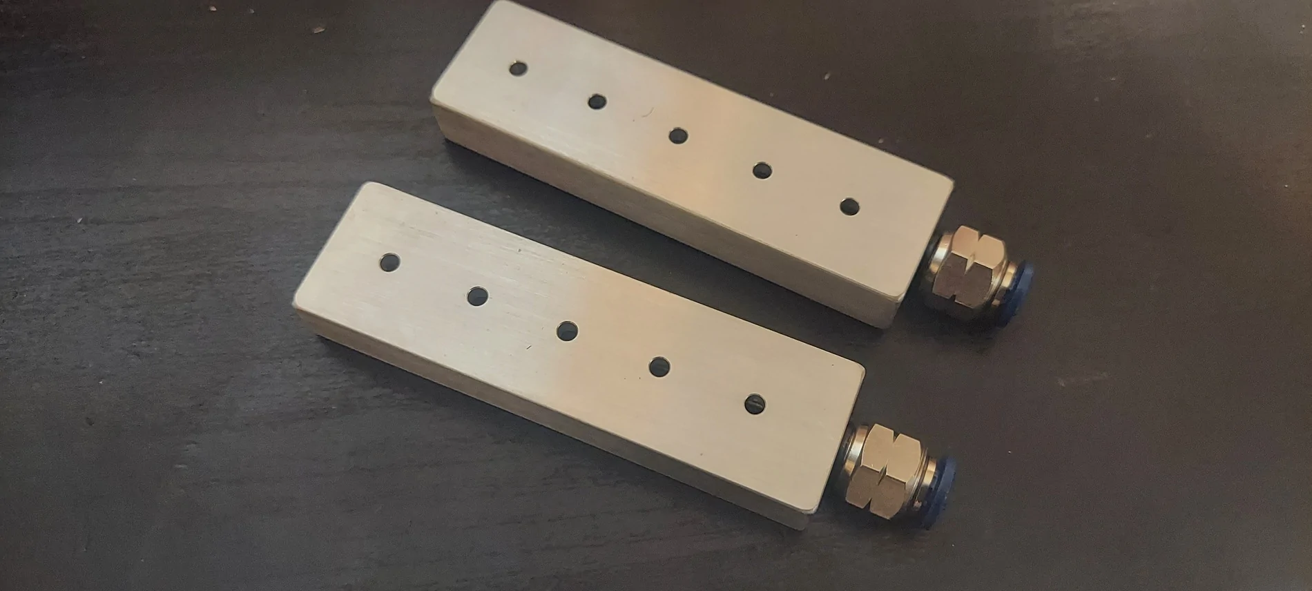

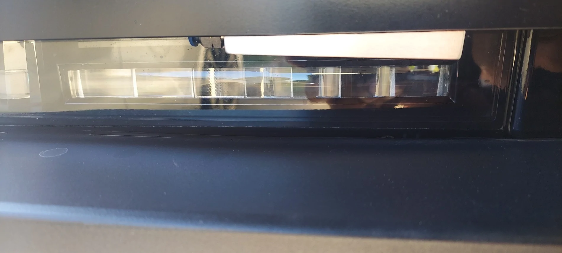

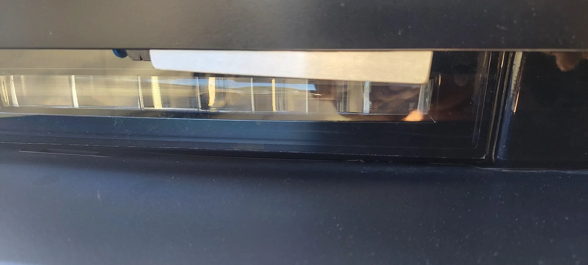

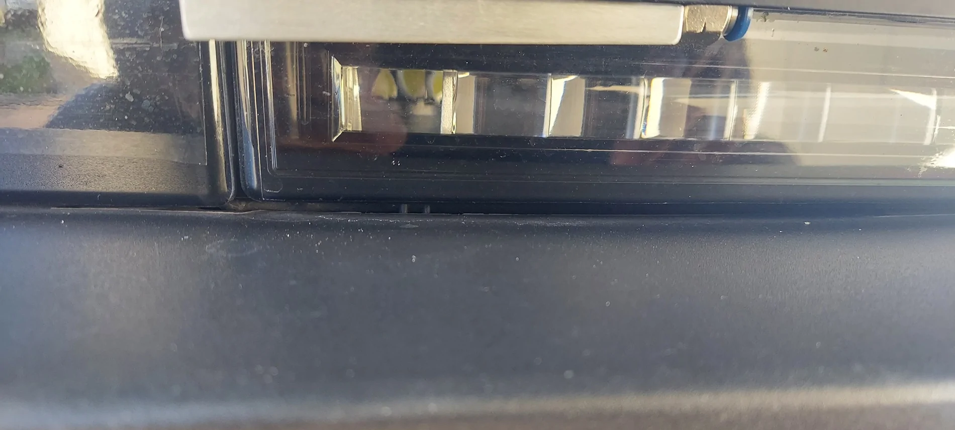

Those are my prototype nozzles. The length and size will change. The system will use 200 psi air to blow away the snow via a button inside the passenger compartment. It can be used while driving
Would love to see the final product.

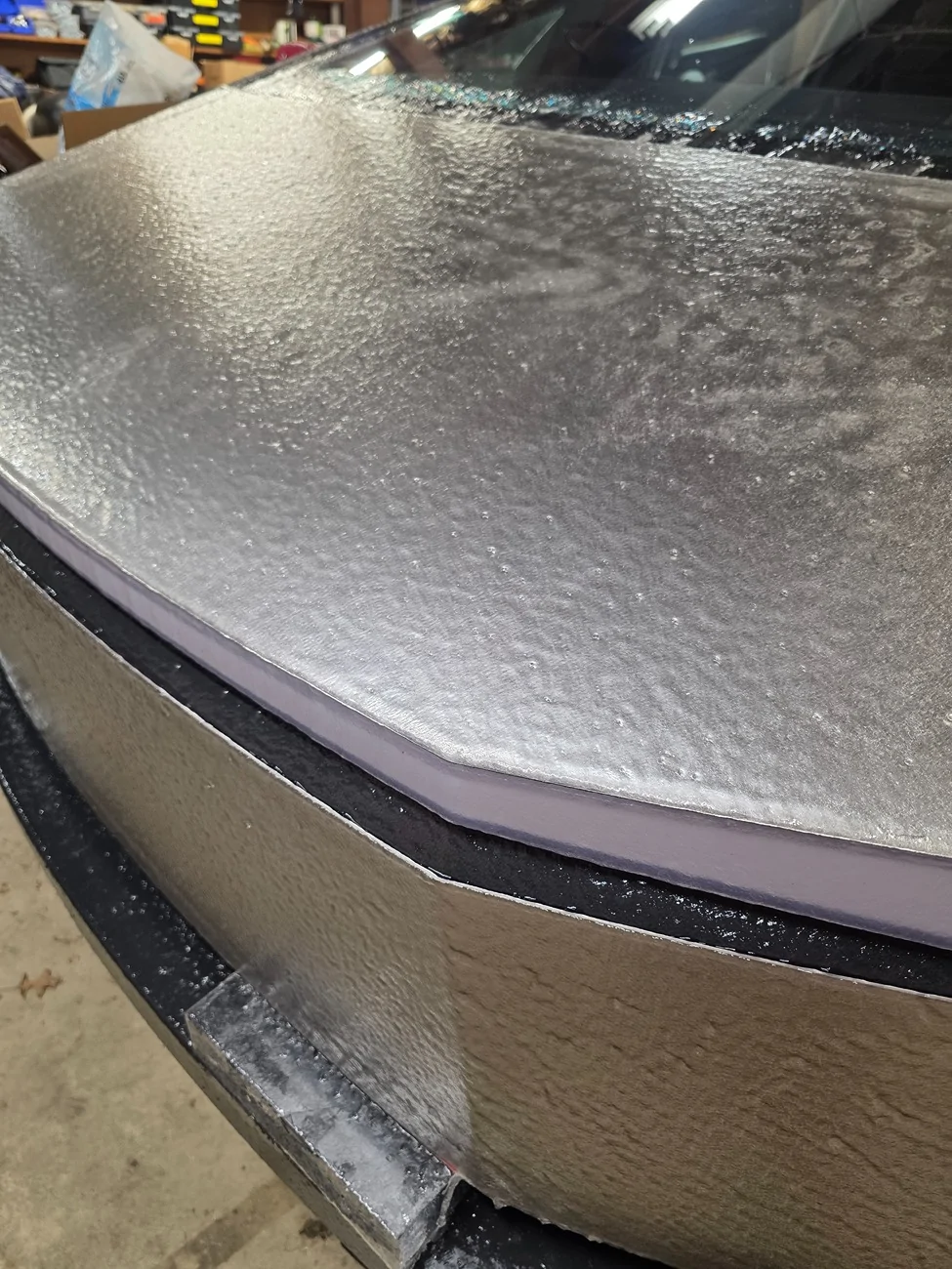

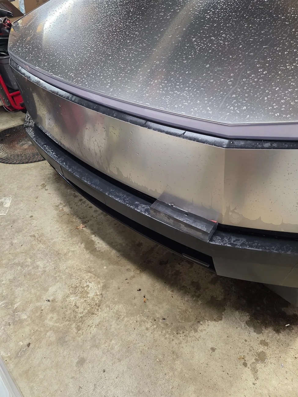

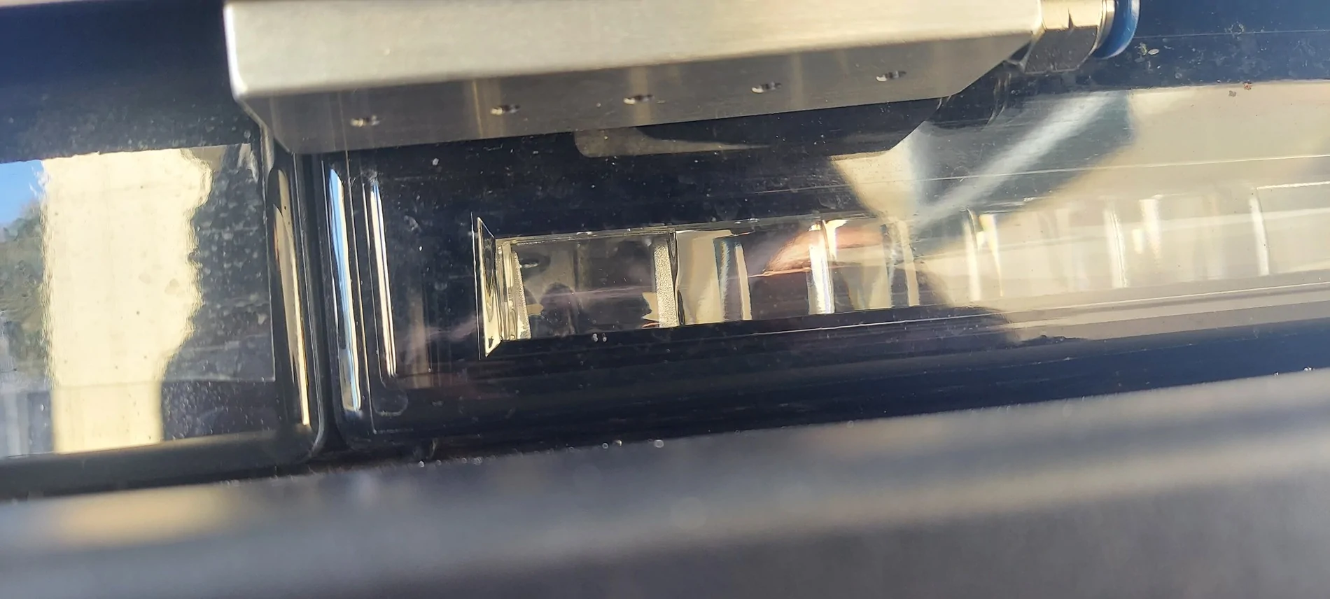

I got to drive again in a storm with the acrylic block in place, but didn't get enough accumulated for a true test - where the bumper fills up with snow. The block iced over, and did not continue to accumulate. Light was still ample though the thin layer of ice. I can't wait for some serious accumulation - feeling good about this fix, and looking forward to reporting back!

Based on my tests so far with the acrylic block - probably. I haven't tested tape because I'm looking for something even easier, and didn't want to tape on the truck. Tape is definitely be cheap and super accessible. If you have snow give it a try!

Based solely on my acrylic block test, this could work too, and probably wouldn't noticably alter the light beam. It somehow would need to keep snow from entering from the side of the shield/tape, which might happen naturally. If you can make one give it a try!
