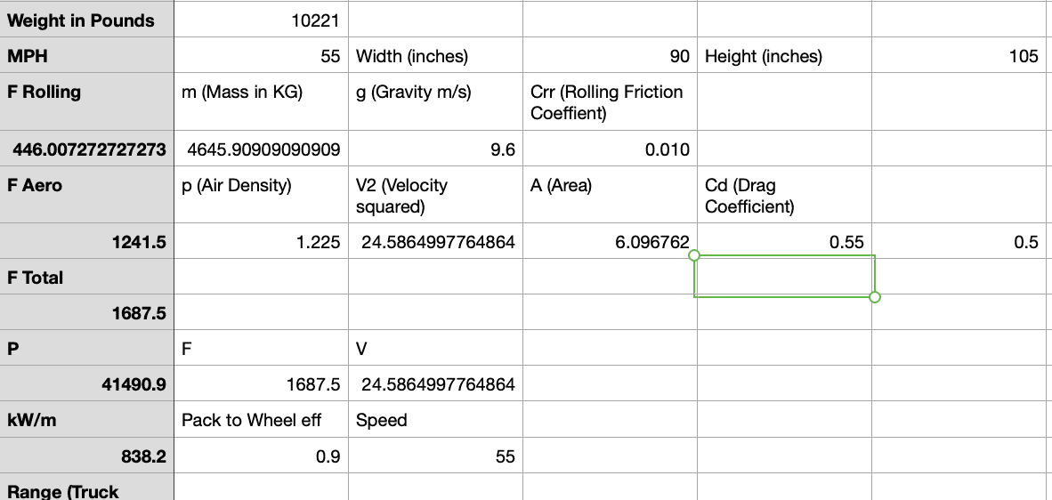

Are you saying your spreadsheet predicted that at 55mph the results would be:
335Wh/mi for Tesla Model X 5,421 lb (2,459 kg)
and
800Wh/mi for Tesla Model X LR+ 5,421 lb (2,459 kg) + Apex Nano 194bhs 22-ft 4,800lbs
Tesla Cybertruck SPECIAL EDITION QUAD-MOTOR Cybertruck rumor Screen Shot 2020-11-21 at 12.23.56 AM

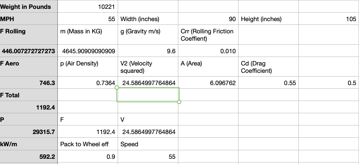

Here are the exact same calculations at 5,000 foot altitude. There is a 233Wh/mile difference from sea level. So you see, unless your references start listing altitude, temperature, headwind/tailwind component, the average grade of the drive, the type of tires, the material of the roadway, and whether or not they had the windows down or the heat pump/AC on, your numbers are completely and entirely worthless for determining the energy consumption when towing with an EV.
The spreadsheet gives a baseline, nothing more, nothing less.
In previous comments nobody mentioned altitude. What was repeatedly mentioned was steady speed 55 mph, no hills/no mountains. Why do you bring up altitude now. Assumption is sea level. Did you put in altitude 5,000 ft before?
We already mentioned grade (no hills / no mountains) so why now claim it is unknown.
When you did previous spreadsheet you said nothing about temp & wind. I assumed you would using a normal temp (70F) and no wind. So were you using different values?
In previous you made assumptions about tires & roadway. I said 55mph on highway. I assumed you where using reasonable assumptions about U.S. highways not a dirt road in middle of the Baja.
You made repeated assertions about Cybertruck tri-motor 500 mi towing 14,000 pounds would have much much less than 250 mi towing range. You told us your spreadsheet prediction of Cybertruck towing of 2,000 wh/mi was informative but now claim there are too many variables for you to match simple real world existing vehicles in pretty standard environments that thousands of people drive in every weekend during summer vacation season.
