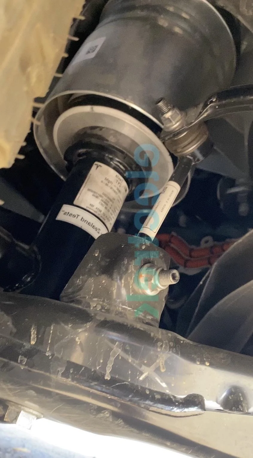

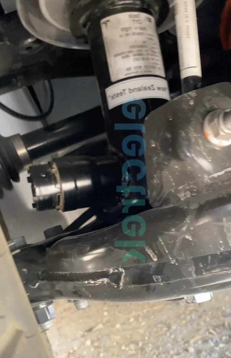

There's no space in the rear for vertical suspension riser between the bed wall and the wheel. From the rear suspension arms you can tell it's not a trailing arm design like the Lightning, which means you either need a vertical riser or a push rod setup. Plus you really need a double wish bone setup to get the rear steering knuckle for 4WS to work as they pointed out it has.
You can see the connection point of the swing arm on the lower rear wishbone, but I haven't seen what it connects to that acts as a spring.

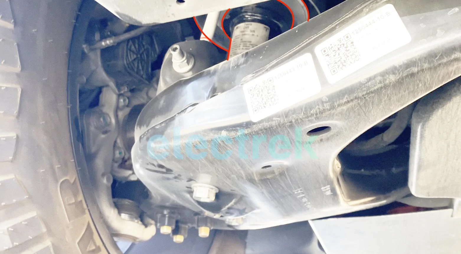

It's the rear. They mention that on the front they are using a cast lower control arm while stamped steel at the rear. You can see the air strut connect to the lower control arm here:
Your red circles are missing actual "air strut" parts on the left. This is just an arm, there is no visible spring there on that photo.
